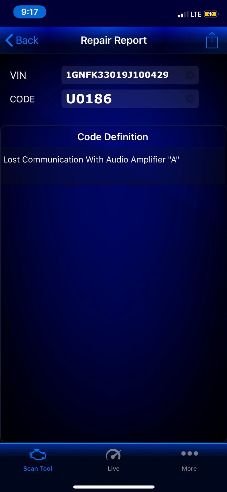

I think it's either the HU or the amp, and I'm leaning towards the amp, it's possible the 4 ohm speaker messed it up. Pops and such are often audio ic's on the way out. Whichever is easiest to swap out, that's what I'd start with.

Canned the Tahoe today and got this code. I’m guess it’s probably from when I unplugged the amp while trying to replace?
