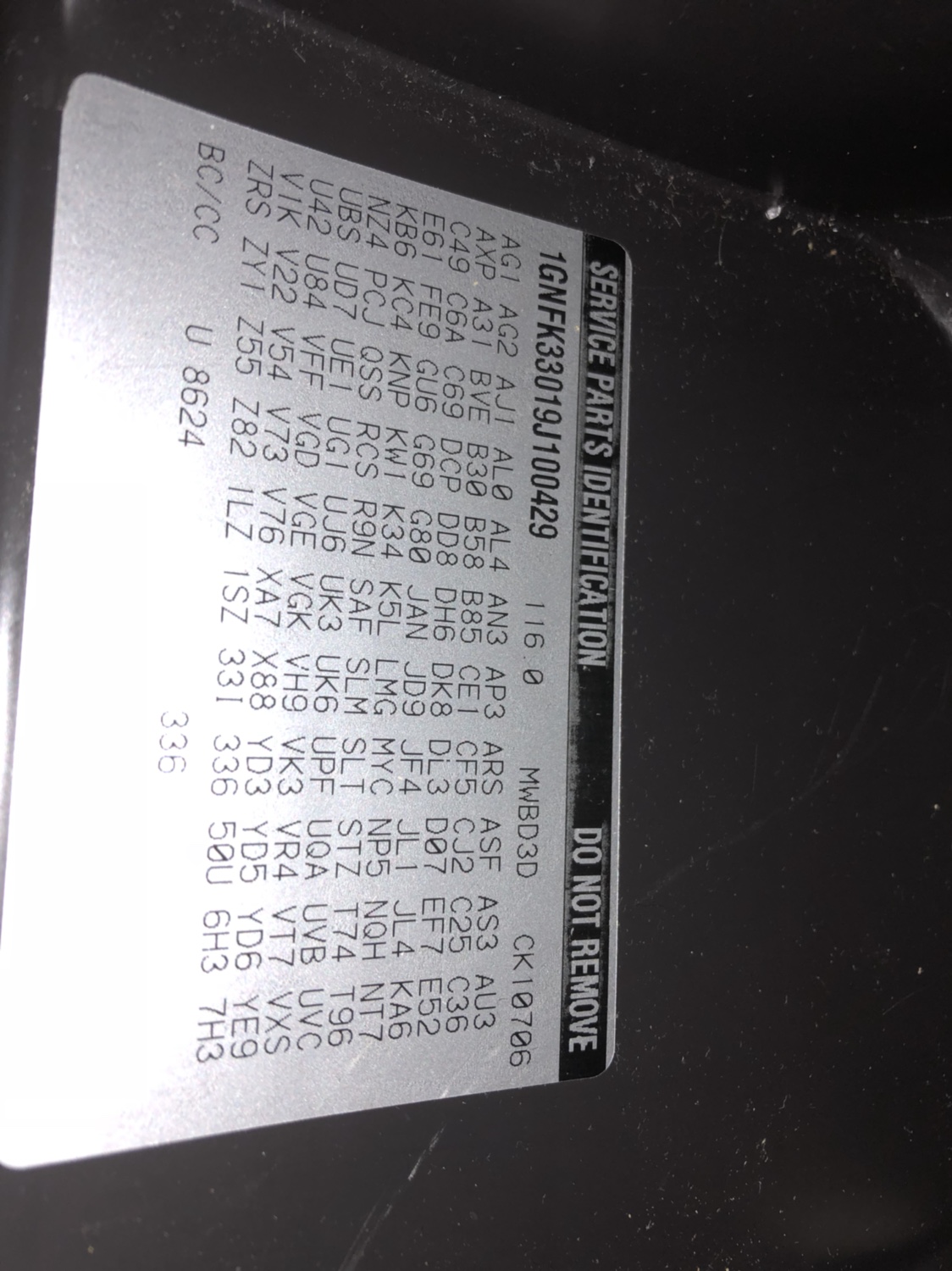

Ben, post up your RPO "U" and "Y" codes from the sheet in your glovebox. An LTZ should have the top of the line system or close to it.
The amp, if still there, is under the cup holders in the console.

I’m lost. Maybe you could elaborate for me.
Well, you're having problems with your radio. Some said it might be the amp. You have no amp. But originally, your truck came with one. So the radio system has been rewired and this modified wiring or the radio may be the source of your troubles.
Ok so unknowing to me the Previous owner had taken it out and converted it. So how does the factory sub work and all that stuff?
