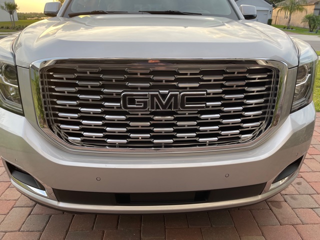

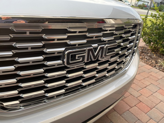

well I decided to go ahead and do the install after work took about an hour. The grille emblem is different for sure just need to see how to make this fit now. The SLE/SLT grille mounting area is flat vs. the one on the OEM Denali grille. I have the emblem on but it is not flush.

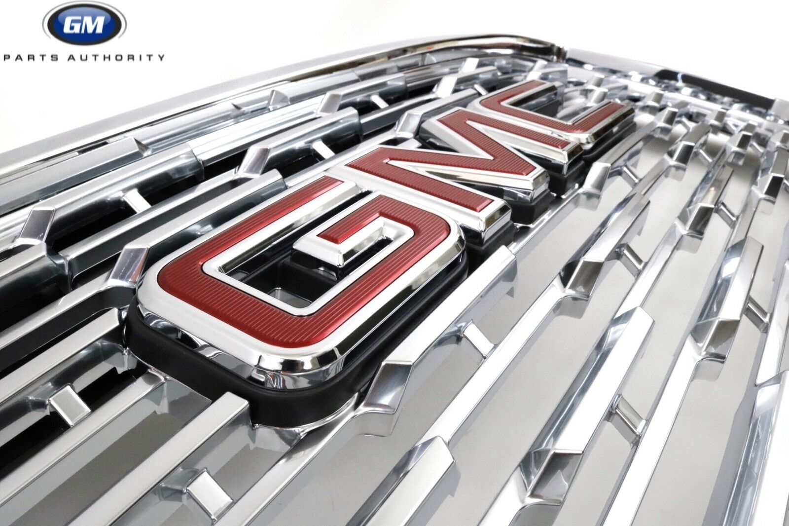

pretty sure I have found the issue the emblems are the same but the denali grille I have is missing the black plastic raised piece that goes in the grille area on the grille and the GMC emblem attaches to it. See attached photo of a OEM Denali grille I saw on Ebay you can see the black area under the emblem.. Mine did not come with that piece the owner kept the emblem w/ the black piece.

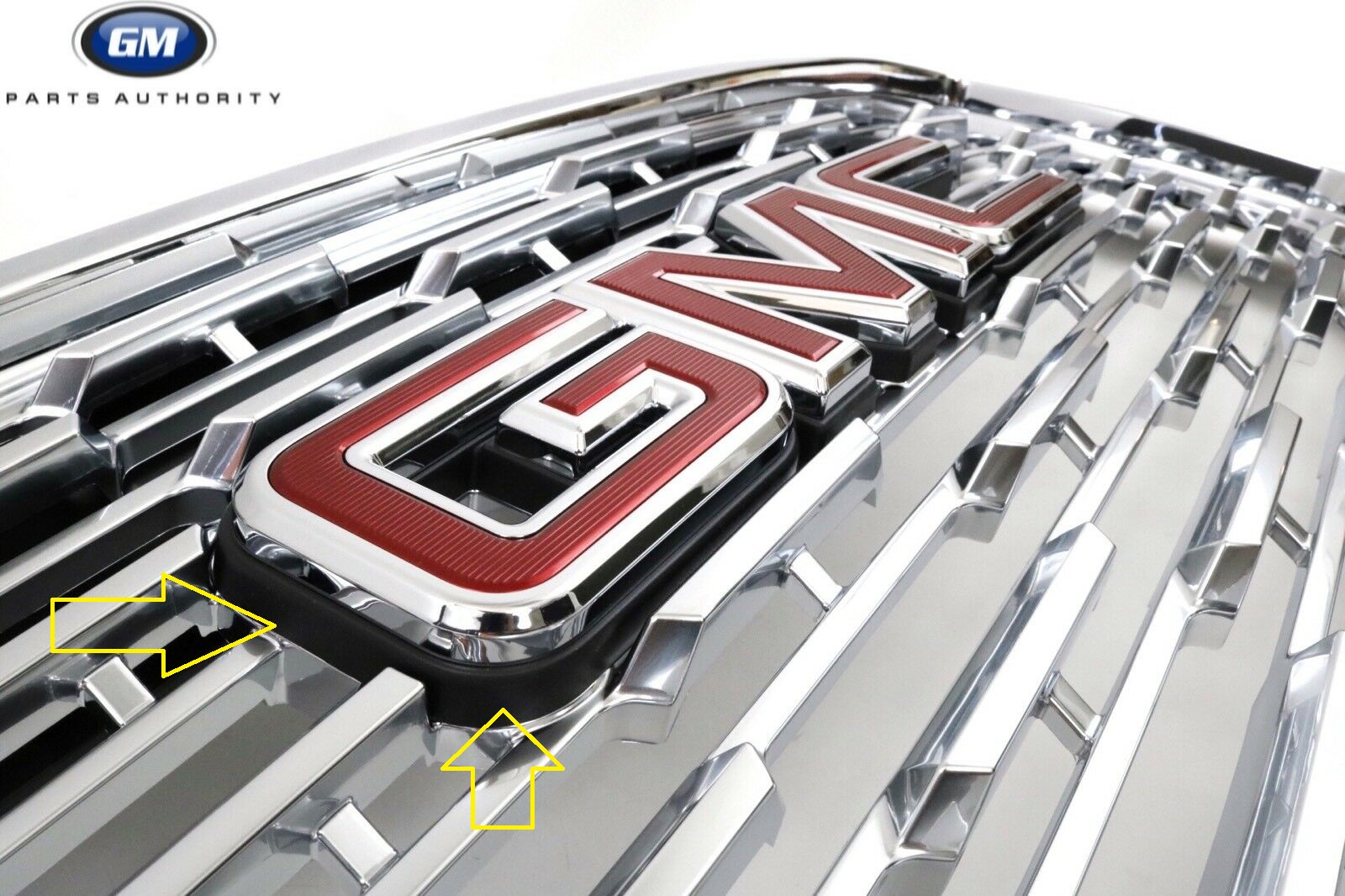

this is the back of the emblem it's the black mounting plate that I need that is missing. The Black mounting plate attaches to the grille and the emblem ataches to the mounting plate.
