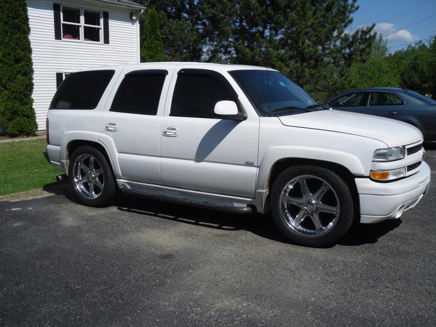

Hey guys I have an 03 tahoe and deleted my cats. Now I am getting codes 420 and 430 exhaust catalyst below threshhold, bank 1 and bank 2. Before I cut them out I was getting the 420 code for bank one. I was going to replace the o2 sensors but I don't want to if the free flow exhaust is just going to screw them up. Any ideas?
