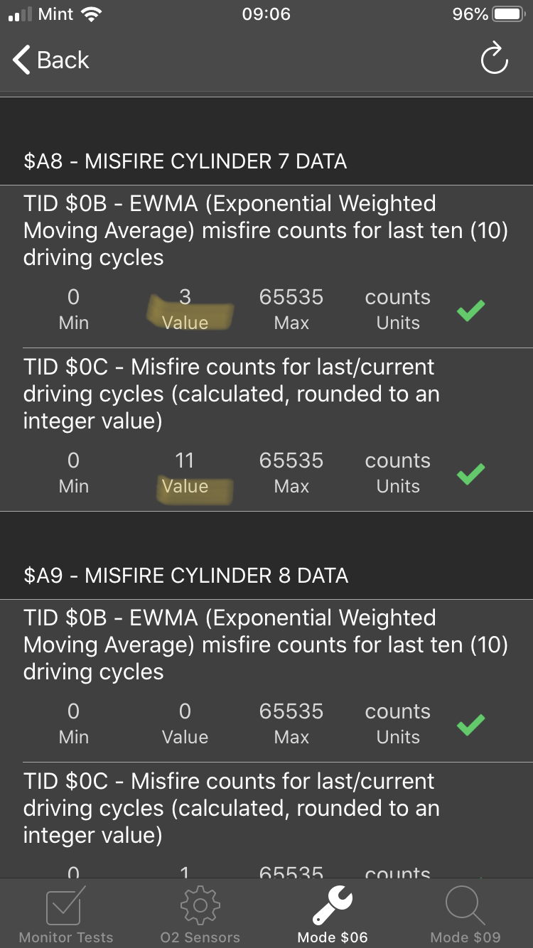

This is what I am seeing on another 7 min ride, looks like Bank 2 is not doing well Cyl #7 is consistently showing misfires

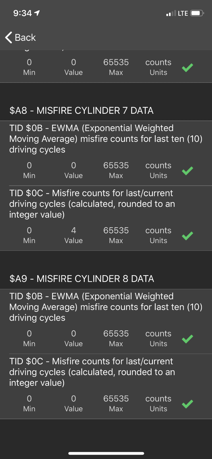

I had a few misfires on 3,5,7. 7 being the most but not as much as you. I pulled a full report. Trying to figure out how to get it to you. It’s an html file.

I stay corrected then. Misfires on the odd cylinders but out of spec measured even cylinders. Now, there is no logic in my finding at all then - bottomline: truck is still rough idling and now even in P both cold and warm.
Cylinder 7 is bank 1 not bank 2.
