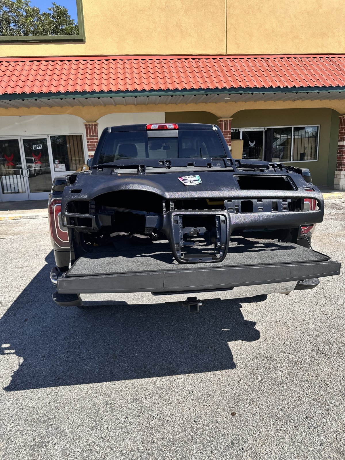

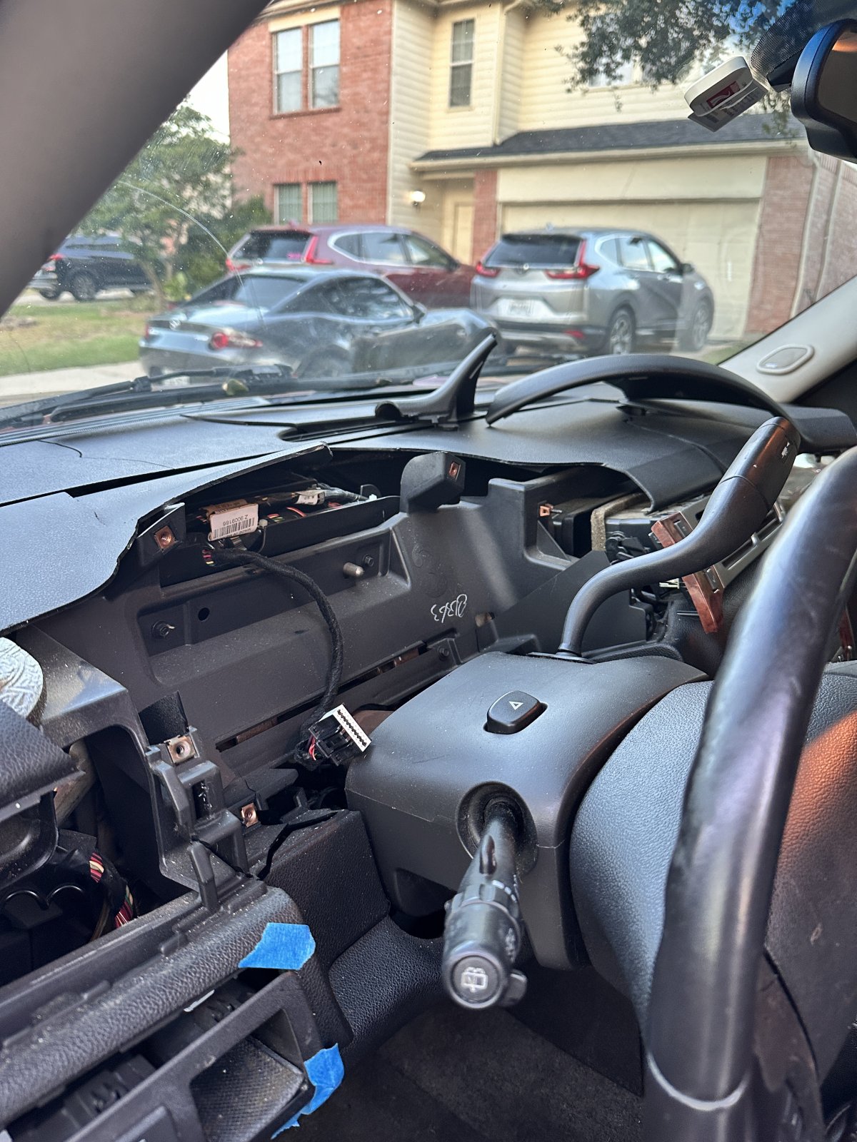

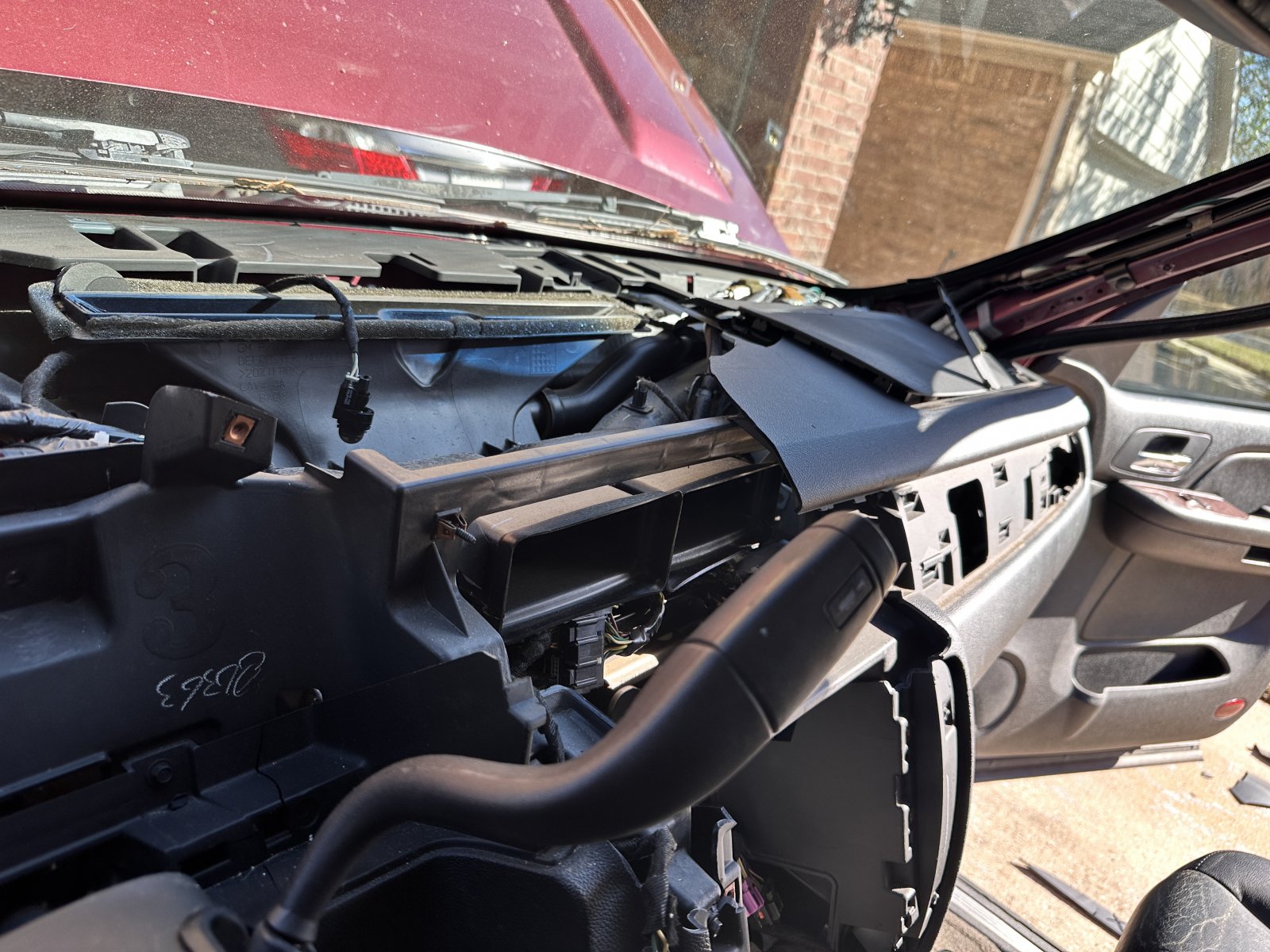

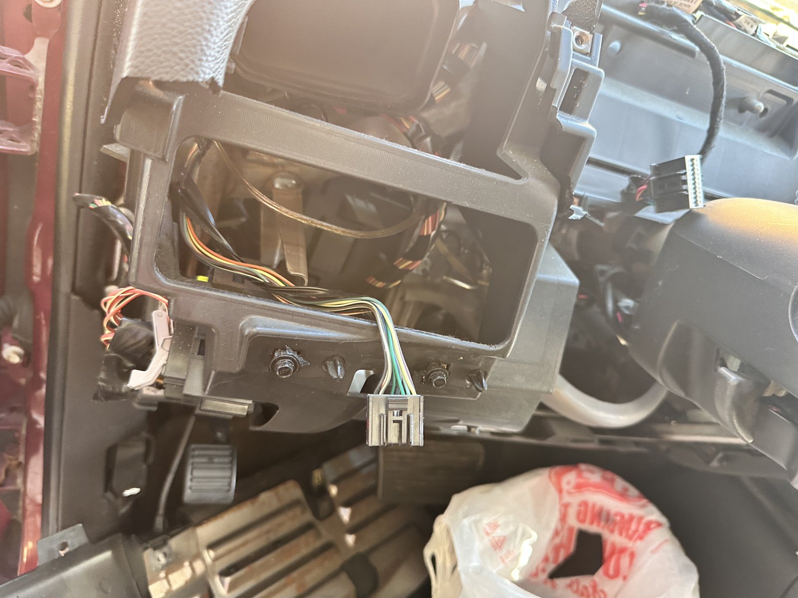

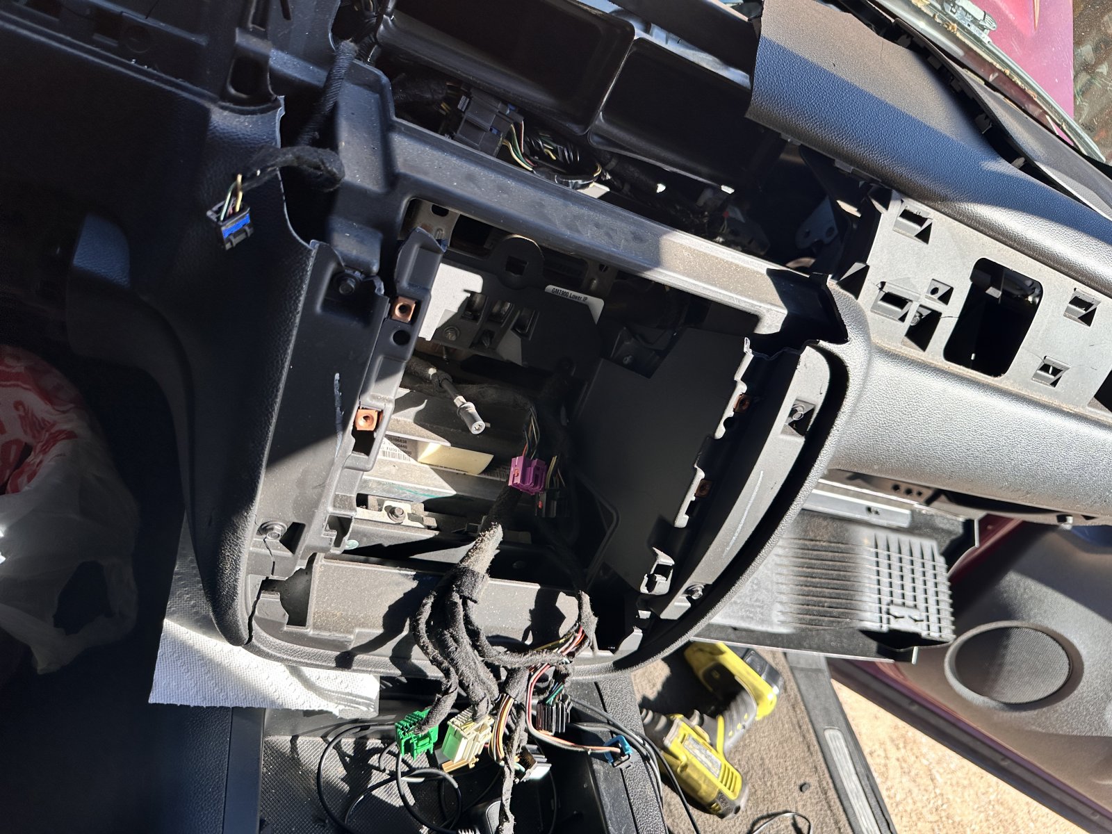

The next step was to remove the old dash. The dash literally fell apart as I pulled it apart as I removed all the screws. Everything looked pretty self explanatory as I pulled it out. The plastic was really brittle.

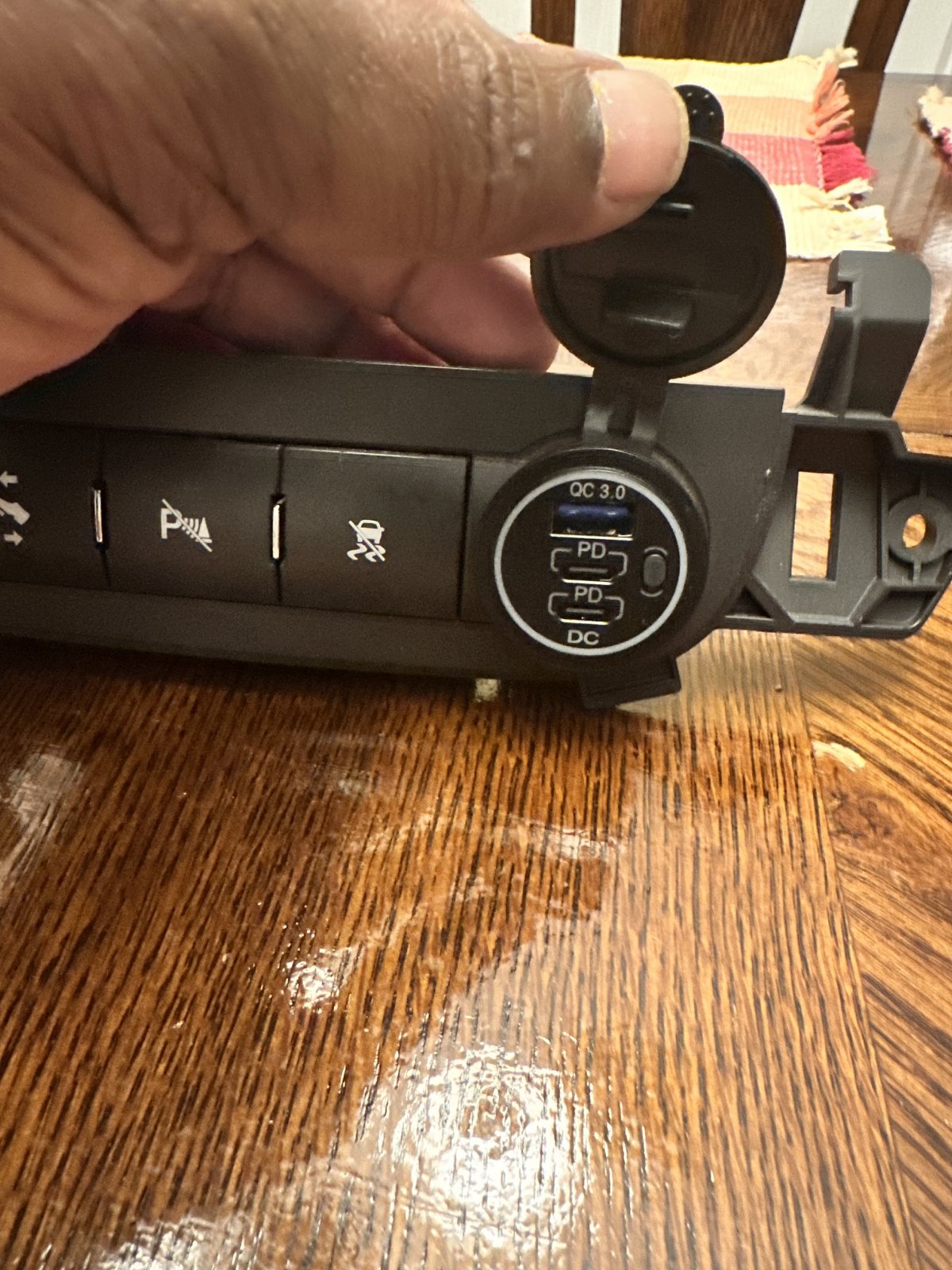

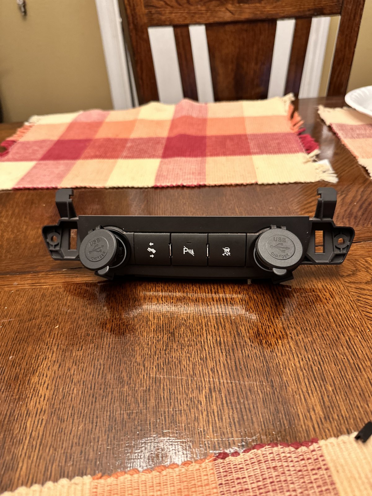

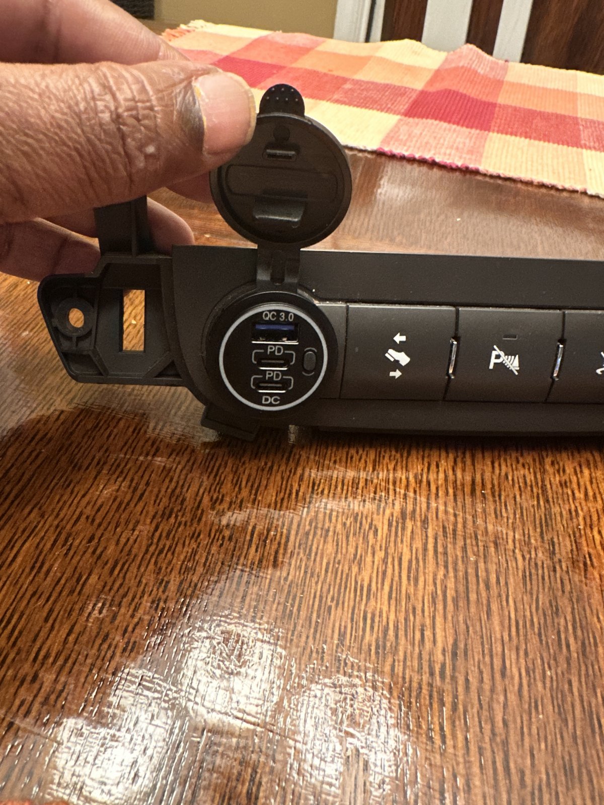

Since I had the dash out, I decided to remove the two cigarette lighters and add USB's
Those look neat -- what brand & part number are they?
I have installed Blue Sea Systems USB chargers in my other vehicles, but if this one has better specs, that'd be good to know.
mikez71
Mar 9, 2023
3,183
3,934
And what's that button for? Breaker reset? On/Off?
Or it it just an LED lense?
I'd only replace one, in case I need a plug...
(I do for my clone Tech 2. Candi module no work without DC adapter plugged in)
But I might replace one if I could keep the factory cover...

I purchased these on Amazon. The fitment for the lighter was a bit smaller than the USB adapter, so I had to Dremel it a bit to open it up. I also put one in the back seat for the rear passengers. I still have a lighter in the center console and the back if I need one. This is the exact one I used. It's a simple hook up. The only thing I hate is the aux fuse is a constant 12v. I am thinking of rewiring them to a proper ACC that turns off when I cut the engine.
justchecking
Military
Jul 18, 2021
515
1,472
SW Ohio
Thanks for the link!
What's the issue with power to them being on all the time? Do they have a high passive draw?
I use those. That little button on the right turns them on and off. I have left them on before while the cars have sat for a few days with no problem. The passive draw does not seem to be too much.
Edit: So I had one in the shop and measured it. Off current is 2mA. On current with no load is 8mA. On current with load is dependent on what you have hooked to it of course. .
