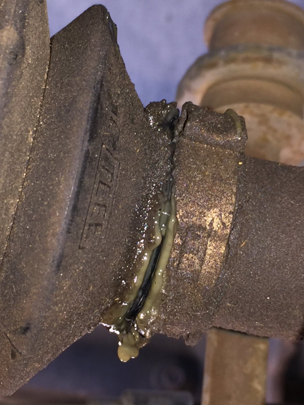

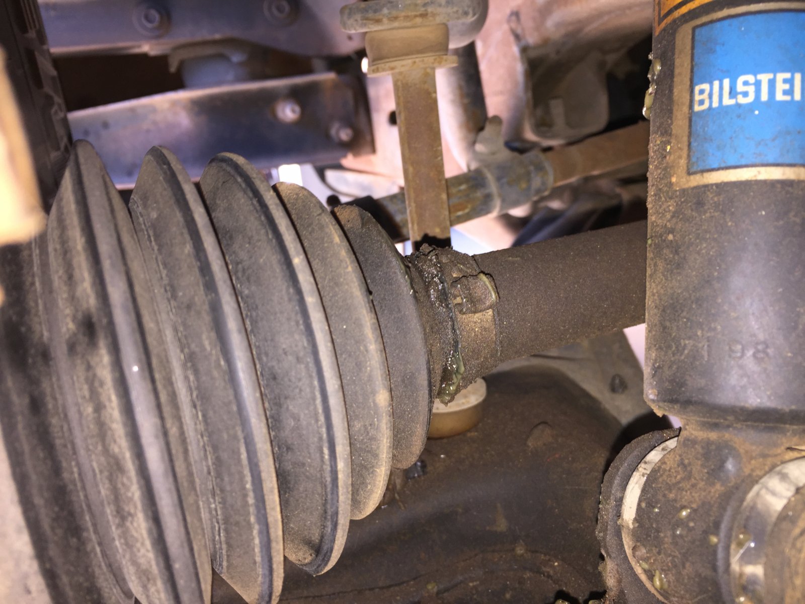

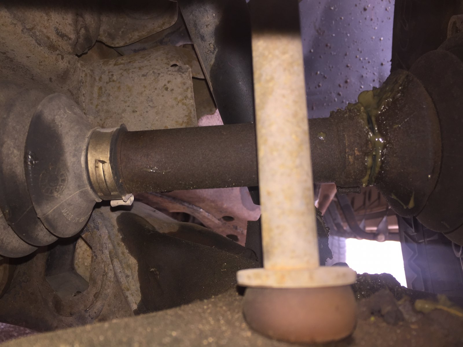

I was doing an oil and filter change and while under the car I noticed the spattered grease along the inside of the wheel well, and then more accumulated on the metal parts under the CV axle. Hopefully the pictures show it decently, but the front left CV boot has ripped right at the interior clamp. This developed within the past few days so I hope the axle hasn't been contaminated severely.

It’s a tedious job IMO doing the boot only. Maybe because I’m the sort that has to disassemble it and wash out every speck of old, potentially contaminated grease.
I’m not a fan of Dorman anything, If I were putting in the time I’d use the best part available. Sorry, I haven’t done one in a while so I don’t have a brand recommendation.
Most people today just take the faster way and replace the whole shaft, including me recently. I split a boot and just replaced the shafts on both sides. I used OEM.

What am I missing; doesn't the CV axle have to be removed to change the boots? Why not just a new CV axle?
It does, and after reading through the comments and doing some research I'll just pay to replace the CV axle. Since I'm away from home and the necessary tools the cost of labor to just replace the boot instead of the entire thing definitely isn't cost-effective.

I agree. If one has ripped, the other isn't far behind. I also agree with replacing the whole axel. If it's been slinging grease then the CV hasn't been lubricated properly. You also don't know how badly the CV has been contaminated. You'll pay more but it will take less time and you'll know the CVs are in good shape.

Yes, it is not cost effective. Just do the whole axle shaft with a quality axle.
