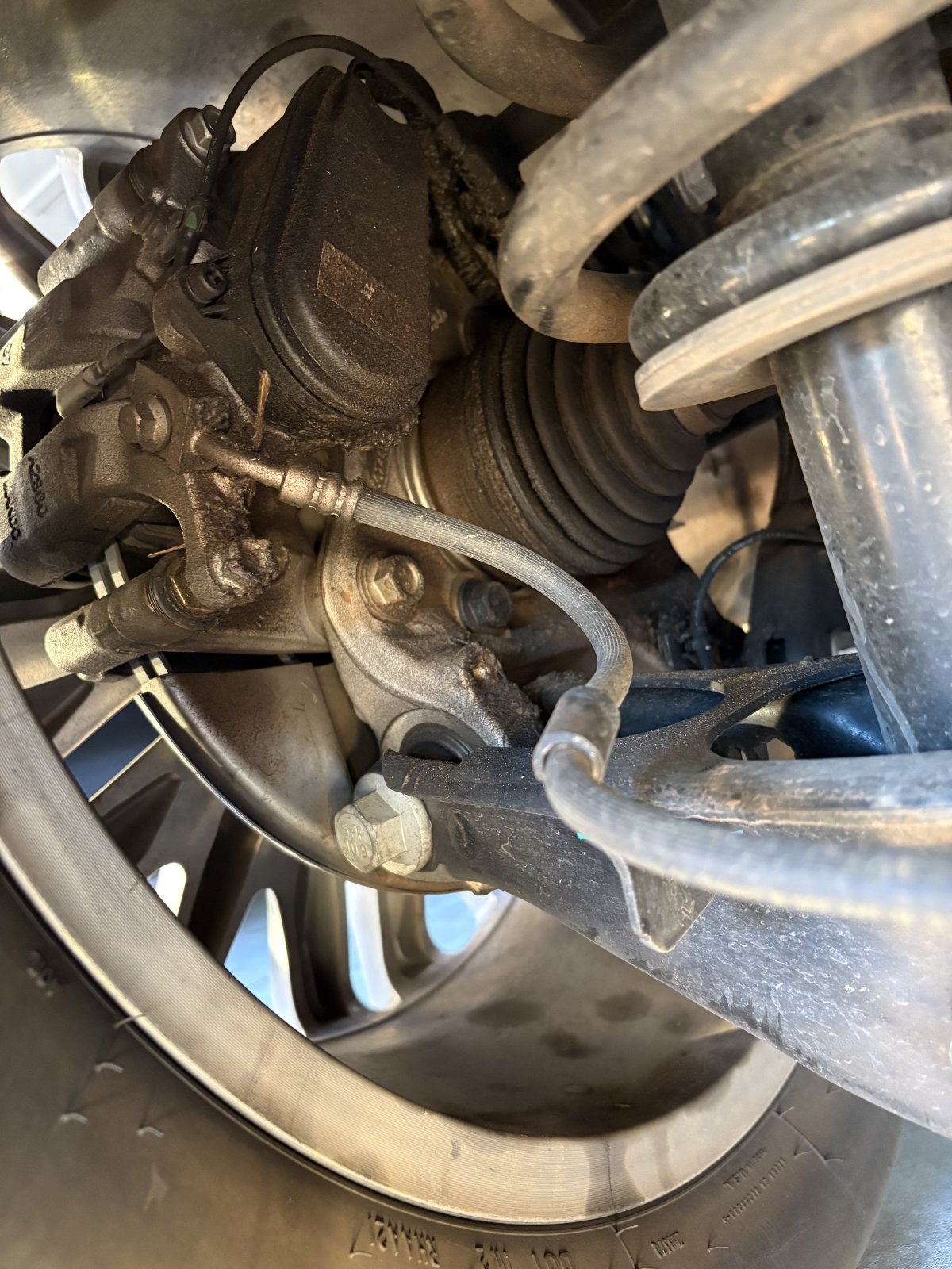

I was changing out the 75-140W in rear end of my '24 yukon... and noticed the drivers rear CV was leaking oil... i am wondering.. it looks like you can drop off the carrier end of the half shaft and then move the axle to replace it.. without doing an alignment..
not happy with a 8k yukon needing a new half shaft.. it is what it is i guess.
Let me know.. thank you

Picture would help. CV should only leak grease—and typically spray it everywhere inside the fender liner and over everything. If it is oily you have something else going on. Probably under warranty.

Yes.. grease.. and just like my old hondas everywhere.. do we need an alignment? The last cv i changed was an ‘18 e350. And you really had to take the knuckle apart.. the get the cv joint in.

oops... 9000 miles... basically between edmond and red river. yukon has been at 80 mph on the highway... but that is it. i was at a mcdonalds the other day and heard some noise on wet pavement... so i changed the rear gear oil into 75-140. gm changed the first free oil on it a couple months ago... i guess they really don't look at much in the inspect that they say they do.
it has been leaking since new. a lot dust/goo on the grease on the wheel end.. i worked in a power plant and am engineer... i just hate it when new things have problems.

There is a picture… thanks

Anytime you mess with control arms and independent suspension, you should get an alignment checked to ensure everything is running true.
This is 100% warranty tho. I wouldn't mess with it if I were you. Let your dealer fix it for free. They should be checking for alignment afterwards too.

well... to answer that... bob howard gmc wants the truck for four days or so to do it. i have a 92 yr old dad... i really don't want my car sitting around waiting for a tech for days for a two job.... it is what it is... maybe they don't have the shaft.. i don't know.
i looked at it.. i do not think you need to do more than remove bolts and slide it out. looks like lots of clearance.. but i done these before. it is best to know first... the cheapest GM half shaft is $250..

Let the dealer know the dilemma and see if they have a loaner or a rental. Or, rent your own.
So, the pic you show is at the back of hub. I assume you are saying the outer boot is leaking and slinging grease, correct? The is not a "slide it out" job. You have to disassemble for access and deal with electric park brake and remove the large nut at the outer end of shaft. It is not gonna fail asap. Arrange with the dealer and at least let them see it and then decide on a plan of action and time. Also, if you do attempt to do work there, that area is no longer under warranty, ANY OF IT.
