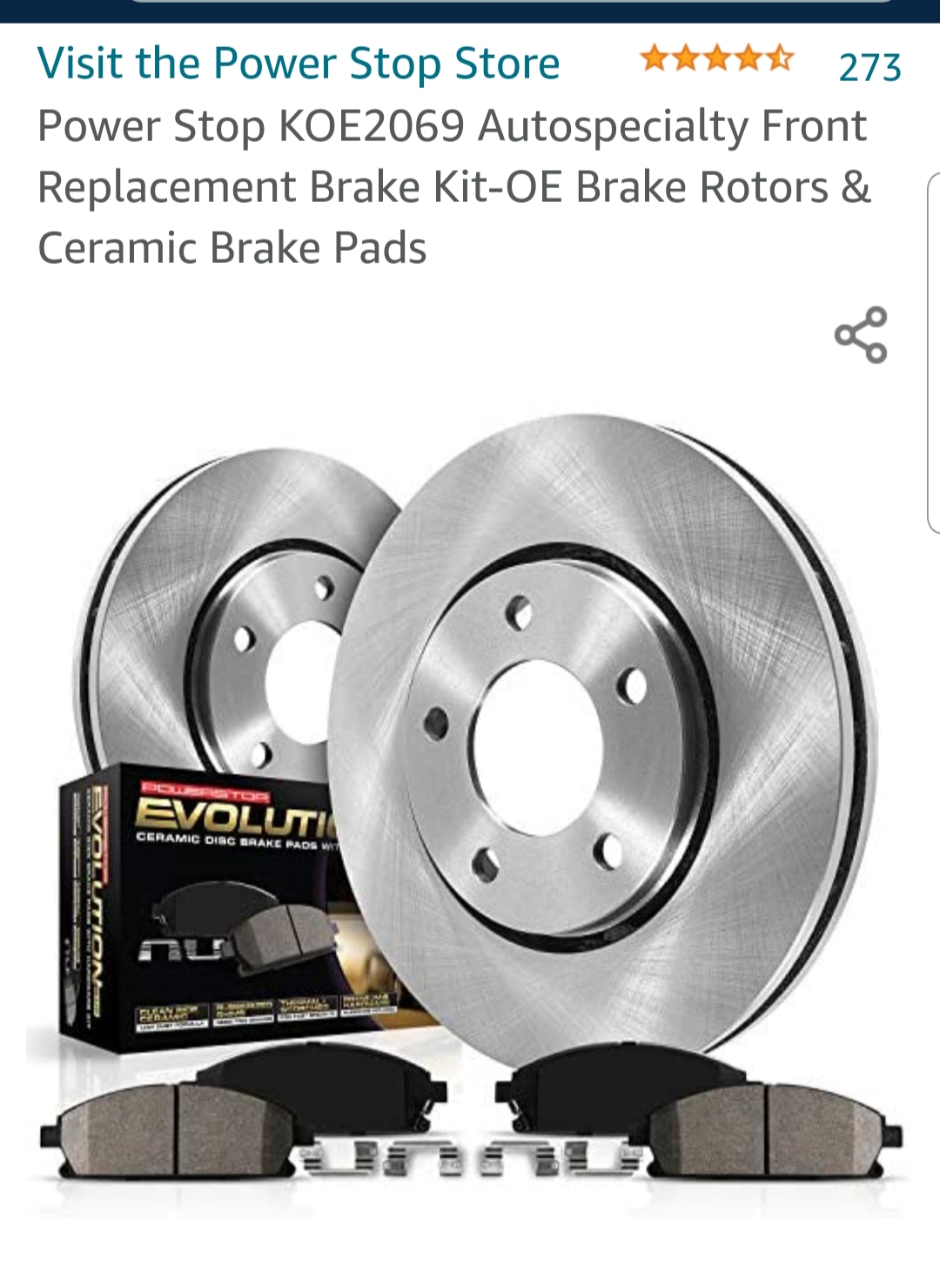

Solid reply. Thanks dude. I’m in NJ and 80% of my driving is on cruise control and I’m at 50k on the original rotors and brakes, spot on there. I’m going to replace the rotors and brakes and be done with it but I’m thinking about going to the Power Stops and ceramic pads.

You can get ceramic pads that are GM. If you like how long your brakes have lasted and had no problems, why switch unless you just want to?

Bought these a few weeks ago. So far I'm loving them. I also have the 07-14 brake upgrade. 20210810_163120.jpg
