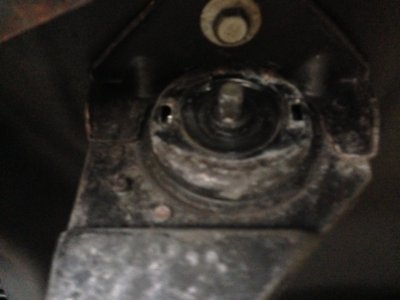

Its the rod with the hook like end correct? Kinda makes like a [ shape? I've gotten it to catch on something before, but when trying to turn it, it just slips.
This is what goes in toward the mechanism-and this is what turns.
