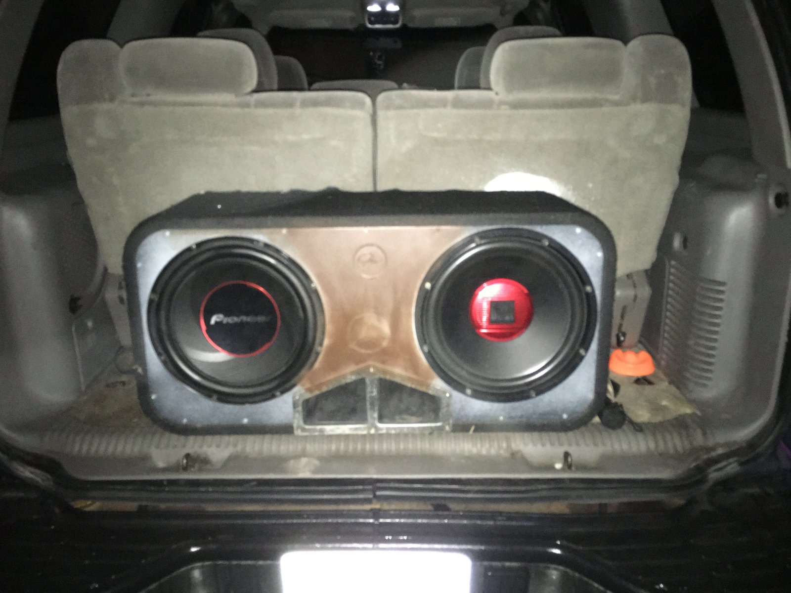

I actually just finished my dual subwoofer enclosure for my 03 Tahoe. I started with a 2 chamber, ported box that was wedge cut. It was originally 19” deep, and I needed it to be closer to 14”. So, I marked all my lines, straightedges the box, and took off with a saw. After knocking off 5” all the way around, I formed a new back wall, fiberglassed the back, added bolt terminals, and installed 2 Pioneer 12” Subwoofers. (The dual wAs out in place while my second Pioneer gets delivered)Final specs were 1.1cu foot per chamber, and Pioneer specs have it at 1.2cu ported. I have both subs, wired at 4ohms, to a Pioneer Gm5602 900watt amp, mounted under the second row seats. This set works awesome. There’s enough clearance between the subs, and the rear trunk that nothing touches. And surprisingly, the trunk doesn’t rattle as much as I thought it would. I’ll throw a few photos up, as I’m getting ready to pull the box, and color match the front plastics to the exterior purple of my Hoe!

And I forgot to mention that even with the box back behind the 3rd row, I have access to the 3rd rows lever to fold the seats flat, so I don’t lose the room I’d need to grocery shop, or shopping, hauling etc.
I could get you dimensions. Box I started with was a Bassworx Hpr212g.
