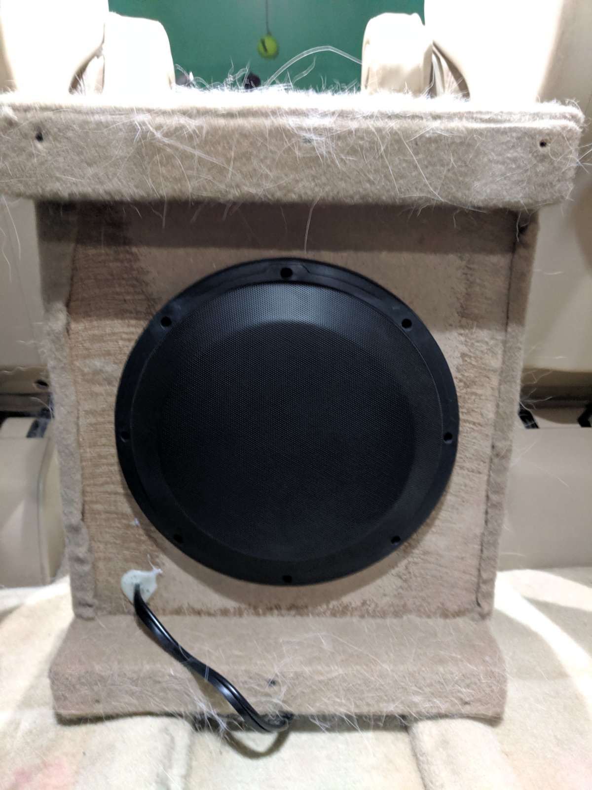

I have a custom, downward-firing sealed sub enclosure with an Audiomobile 10" sub between my 2nd row captain's chairs, but it is movable to anywhere in the truck. I power it with a 500 watt RMS Rockford Fosgate amp installed inside the truck's rear side panel. One of my dogs also uses it as a seat, when we are driving down the road (hence, all the dog hair).
I wish you the best of outcomes on your sub project.

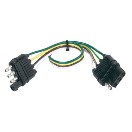

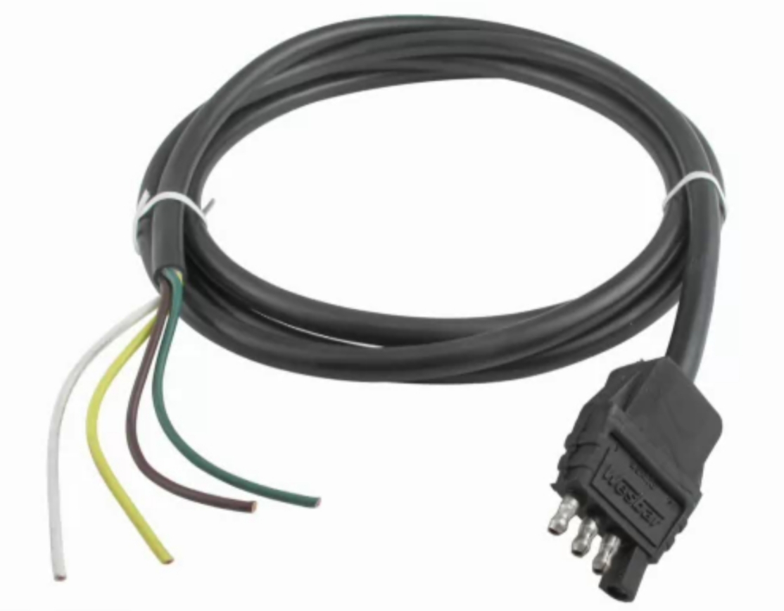

When I installed my box, I wired to the amp with a trailer wiring plug. The style that you can unplug, for the times I needed to take it out.

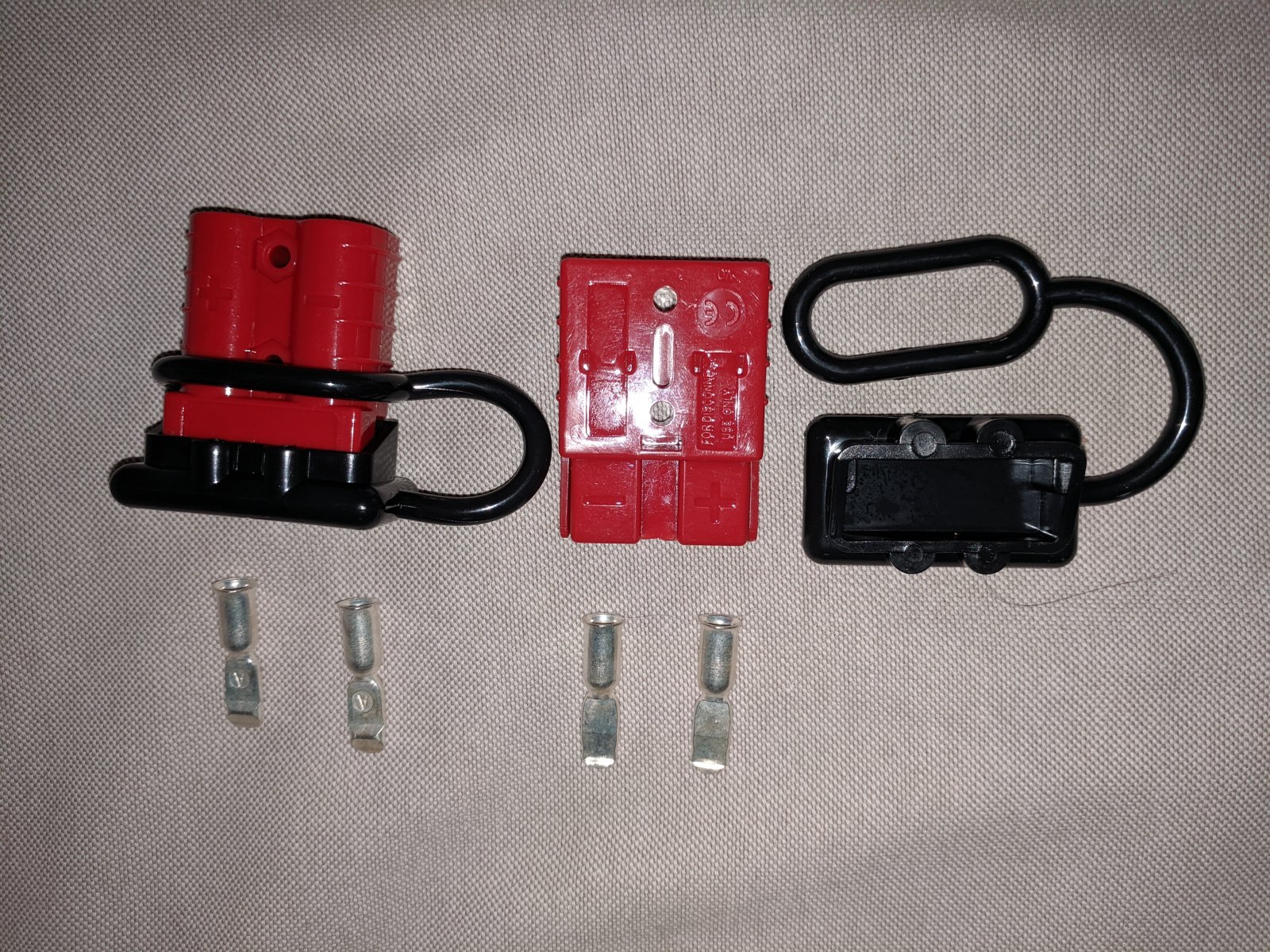

If you have a 1KW monoblock amp, you may want to use a higher amperage connector for your speaker wires, to ensure that peak amperage output surges from the amplifier get to the sub with minimum resistance. I have used these high amperage connectors for many applications, and they are quite durable and compatible with thick electrical cables. I picked them up on Amazon.

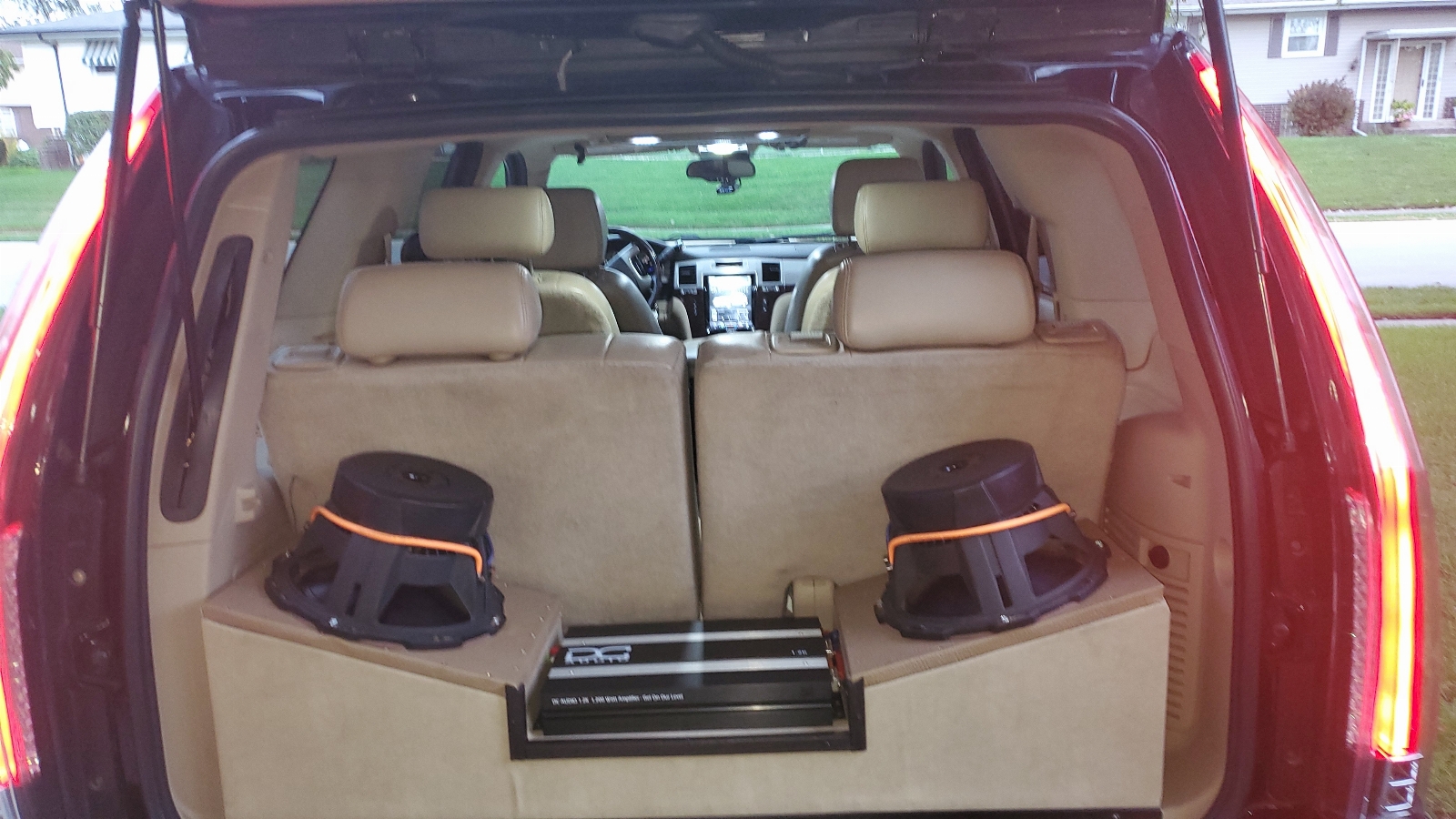

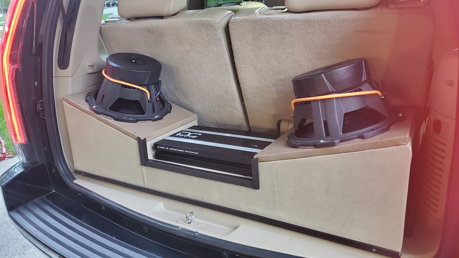

Here is a pic of my 3rd row box I built for my 09', Escalade not the greatest Ive done but it not bad.
2- 12" P3 and DC Audio 1.2K, Android 10.4 headunit
Gawd Damn!!!!!!! :cheers::chewie:

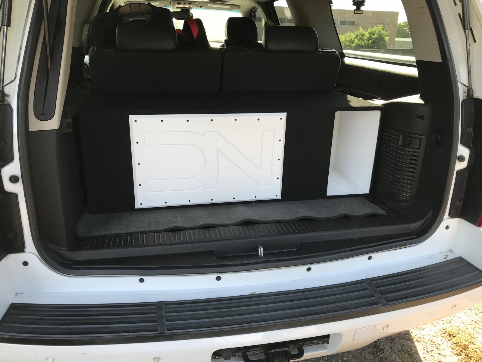

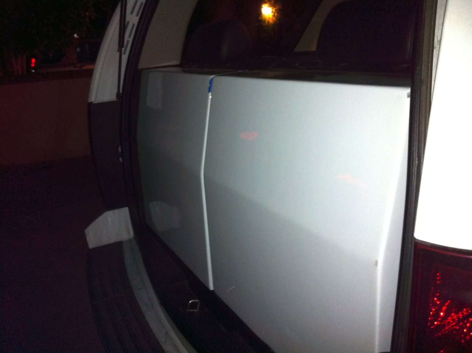

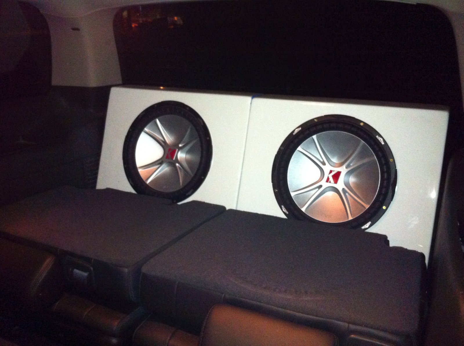

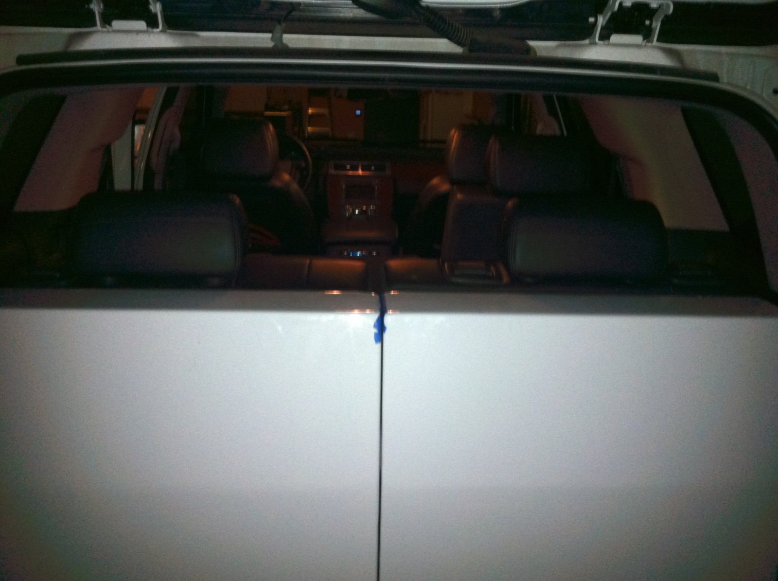

I squeezed 2 15" CVRs behind the 3rd row in custom sealed boxes and it was perfect.
PS This is my Tahoe from the "2007+ Add Sub To Tahoe" sticky thread ; )
