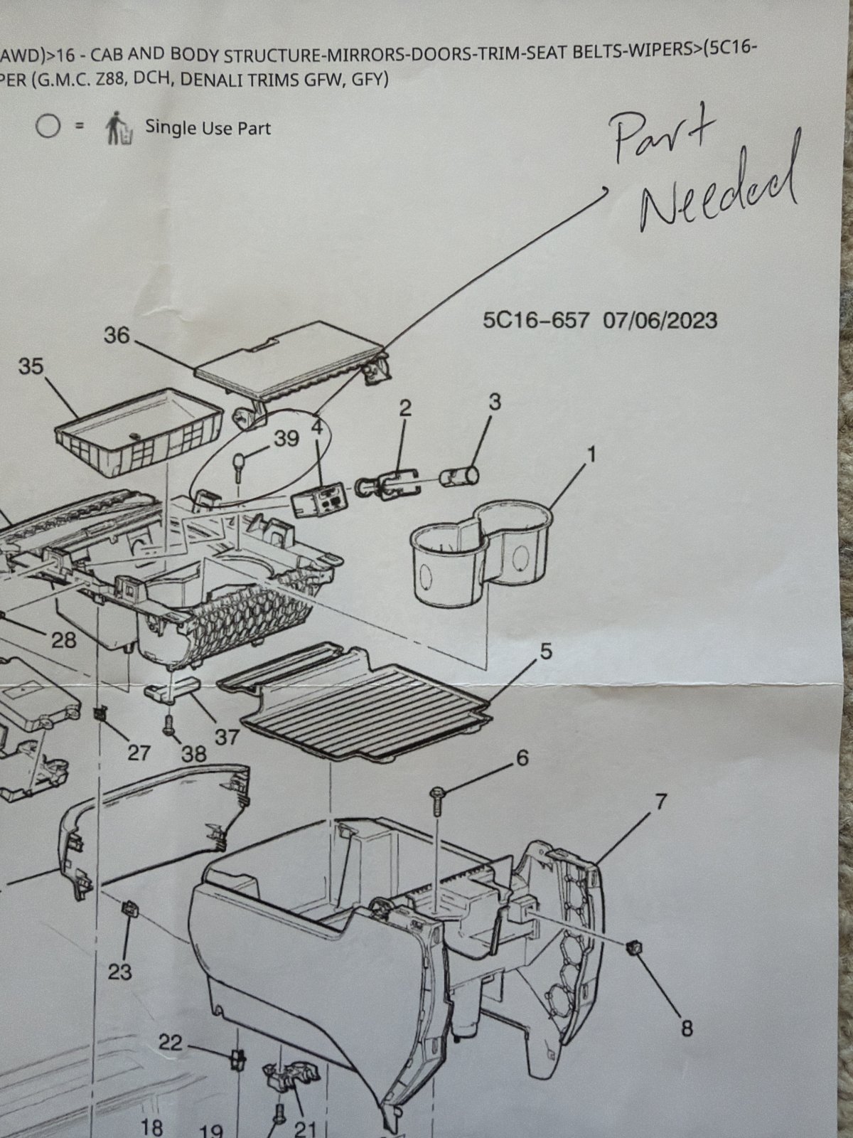

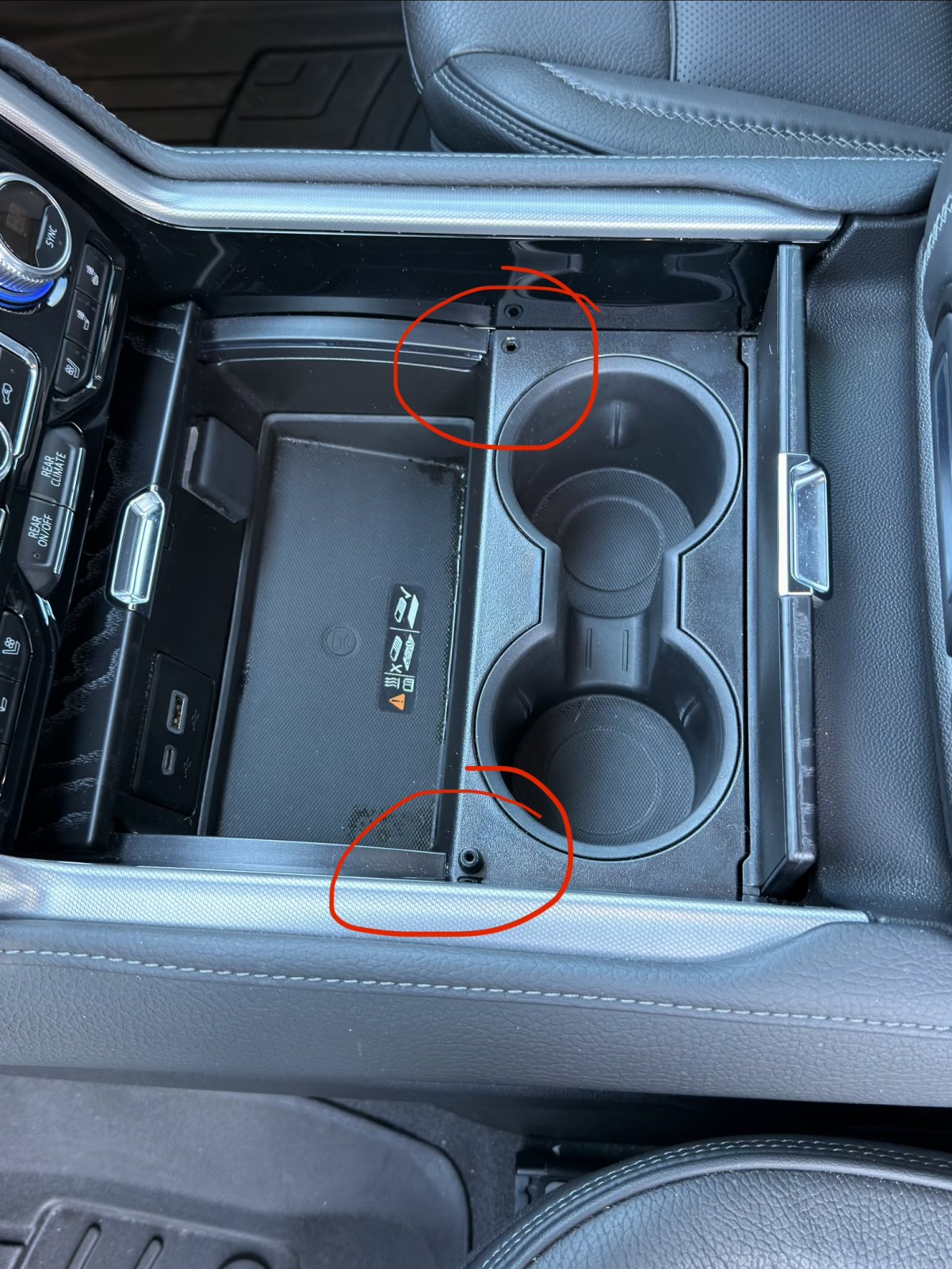

Some how had a rubber bumper in the front cup holder that supports the cover when closed come off, probably at the car wash. Stopped by the dealer today to see if they had the part and their system is showing it only as subpart to the cup holder assembly. Does anyone know of an aftermarket fit/fill replacement. See photos attached

The part you have circled, #39, is serviced separately. It has its own unique part number and can be ordered by your dealer. That part is also used as a fuel door bumper on some GM models, and other interior assemblies.
Because the illustration shows a unique call-out number for the part, it is serviced. However, it is possible that the item is sold by GM in packs of 5 or 10 (not one per pack).
Your dealer was incorrect or intentionally didn’t want to bother with ordering a small part for you.
You may want to look up your vehicle by VIN on a website such as GMPartsGiant.com, and find the illustration. You can then find the unique part number for that rubber bumper - and then find it via an online search (but will probably is being sold on EBay).
(I have no connection to GMPartsGiant.com or EBay, other than as a customer).
One other option is to check the “HELP” replacement items rack at local major auto parts stores - you may find this rubber bumper there.

Last eight of VIN. RR277571
Looking for item 39 in the above diagram.
Thanks!
Sadly these are not serviceable, part of the plate assembly.
But I did find an alternative when I needed these for my 01 Hoes center lid.
