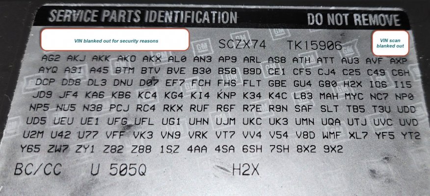

Do you electrical connectors at the top of the front struts? Any stickers on the shocks, struts and springs? Looking for codes like ABWS, ABZW, AB69, etc.
RPO codes might be ZW7, Z95, Z85.

As stated above, your RPO codes in the glovebox should tell you what shocks were installed on the truck at the date of manufacture. Please post a photo of your RPO code sticker for us to review.
The online sourcing recommendation was spot on. Folks here like RockAuto.com and GMPartsDirect.com. Go to GMPartsDirect.com, enter your VIN, go to the Suspension section, and look for the exploded diagram of the suspension components. You should find what you are looking for along with the correct part number. And, the cost will be significantly cheaper than the local dealer.
@Joseph Garcia - Thanks! I'll see what these on-line sources have to offer. I've attached a photo of the RPO code plate from the glovebox. Appreciate your feedback!

My replacement shocks probably aren't an option for your ZW7 system. My 15 Tahoe has the Z95 Magnaride. Also had really great ride but started riding like a lumber wagon; 3 of 4 shocks were leaking, went out around 146k early 2023. I wanted to keep the OEM capability, but balked at dealer ~$4000 price tag. Replaced at a local truck shop with the Strutmasters Magnaride front and rear kits for ~$2100 installed.
I think the Strutmasters are 'stiffer', for lack of a better word, in that I don't think the ride quality is as good as the factory system was. I still question myself if the $4000 would have been worth it, since I'm not as satisfied with the ride as I think I should be. I did take the Tahoe back for the installer's required 500 mile warranty check and mentioned the ride quality; no installation problems found.

You could have purchased them from the parts house mentioned or Arnott, which I have. They have rebuilt and new with lifetime warranty for less than 2k. @Joseph Garcia and I had passive setups and went back to oem. The difference was significant.
