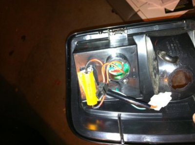

I think those are on there, heres a pic! I might not have hooked them up right as far as what light out goes where.

That is indeed a load resistor. Easiest way to hook them up is connecting them to the brake light plug. You can see which wires in the link I posted above.

I tried that configuration but no cruise, right turn signal flashed as if the build was out and remote start didn't work. Not sure what happened.

The setup for how the lights are plugged in for the oem tails are reverse for the aftermarket tails. So I have to flip them vertically, in the pic I posted the red goes to the top, the white is the middle and the other is the bottom but the bottom light doesn't work. Hope that wasn't too confusing.
