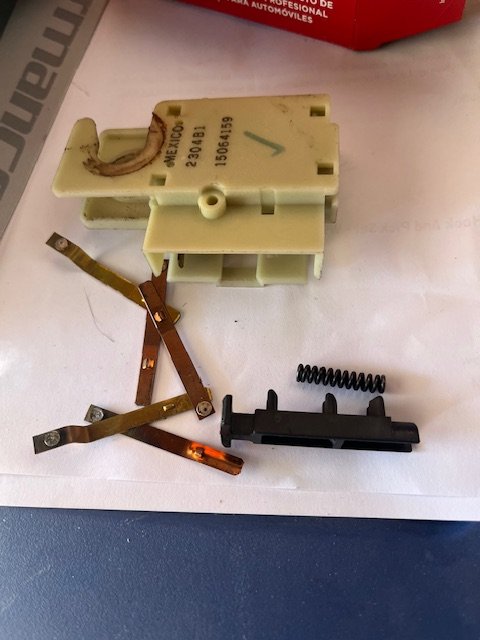

UPDATE:
Last night I got under the dash while my girlfriend was behind the Tahoe...and I'd press the pedal and wiggle the switch and all 3 brake lights would go on and off intermittently, so that told me it was the switch that was bad.
Went to O'Reilly today and got the switch...they had 2 different ones in stock, I opted for the more expensive one at 31.00, and I grabbed a set of angled picks to help get the retaining clip off. Glad I did, they came in handy.
Fired up good ol' YouTube and saw a couple of "how to" videos, and just dug in.
Its VERY tight under the dash, especially when you have the same body dimensions as a Sasquatch...but actually the job was pretty easy...well, except for re-installing the retaining clip! Can only get one hand under there and its hard to line it up, and have the fingertip strength necessary to clip it back in place. But I did it. Everything works great...even the cruise control!
Interesting note: when I was removing the old switch...it just came apart! In pieces! I wonder how long I had been driving around with no brake lights? Here's a pic of the old switch:
Oh well...another job done!

UPDATE:
