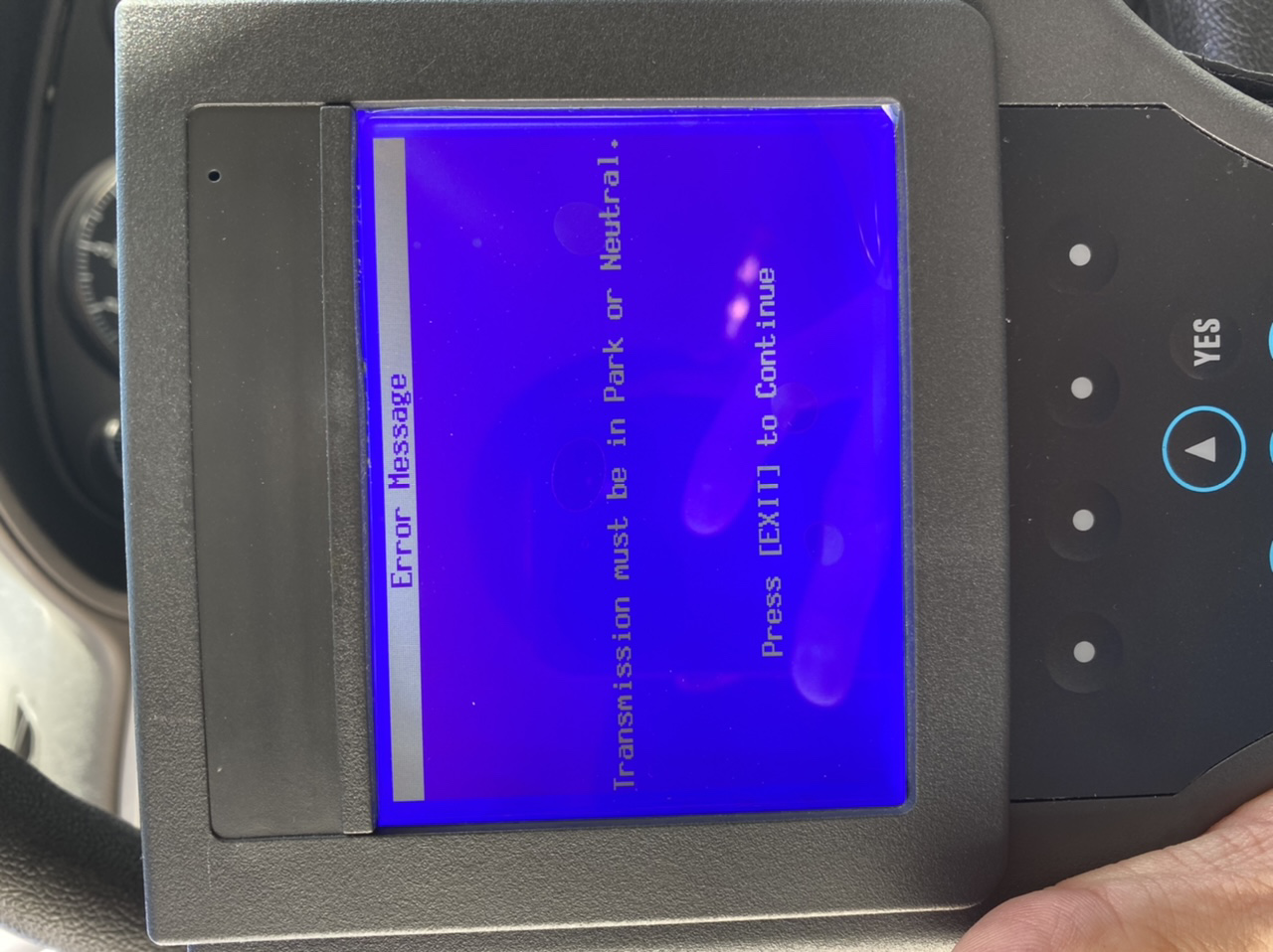

Messing around with the Tech 2 today. Found the starter relay menu, so I figured I’d start eliminating things like the starter. Interestingly, the first time I commanded the relay on, it started the truck. As in, the starter for a minute, disengaged, and then the truck barely 'caught' and stayed running. I tried to replicated it, and each time after that I got a very subtle click from under the truck, but no starter engagement.
Well, I messed around for a few more minutes and got the starter command function to operate the way I expected: I would command it on, and it would crank and crank until I commanded it off. I did this a few times until in the middle of a commanded crank, it stopped and I got the error below. So, now I'm thinking there's an issue with PRND switch. Could the switch have been friend from the transmission's 16-pin connector being shorted out with transmission fluid?
I would say it almost certainly is related to that switch (or switch wiring).
