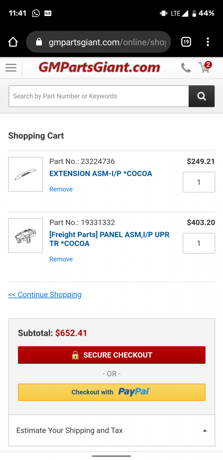

this is what I came up with for my 2011 Denali. I'm not even 100% sure if it's correct
52,956
this is what I came up with for my 2011 Denali. I'm not even 100% sure if it's correct View attachment 249553
Looks right to me. What kills you is the shipping. I found mine in EBay and they had cheap shipping. These dealers want $200-250 to ship the dash. It does come in a giant box, I have to admit but there’s almost no weight.
52,956
You don't need the extension (that first item). If yours is fine re-use it
Yeah you find out as soon as you pop it off, mine broke at nearly every clip. It was as brittle as the main dash.
