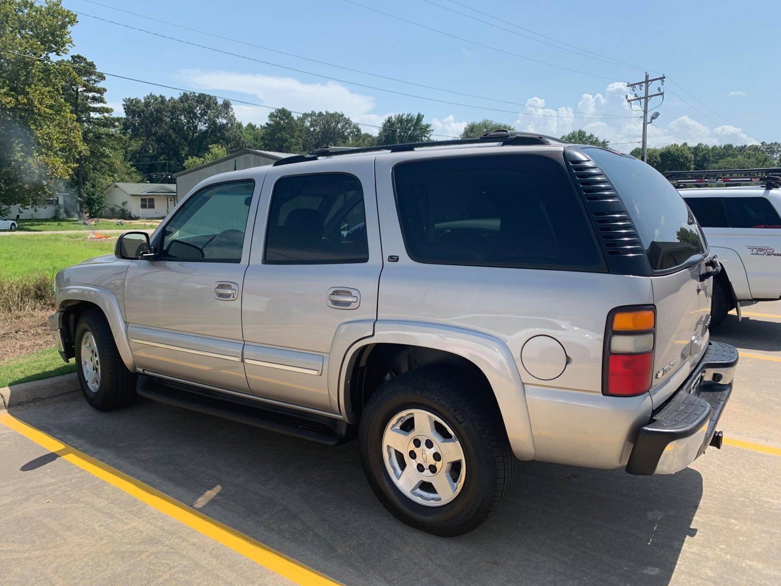

This is the first truck i have ever bought and just trying to find out a little more information about it. I pulled the RPO codes but to be honest I am having trouble telling the difference between factory and added options. Bought this to camp/carry canoes to and from the river. Possibly adding a pop up camper in the future. Really just wondering if I have a tow package or not and maybe what I could comfortably tow with this rig

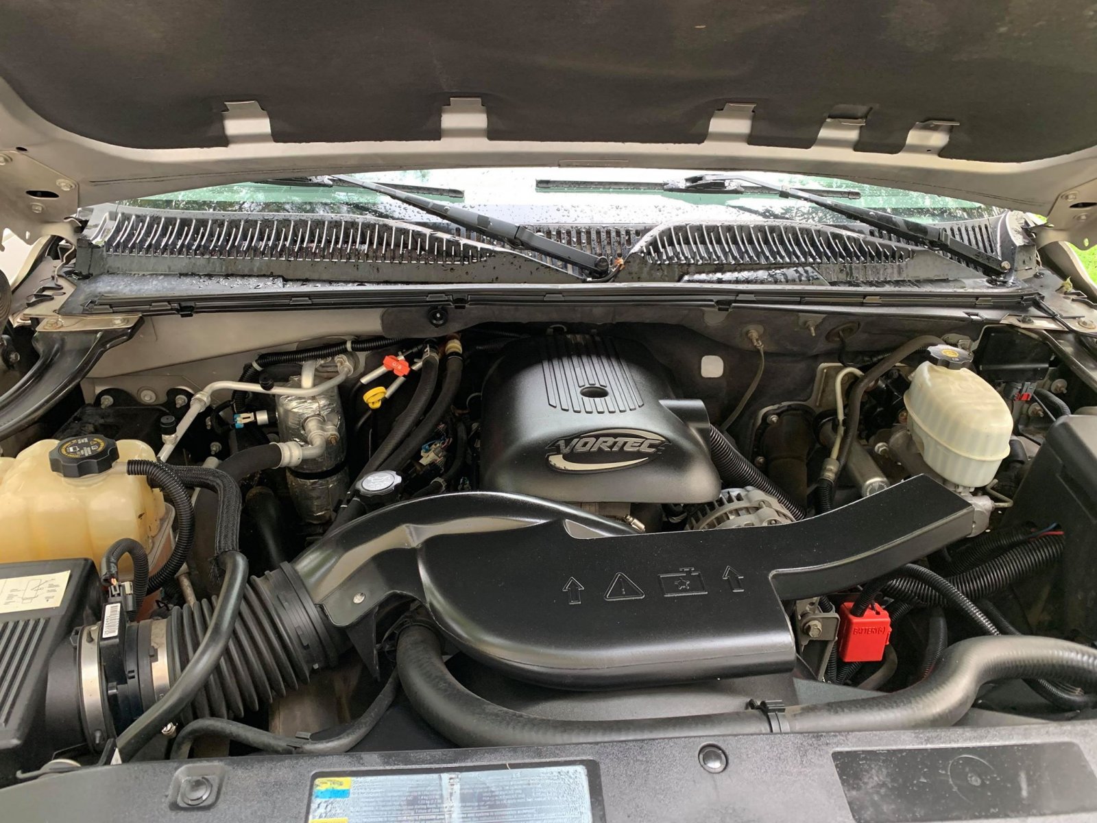

When I originally bought this I was under the impression it had the 4.8L V8 but after messaging chevy and getting the RPO codes it is showing the 5.3L. The rest of the Codes are what i believe have to do with suspension/tow capacity but for all I know those could all be factory options.

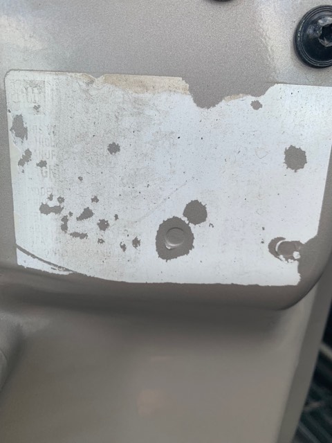

What does the sticker on your door that give GVWR say? That will give you your weight capacities.

The sticker on the inside of the driver door is a little faded unfortunately.
