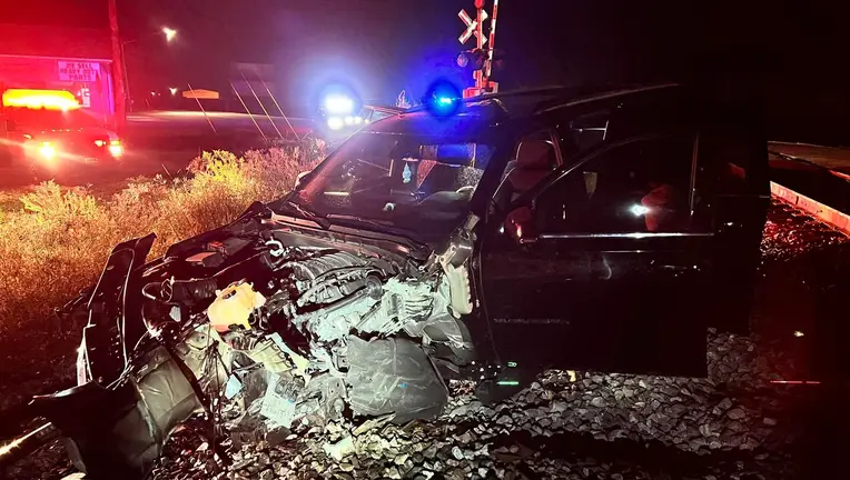

When I saw this news article this morning, first thing I wondered was if her lifters had failed.
