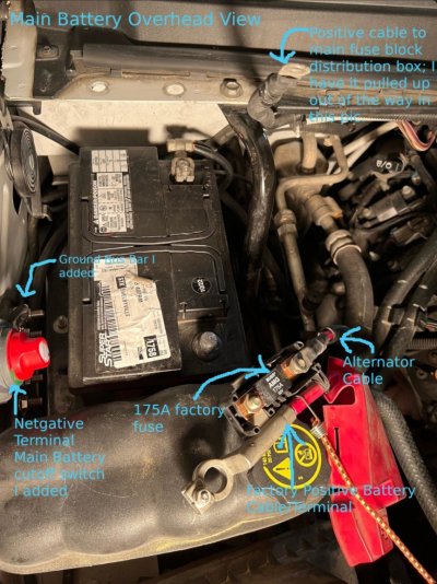

As requested, some images with annotations from the install. Some things are not fully connected in the images, and a number of finishing-tasks won't be completed until the truck is working and the auxiliary battery system tests successfully (Things like completing wire-ties and organizing routes of all wires ensuring nothing is in the path of moving hood springs/latches or any other problem-obstacles; the wire harness hole boot and other items will be re-taped with wire harness tape, the damaged alternator cable will be replaced, etc.)
Here is the factory alternator cable between the main starter battery and the alternator, showing where I found the chunk of insulation missing and bare wire exposed. I'm suspecting this is what caused the 175A fuse to blow, and most likely contributed to BCM being shorted/fried, along with whatever other damage I'll be working to find and fix:
main starter battery overhead view (things are not fully connected in the image since I am still troubleshooting)
new negative terminal cutoff switch I added to the main battery. If you've never used one of these for your main battery... once you do, you'll never want to be without it. So convenient for disconnecting battery for any install work, or for isolating things for electrical testing, for killing connection to the vehicle before removing/changing battery, or for disconnecting battery if leaving the vehicle sit for an extended period of time.
New ground-bus bar installed on inside engine compartment wall behind the battery:

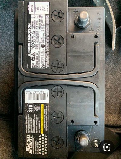

I realize this is old but it looks like the cables are backwards on the starter battery as it is turned around. Stock is with the connections on the fender side.
mikez71
Mar 9, 2023
3,183
3,934
Does look like the '+' and '-' marks on battery are backwards, and if battery was turned 180, they would be correct.
Nice catch! And welcome TYF newbie!

Holy cat snot. Ths is a year old but for anyone who wanders in--- Since BCMs were mentioned at first---I have 7 firebirds from 1995 to 2002. Everyone of them I bought for pennies from people due to CRAZZZZY things like lights coming on and off, windows working then not, etc etc ALL of them turned out to be BCM problems. It drove me nuts for months trying to figure it all out.
j91z28d1
Feb 28, 2022
4,599
5,860
you're probably right he killed the bcm. old post but for anyone that finds it. the post above is correct. he hasn't been back to follow up, but from the pics he put the battery terminals on backwards and fried stuff. how much, I don't know. the fuse probably saved him at first, but troubleshooting it sounds like he bypassed that and got all the crazy wipers and things going off.
his Pic
a better image of that 48prm battery
I hope he got it fixed. it was a very nice wiring job byond a simple mistake and these termals aren't marked well.
