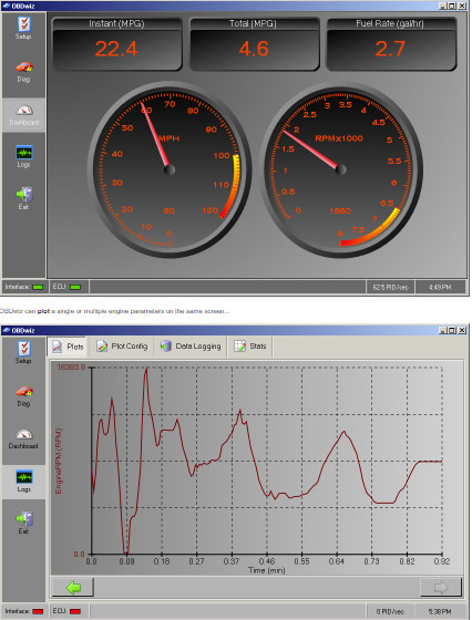

This:

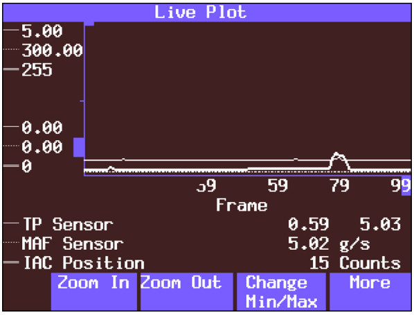

VS. this:

Then install PID Upgrade in OBDWHiZZ. Not in Freeware. And your Tech2 Shows you the PID.
https://torque-bhp.com/forums/?wpforumaction=viewtopic&t=5579.0
I purchased the upgrade, it does not include Variable Valve Timing angle (CMP). It did get me oil & transmission fluid temps.
I need to get more familiar with the Tech2, have not seen a screen listing PID numbers.
I read thru thread you linked, some good info there, but they are talking about distributor position on GMT400 vehicles.
I am looking for VVT camshaft angle on GMT900.
