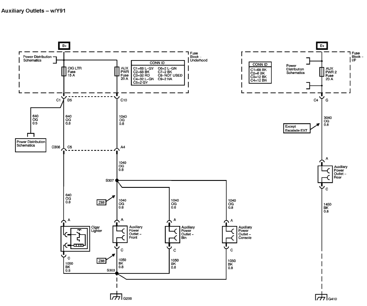

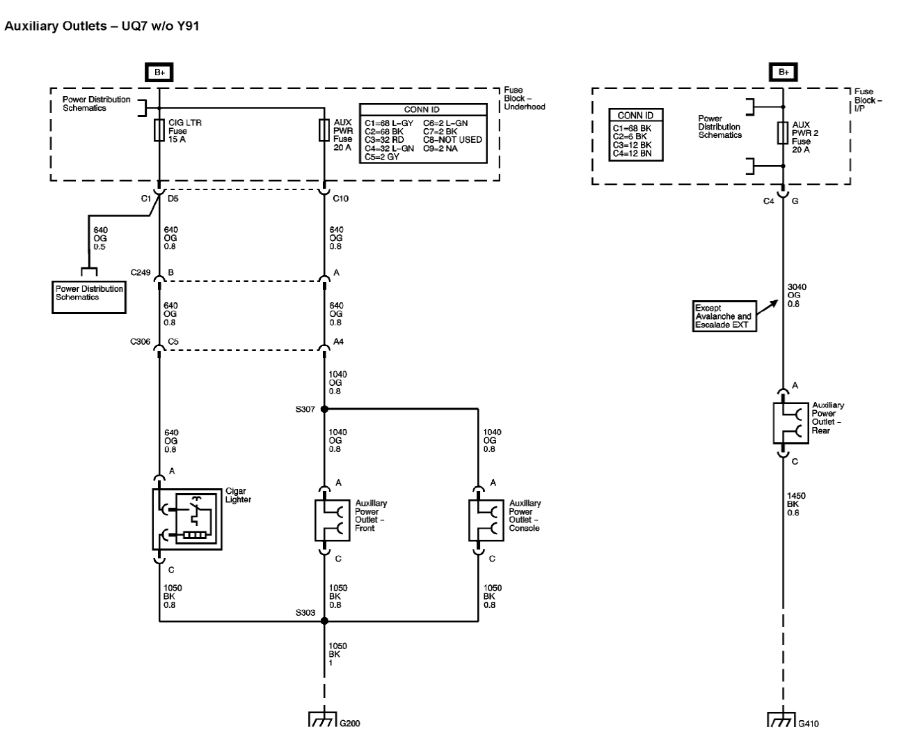

Use a test light or Fluke or multimeter and see if it has power at the Cig lighter connector pigtail.
Check if the fuses have power when key is on.
If fuses have power and endpoints do not, there must be a break in the wires.
Do an OHM test on the wires to validate a broken wire.
You'd have to find a wiring diagram to trace the wires.

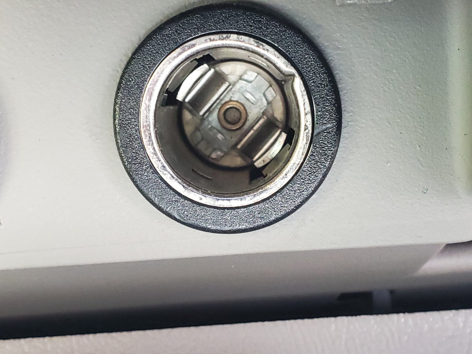

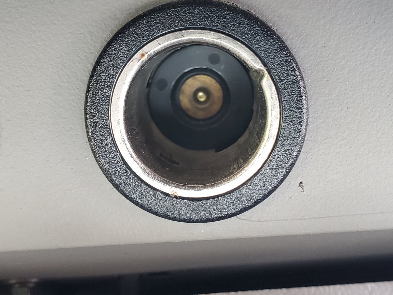

I'm having a similar issue in my 2002 Tahoe LT. I have the 3 outlets in the dash above the tape deck and only the far right one works. When I look into the socket it looks different the the two on the left. And the socket for the rear seat also looks like the two left sockets in the dash and it also does not work. Granted I have not tested them for power but they look like two different types of sockets. Is there a difference between sockets?

1 is for a cigarette lighter the others are merely power. But they all do the same thing.... charge whatever you’re charging

That's what I assumed. Are they differently designed sockets? One, the one that works, looks like a standard cigarette lighter outlet inside of the socket. The other three look different in the socket. Once I get home I will post pictures. I think what's happening is the charging adapter that is plugged in is not making contact somewhere. I'm trying to figure out if they are different sockets or broken on the inside.

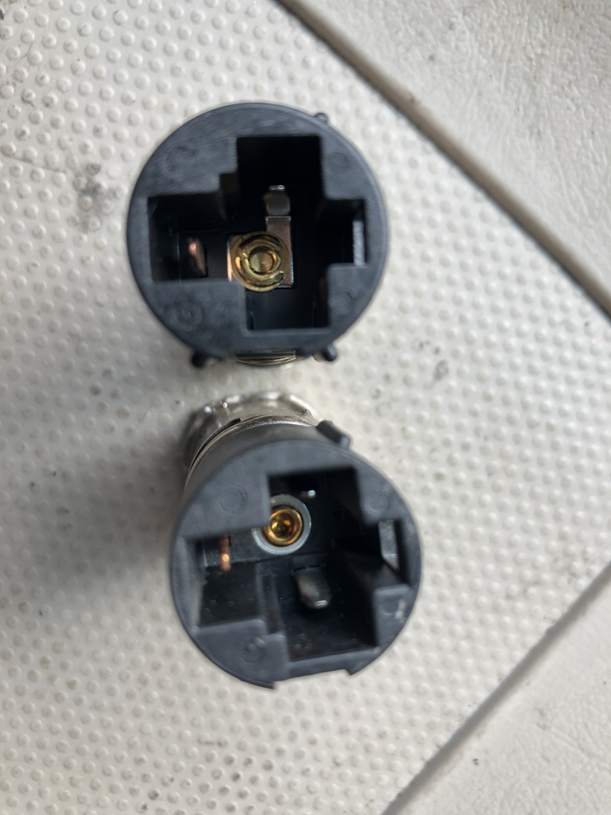

I traded out the socket on the left with the one on the right and it works. the one on the left looks different and 3 of them look just like it.

Because 1 is made to hold and actual lighter...you can see the tangs that hold it until it gets hot enough to pop... the other just has power and ground
Iirc the connection behind are exactly the same. Black plastic connectors with an orange and black wire but the connector should fit both sockets

I'm sorry guys....I'm retarded. There was a circular metal charm one of my kids stuck in the outlet to the back seat. It blew the fuse. I replaced the fuse but the outlets didn't work....BECAUSE....the adapter I was using to test them didn't have a long enough "probe" to reach the contact in the bottom of the power socket but it worked in the cigarette lighter outlet. I used a different power adapter and they all work now.

Fyi to anyone else replacing sockets, the aux socket and cig light socket on my 01 Yukon use different connectors, and are not interchangeable.
Cig light part#: 25776667
Aux socket part#: 25774623
