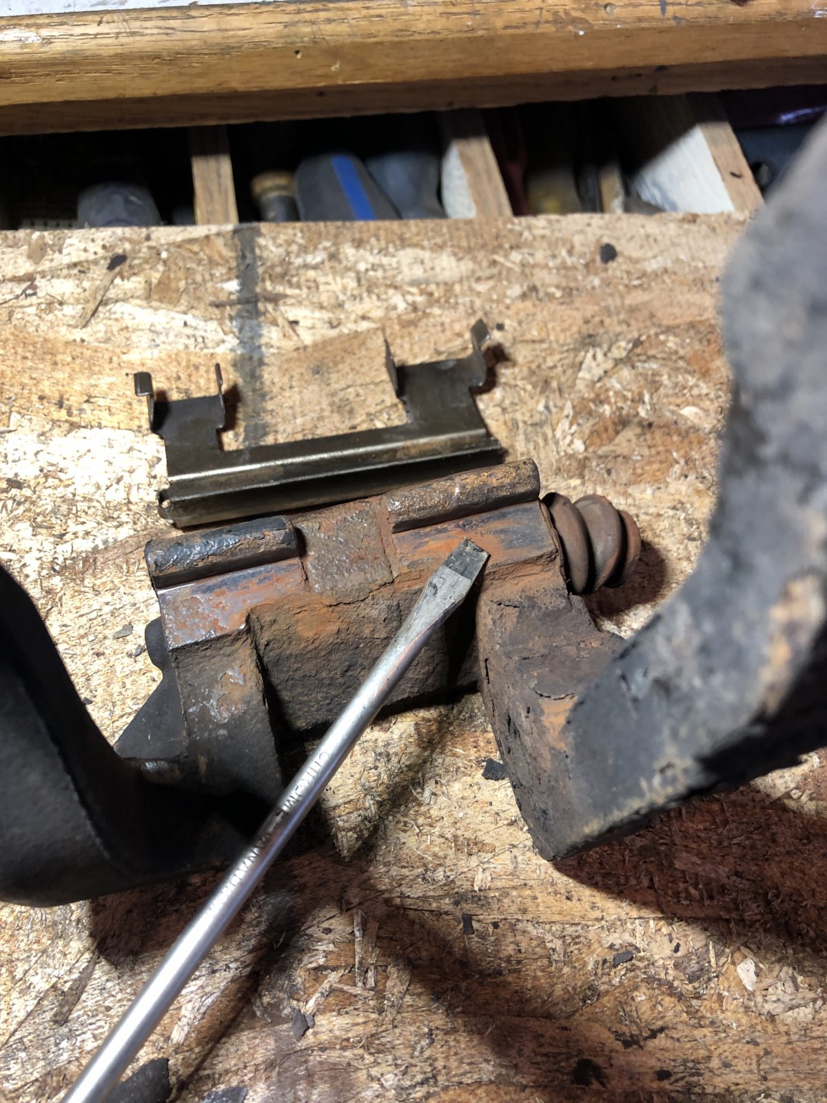

Ok so maybe I’ve found the problem. I remember back a few months ago putting new pads and rotors on and finding it difficult to get the new pads in. So today cleaned and greased and same thing. So after looking the rust buildup under the chrome clips maybe why. I’ve been cleaning the sides not the flat part. Anyway will get it back together and see

Ok so did the other side again lol.also took a round file to the notches in the pads. They slip right in now. Went for a test drive and feels good. Will have to clean my front wheels and see if the excess dust has stopped.
