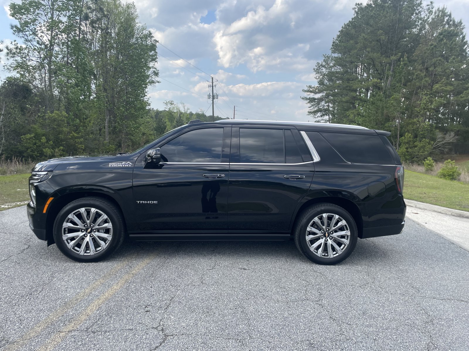

I had the 15% ceramic tint installed on the ‘25 HC by the same guys who did the installation on my ‘01 Tahoe over 24 years ago and the film is just starting to bubble up a little so I trust the quality of the installation that was done with the new Tahoe. The ‘01 Tahoe has lived her entire life outside so I think it’s worth the price for a quality installation and a quality product.
