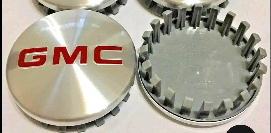

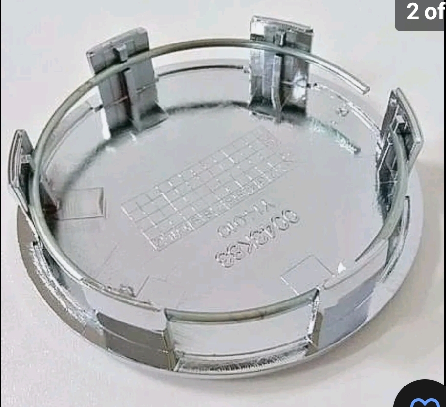

Are these the small about 3" diameter center caps?
There are 2 different types, ones with short prongs and ones with longer prongs. You have to use the ones that match the groove in the wheel.

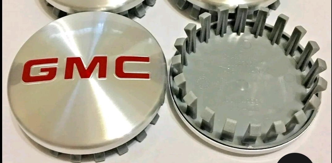

I have OEM 22s on my 2015 Yukon. Recently bought replacement center caps with GMC in black on ebay.
I cant get them flush with wheel. Any suggestions?
