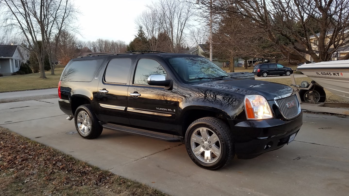

And because threads are worthless without pics....heres one of our newish baby. I pretty much ignore my F150 anymore because I love this thing so much. haha.
