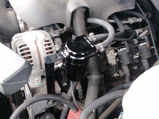

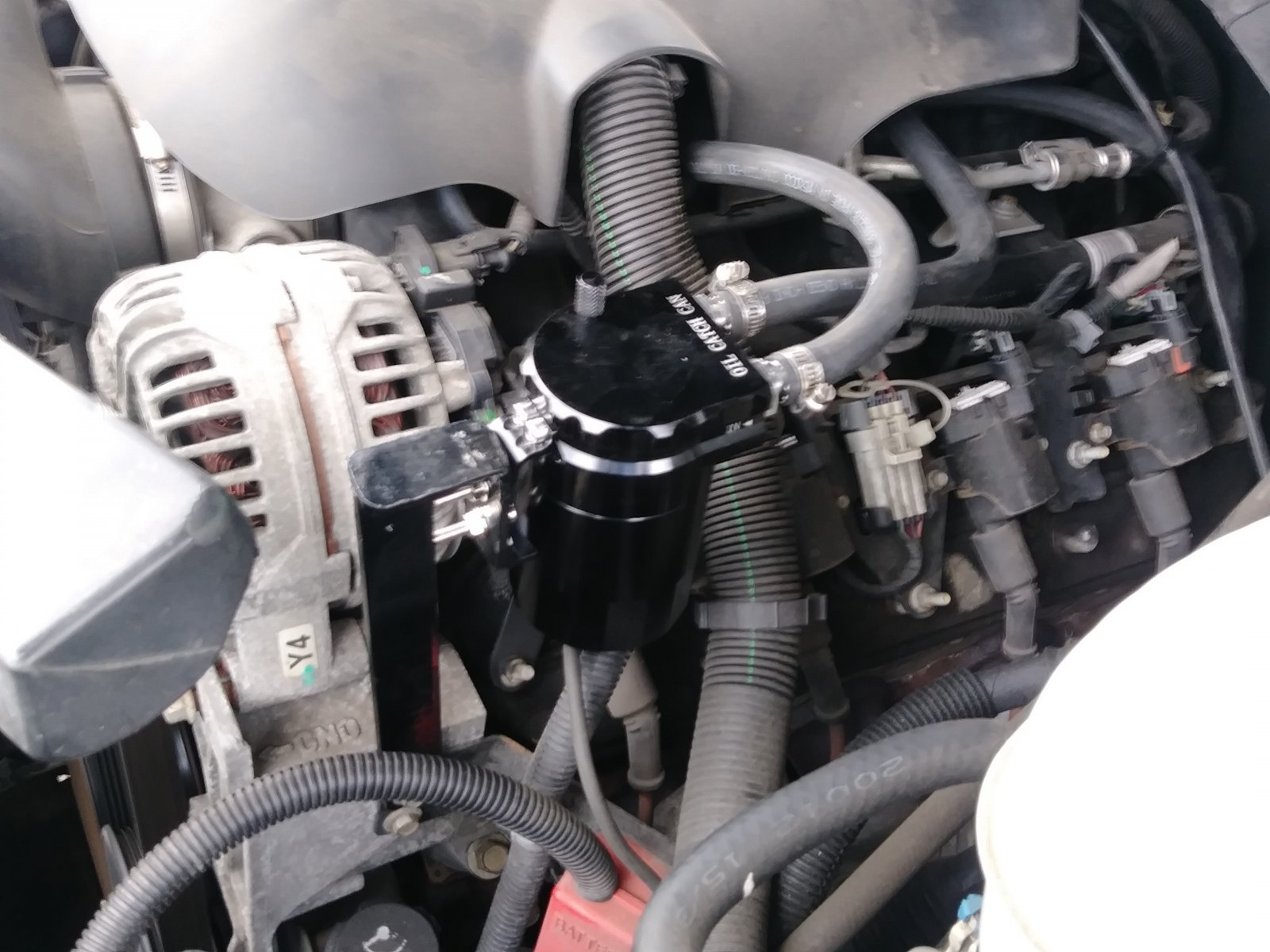

i put one on as well as many others have. i made the bracket and got a cheap can off amazon, 25 bucks at the time. if you get the cheap one, the hose they give you is trash, so you'll need to buy some real hose.

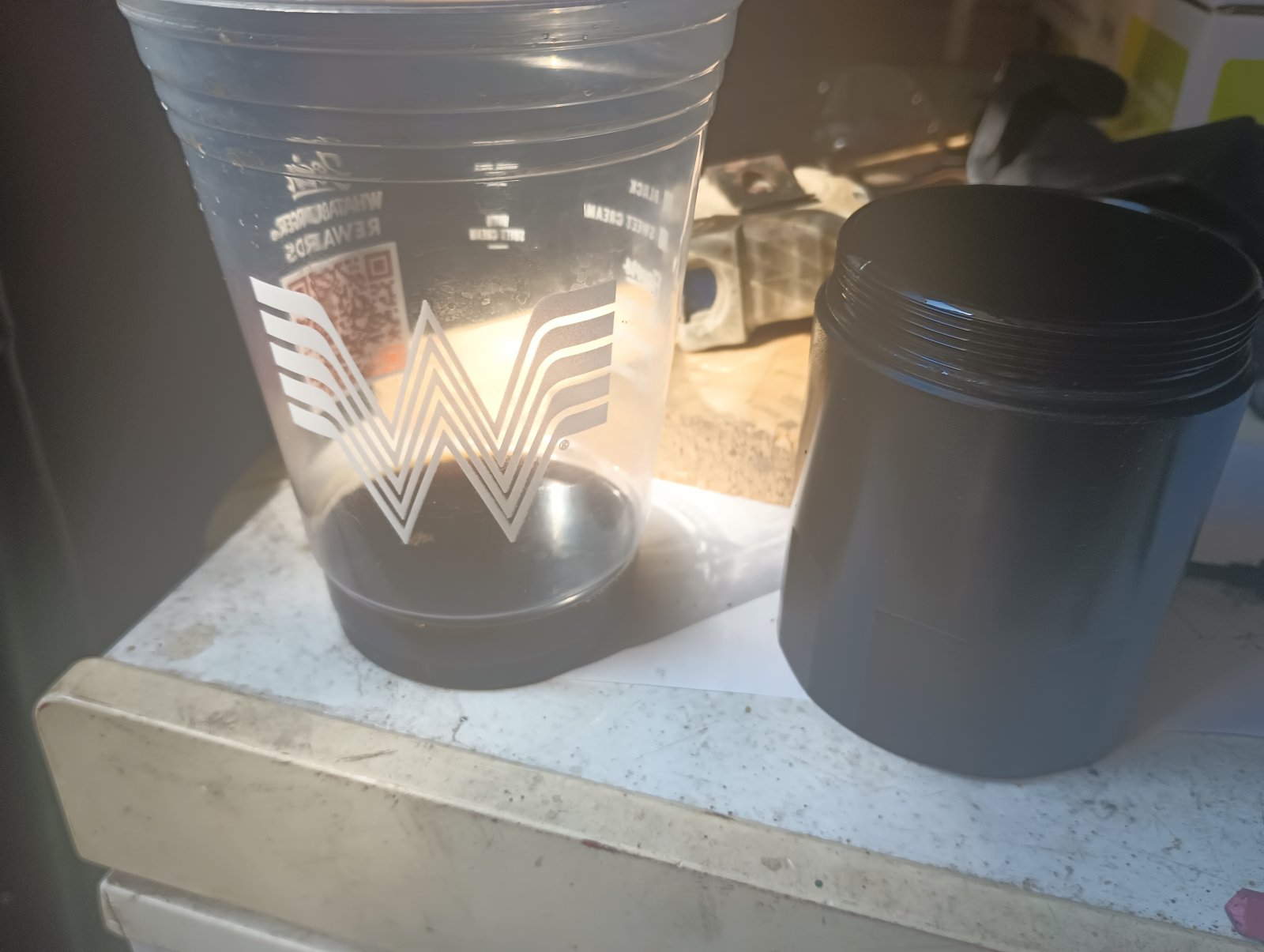

I have the amazon cheapo ones on both the Silverado and Tahoe.
Tahoes catches about 4 ounces over the 3000 mile oil change interval.
The Silverado on the other hand.... gets about 2 to 3 ounces every tank of gas. So 400 to 500 miles. Depending on highway or town miles. So yeah. They work at keeping the inside of the intake clean

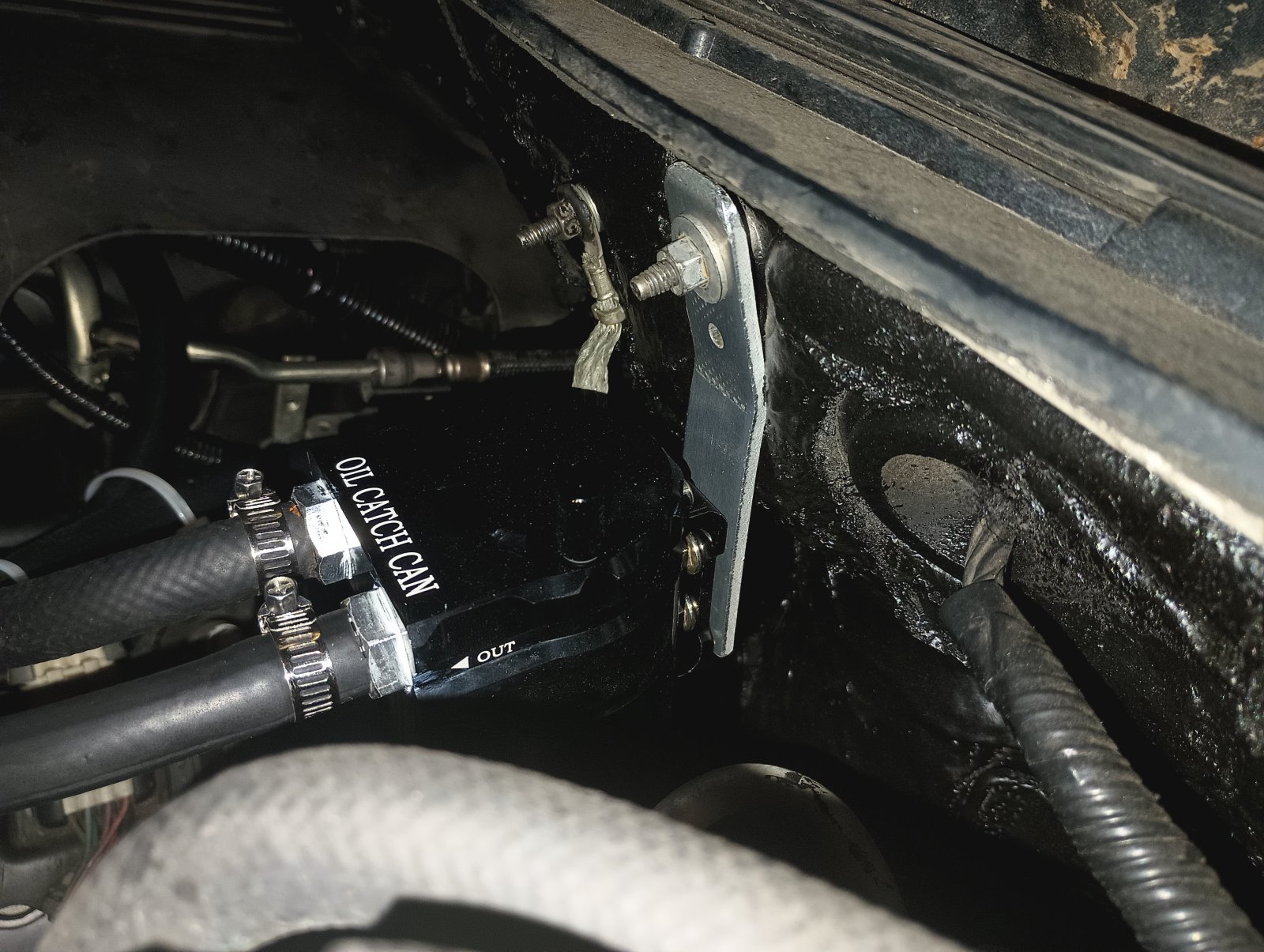

As @Scottydoggs mentioned the hoses in that particular kit, I went with some high-quality silicone hose. With winter coming, if you're in a freeze zone, make sure you keep a close eye on it or bypass for the season.
