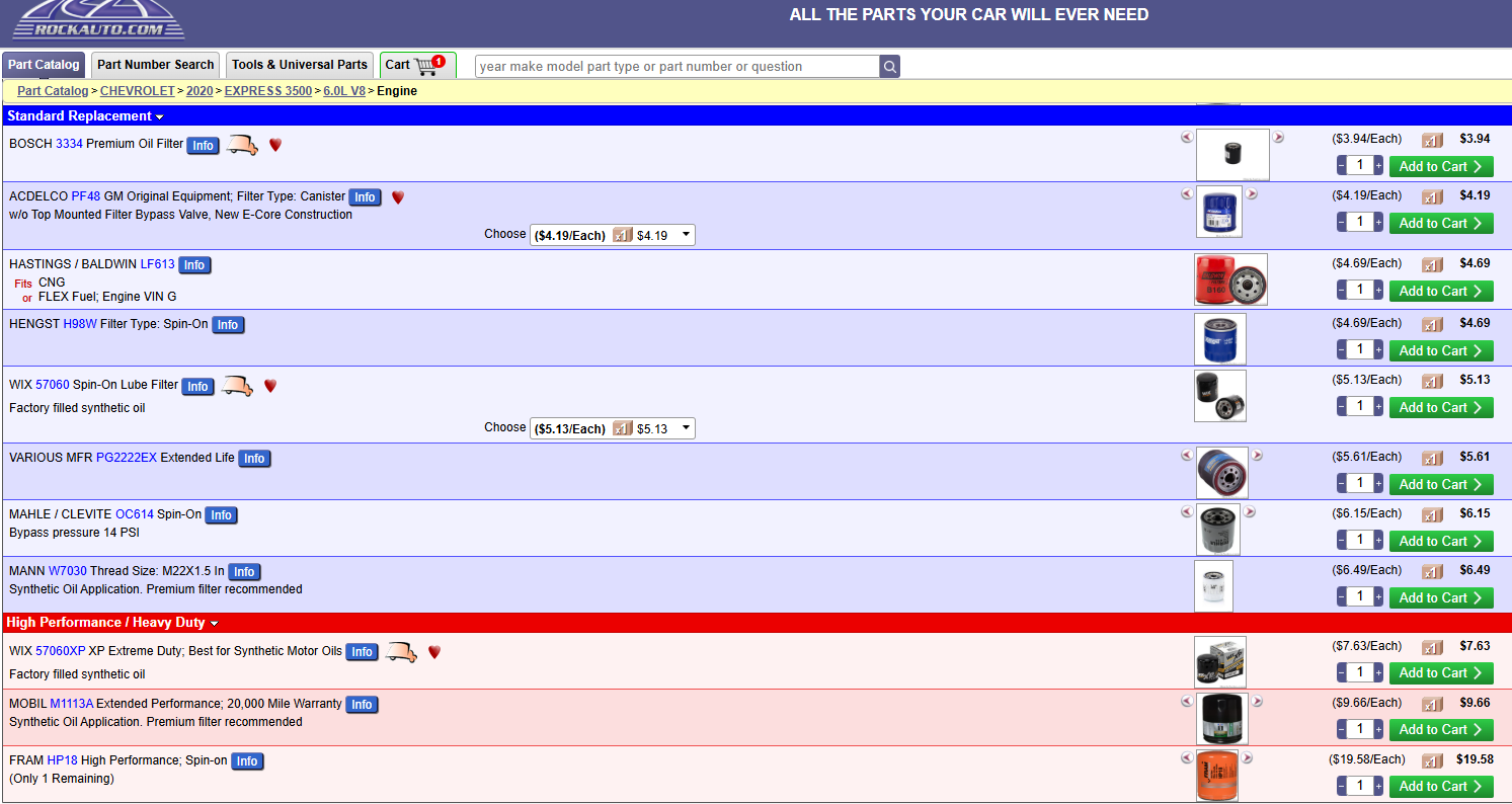

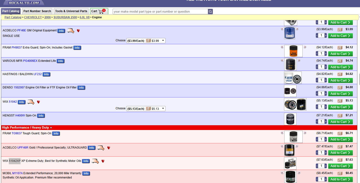

I've been stocking Wix 51042 for my Gen III 5.3 and 6.0 and Wix 57060 for our Gen IV L96 Express van. I buy them in 6 or 12 packs, but was wondering if I can consolidate and use the same filter for both?
Google says the PF46 was the older Gen III, but not recommended for the Gen IV, which used the PF48 or the longer PF63 (and these are backwards compatible with the Gen III?). However, when I cross reference the PF63, I get the Wix WL10255? I'm kinda confused...
What shows up in RA for the Gen IV is the Wix 57060XP and 51042XP for the Gen III. Or just order the AC Delco PF48? RA doesn't even show the PF63 currently.
Here's what shows up on the RA website:
Gen III
Gen IV
Thanks in advance.
