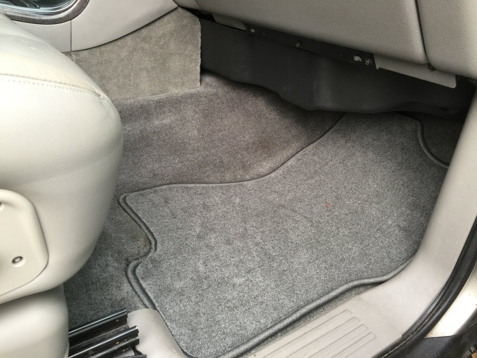

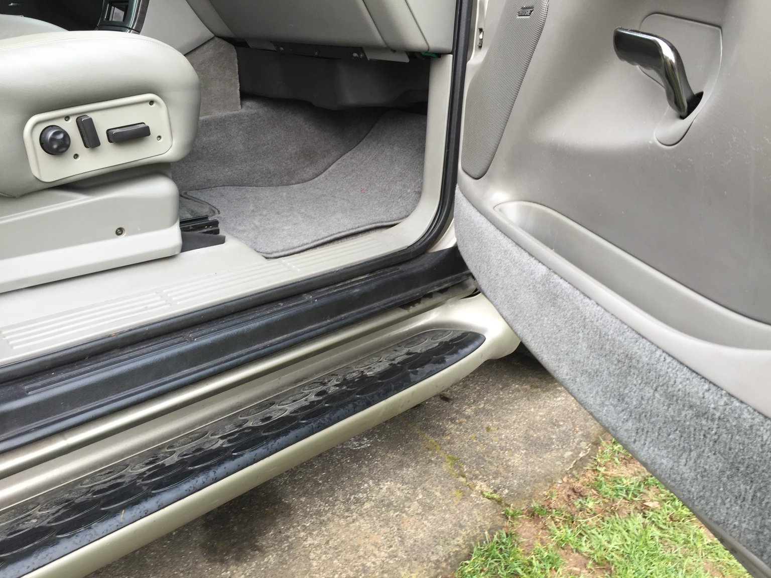

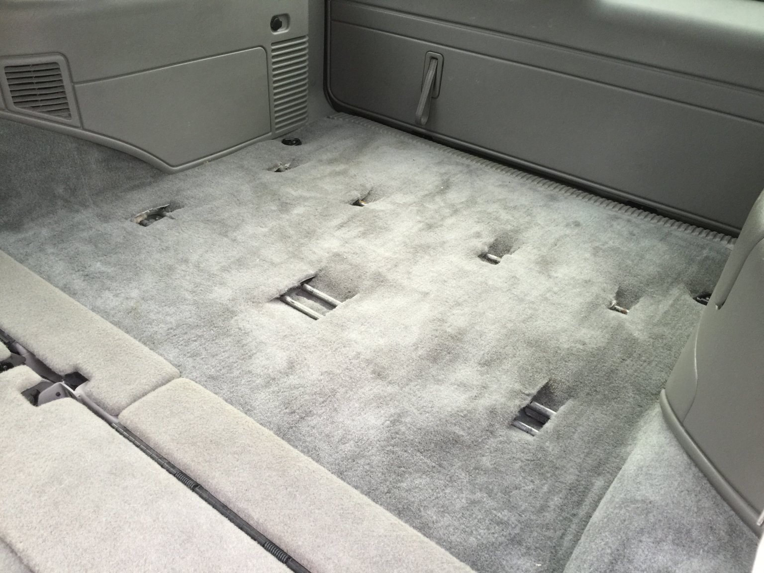

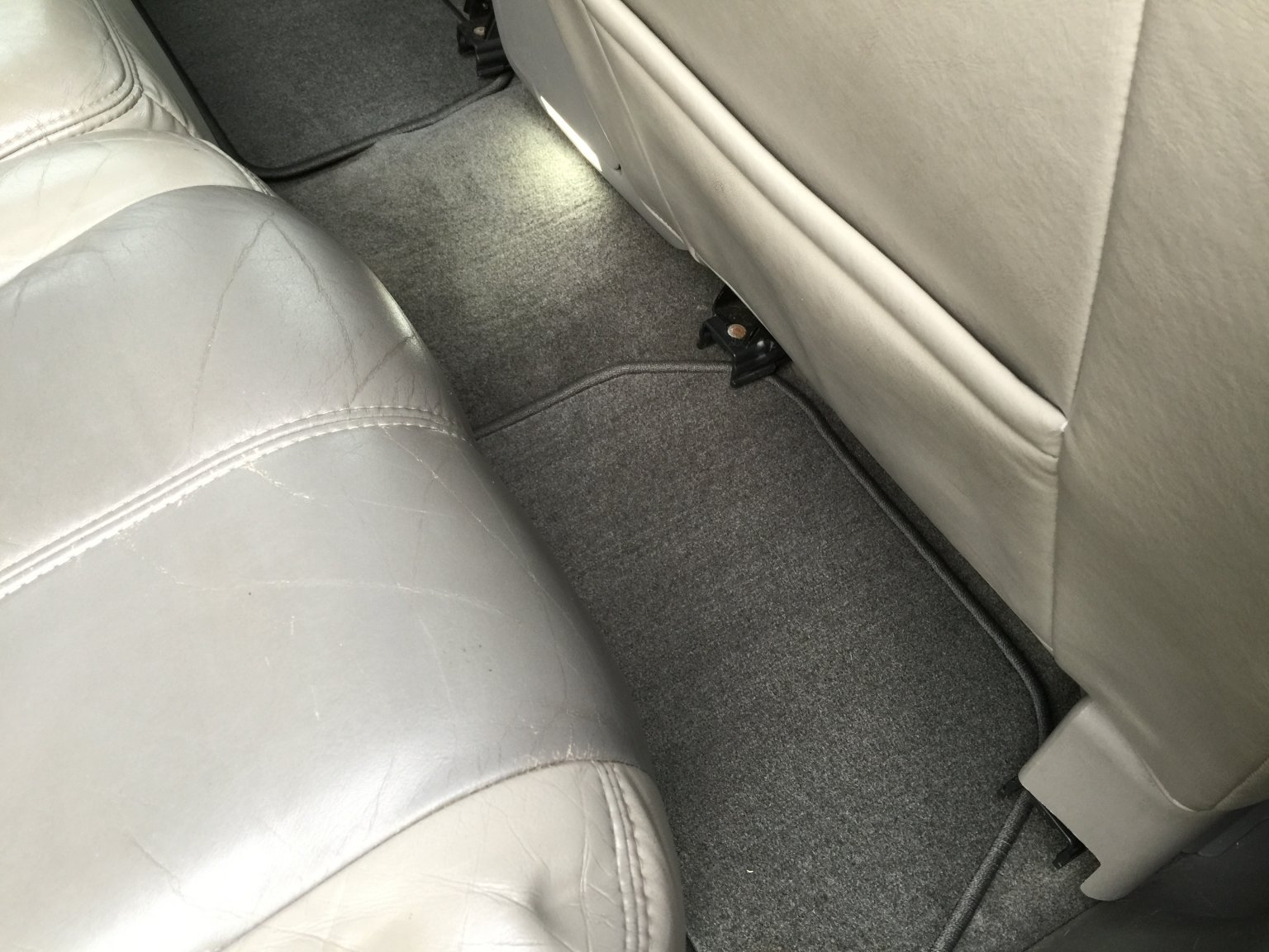

Here's mine. Same color as Fosscore's. IMG_2508.JPG IMG_2511.JPG IMG_2512.JPG IMG_2513.JPG

I noticed looking @ that last pic the bottom of the door panel has carpet in it. The other three Denali xl models and the esky esv that belong to the family that I live with who I spend alot of time with all have carpet on the bottoms of both front door panels. I detail their cars all the time and noticed them. Then I noticed that my 2006 Denali XL doesn't have carpet on The bottoms of front door panels. Anyone else's 2006 model like that? Lol.
52,954
Mine originally had the thin stuff that's on the back of the 2nd row seats and sides of the console. I ordered some extra from stock interiors.com and replaced that on the doors. It had foam backing and was hard to peel but worth it. I think it would be easier if it didn't have any to start with. I just used spray glue.
