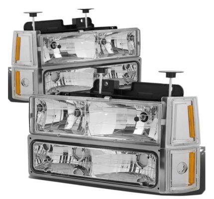

I have a 2 Door 1999 Tahoe. I bought a set of Aftermarket Headlights and Parking Lights for it. They are DNA Motoring brand. The model number for them is HL-OH-8P-C10-3G-CH-AM. I also bought a set of Auxito 9005 & 9006 LED bulbs. To say they suck is an understatement. The lighting, especially on bright, is absolutely HORRIBLE! The low beams were bright and looked good, but only shined about a few feet out. The high beams looked like you were shining them through tree branches, or like the headlights had a net over them. It looked horrible. Standing in front of them, they looked normal. However, they were anything but.

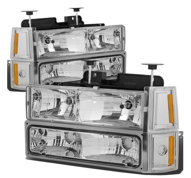

its going to look like that farther out on the light diffusion pattern i dont have any pics or videos anymore to show you but when adjusted properly on those style housing you would see that on the outer edges of the beam.
this should be how they look installed if they dont look like this they are indeed backwards. these are the anzo housings and they are the darker setup than your chrome ones but those dna ones definitely look like knock off anzos. i dont have any light output images left to show you but they are amazing. but i could see what your describing on the outer edges of the beam. was always assuming it was due to the deflector steps. most of your reflectors aim the light forward but the stepping they use to get the proper angle leaves ridges which the light can also reflect off and it causes it.

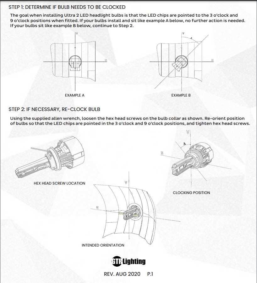

LED headlights need to be properly adjusted for the beam pattern to be optimal. Hopefully, the set you bought are adjustable (cheap ones may not be).
The actual adjustment mechanism is different for different brands/models, but the instructions supplied with the LEDs (or an installation guide on their product web site) should guide you through the process.
Bottom line, the popsicle stick in the LED headlight holding the LED chips needs to be as close to vertical as possible, after installed and locked into place in the headlight housing, with the LED chips pointing to the 3 o'clock and 9 o'clock positions. The photo of the guide below, while not for your specific brand/model, will give you a visual sense of how these LED headlights need to be positioned in a correct alignment within the headlight housing.
i had that issue in my accord but as he suggested he had the sam issue when he swapped regular halogens back in i dont think thats the issue

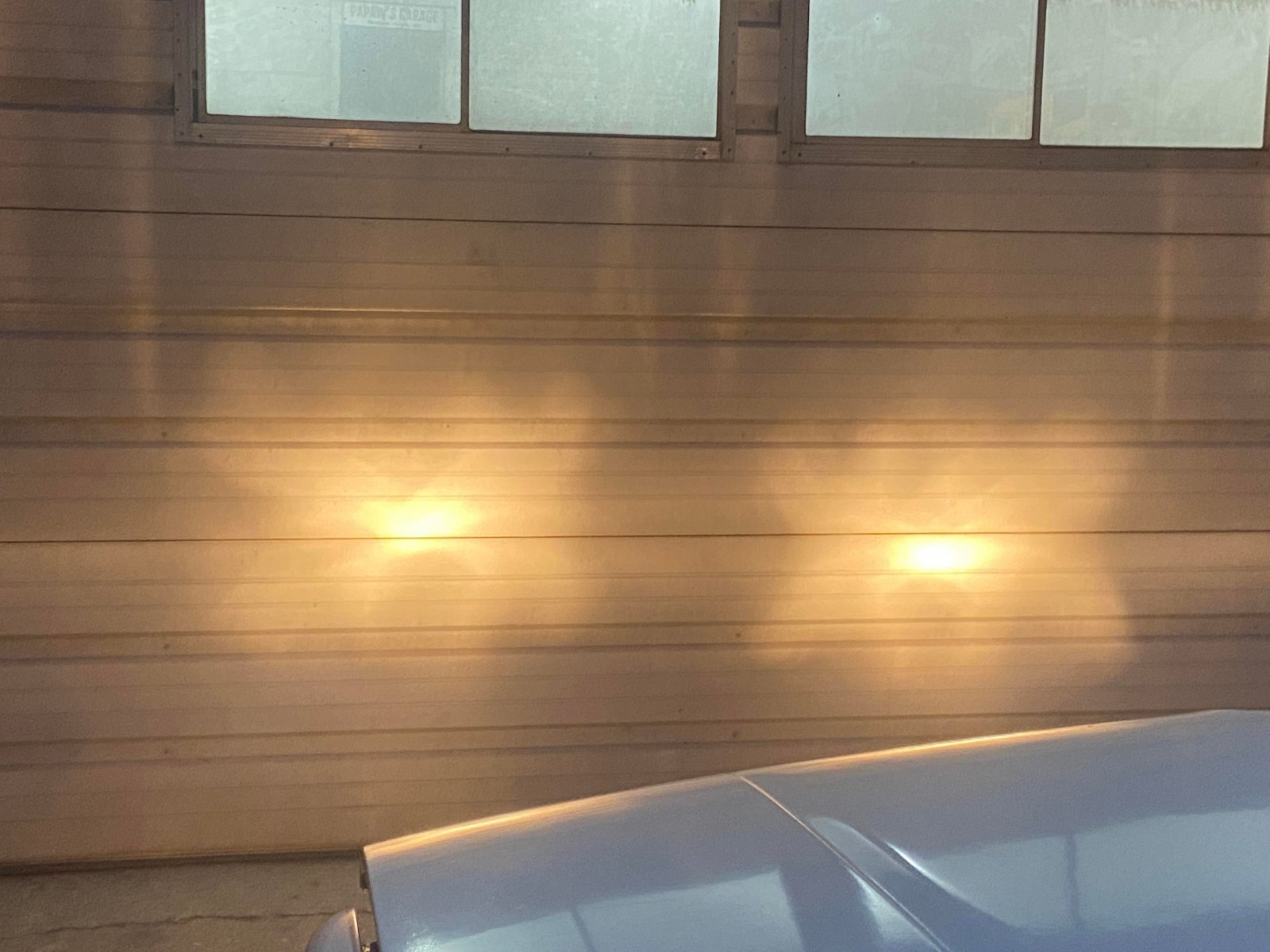

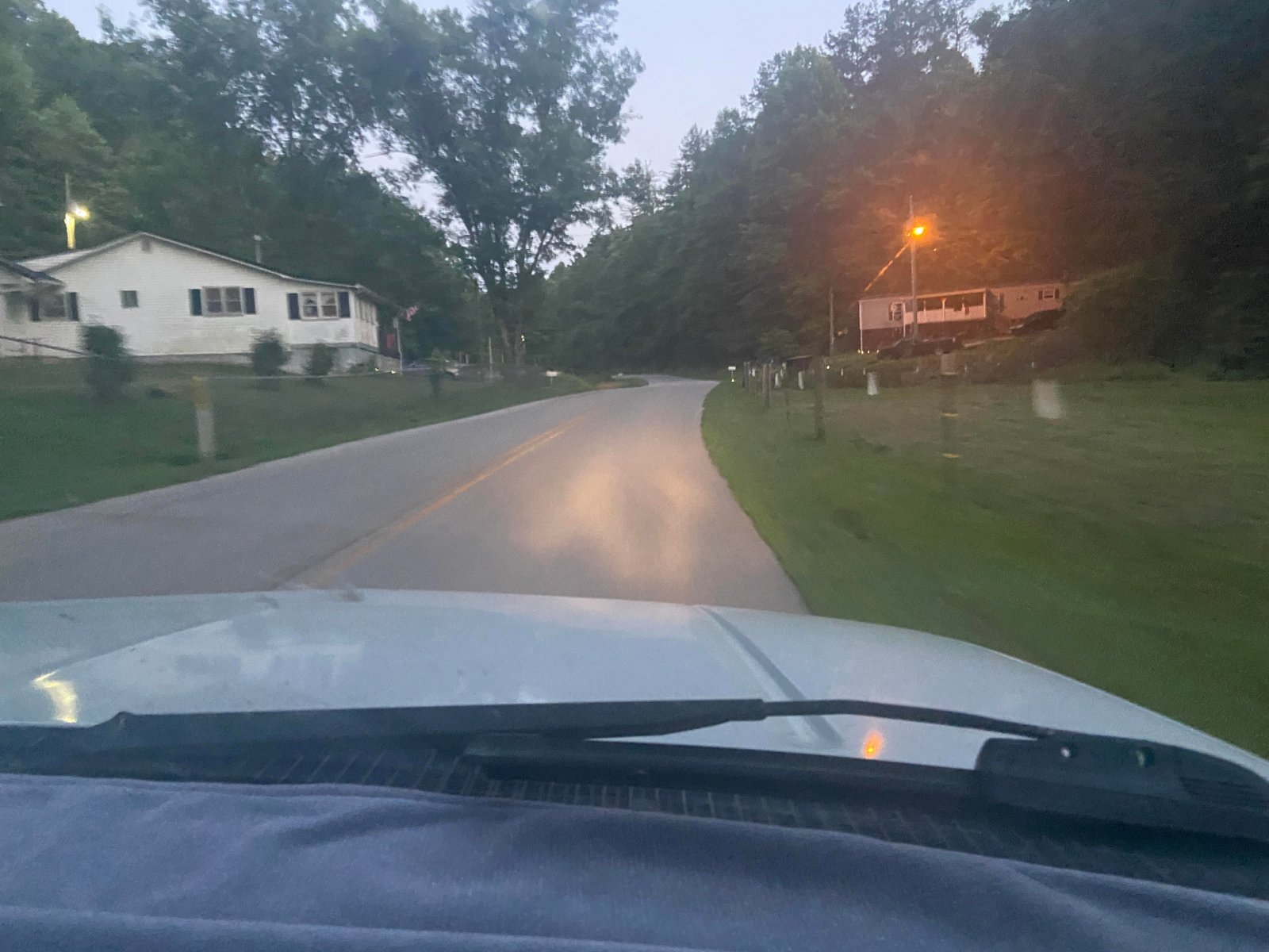

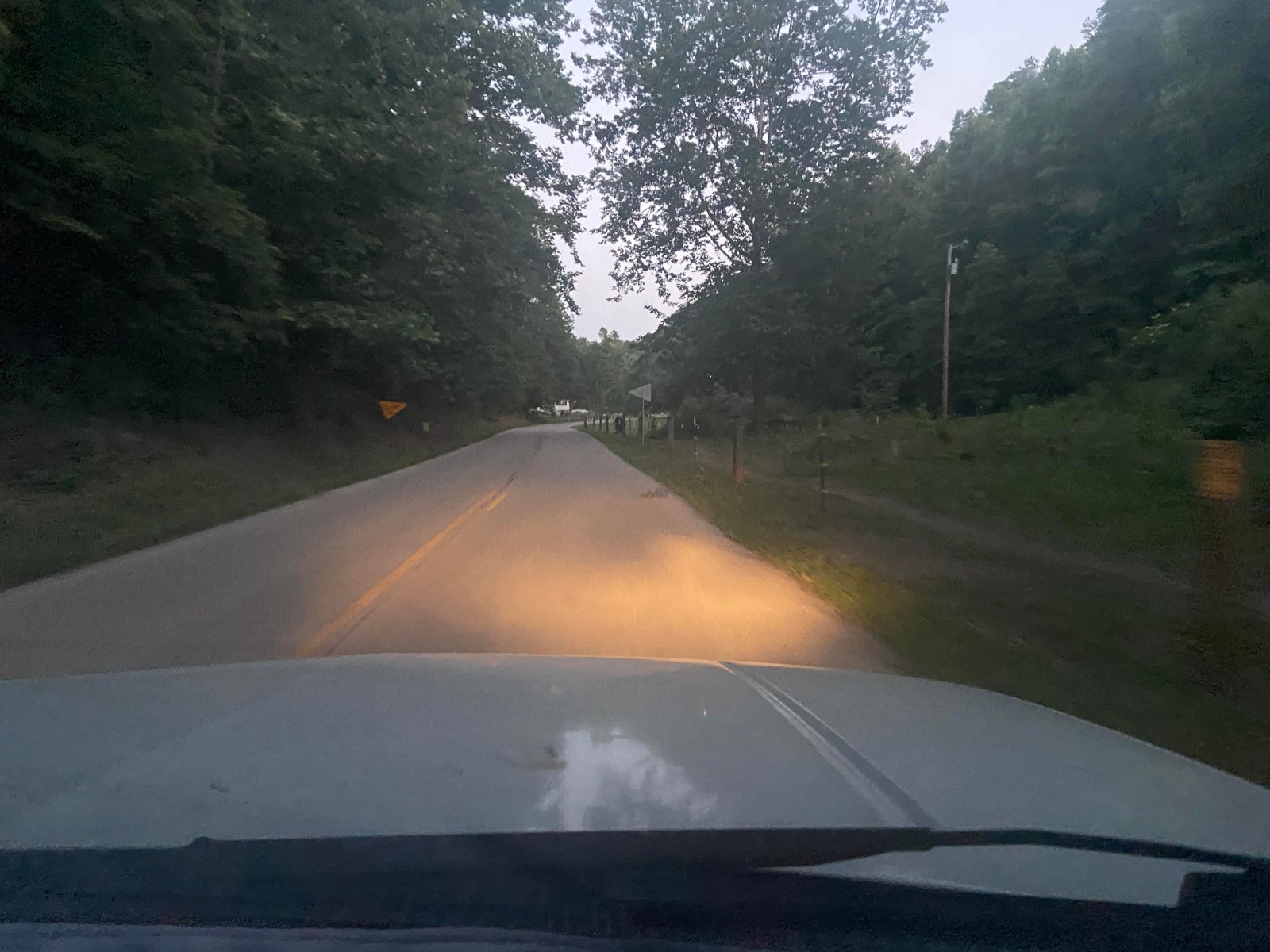

Here are pictures of the beams. The first picture is of the low beams. The second picture is of the high beams and the last picture is of the high beams projected onto a garage door. Notice how ’spaced’ the lighting is in the second picture and the ‘starry’ shape in the last picture.
My uncle is a mechanic and he said that he believes the pattern is ’scattered’ because of the way the housing is made. It is mirrored, but has small lines in the shapes of squares. Also, the headlights cannot be adjusted. You can turn the adjusters, but nothing happens.

Definitely out of adjustment, but even if they were correctly adjusted the output isn't great. Return these and try different brand. drakon seems to like the anzos. The reviews I seen on your current ones had lots of fogging and leaking issues.
