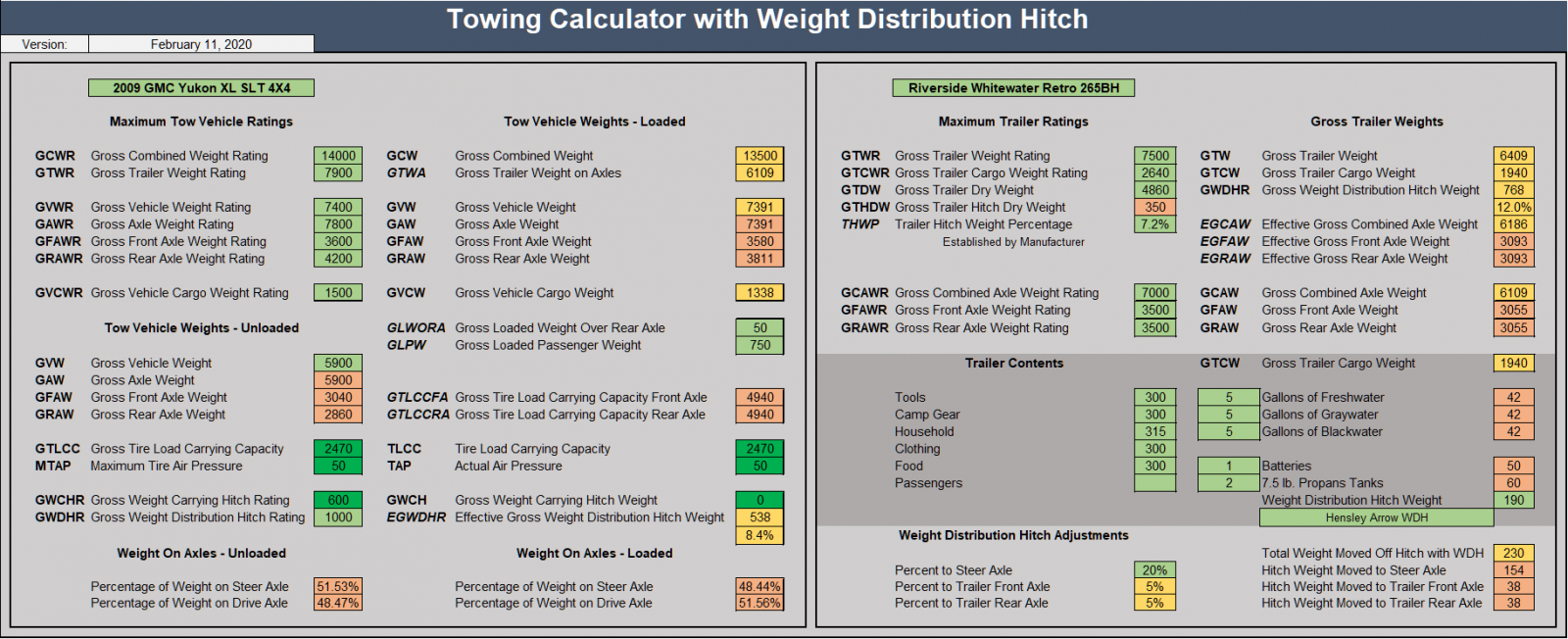

If you are handy with Excel, I have created a spreadsheet to figure all this stuff out. I'll warn you though, a lot of fellas on here have asked for it and none have given me any feedback! It's either awful or awfully complicated! LOL
Thank you. I will take a look at the Excel. What sway bars with weight distribution would you recommend outside of ProRide is it is close to 3k. We're might be only holding this camper for a year so therefore I don't want to spend 3k on something and will become useless in 12 months. I see there are option is $200-700 range, but which is better. I also already have a ball hitch so I guess I will need to return it if I order a new sway bars as it seems that they come in a ball hitch.
