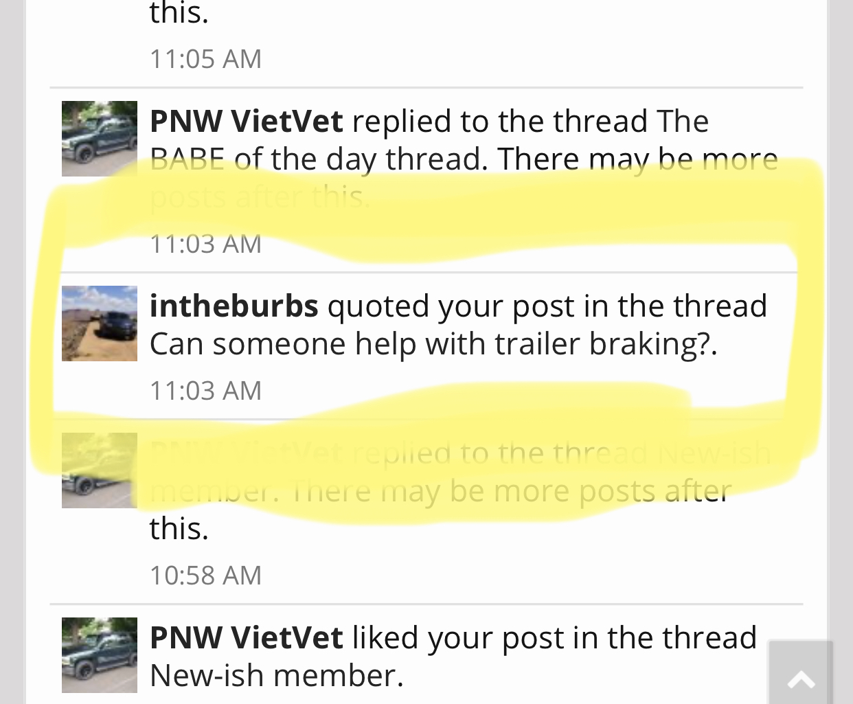

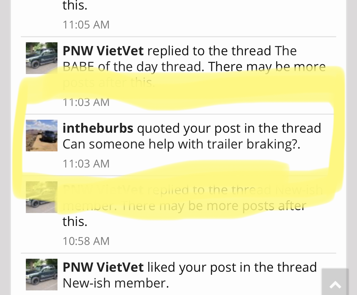

@intheburbs
It’s weird, my alerts say you quoted my post in this thread yet I have no posts.... in this thread.... lol

I did, inadvertently. I guess the website still had one of your replies from a previous session and another thread (that I either did quote, or thought about quoting and had clicked quote) in the cache, so when I added the quote of the OP, it added yours, too, and I only realized after posting, so then I deleted it.
Gotcha

Damn tech no logy
