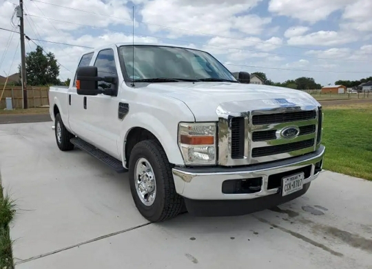

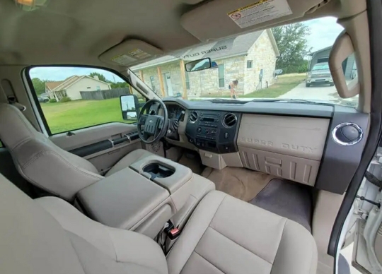

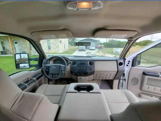

Thanks everyone for your input, public and via DM. Picked up 2008 F250 5.4L gas owned by elderly couple who recently passed away and their son sold it to me. I hope it was a good purchase. Clean in and out for its year. 123k miles for 10k. Well maintenanced as well.

At least I believe they fixed the sparkplug issues by that year. Should be a good runner.

I checked and seems that sparkplug issue is still there, but Does issued a bulletin on how to mitigate potential sparkplug damage once removing.

We have the 2008 Explorer with a 4.6L. I believe it's the same base engine. It's been pretty good. Synthetic oil is more important on these because of the cam phasers.

My mechanic told me the exact opposite. I had a 4.0 V6 explorer and he thats the one you want. Which made no sense to me because I had a crown vic with the 4.6.... But he did have a sport track with the v8 that needed a new motor in his lot so I guess there's that.

That suuuuucks.. Damn those 5.4s. My buddy talked me out of doing plugs on his expedition with a 5.4...i can't say I didn't call him a little ***** a few times until i started seeing the truth of those spark plugs..... Shudder.

Ford's 4.0, from what I hear, is great until you have to do tensioners. Then you pretty much have to remove the engine because one chain fits under the rear cover. The 4.6 has everything up front. I, too, had a 1992 Grand Marquis for 22 years. I only sold it because I bought my Trailmanor and needed the space. That 4.6 was truly bullet proof. The only weak points of the newer ones are the tensioners and phasers, not overwhelming to do. I thing your going to like your F250. That doesn't work for us because we need the 3rd row sometimes, and we like to have our camping stuff easily accessible from inside. Too bad they don't make a 3/4 ton Tahoe.
