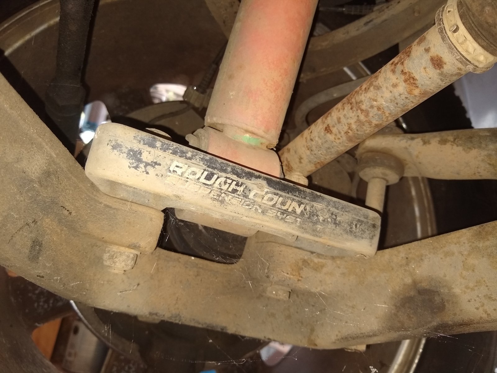

Can some one tell me what I'm looking at?
Lsnoob13
Jun 18, 2018
90
17
I have a 08 Yukon denali, I've been spending a bit of time under it and I noticed these....is it a leveling kit? It's on the front shocks. As far as I know the truck suspension is stock.... until now at least.

What ^^^he said. They look to be about 1" thick, which would make them a 2" lift- common for leveling as there's usually about a 2" rake on these rigs. While you're under there discovering things, see if the rear coils have any spacers under them.

Yeah I thought it didn't look stock, had to wipe it to see the logo. The rear springs are sitting on the axle so no spacer there. Can these be removed and leave the longer bolts? I've noticed this truck squats a bit and maybe this is what's causing it?

The squat is likely because the 2" front lift was more than what was needed to level it. If you like the front height but don't like the squat (Which I strongly agree with!), you can add a spacer to the rear coils. 1" is standard and common, but I believe there are 1/2" and 3/4" if you're that particular. I had a 2" front/1" rear lift on mine for about a year. I liked the stance, but recently removed it in preparation for lowering.
If you just wanna put the front back to stock, you may need to get shorter bolts because the longer ones will likely have shoulders (no thread for a length under the head). I'd advise against using less than Grade 10.9 with these bolts and nuts.

I'm just gana take them off, I'd like to lower it in the future so stock for me is just fine....for now lol. I've noticed the rear bags are dry rotted and that the auto leveling doesn't kick on, is it hard to remove them and lower the truck and it ride fine? I've heard these trucks are picky with removing that system and lowering.

Typical death of the Auto-Leveling system. Regular (passive) shocks bolt directly in their place. Just get good shocks and it'll ride fine. The only issue you may have is a "Service Suspension System" warning message on the gauge cluster. This is easily resolved by connecting some resistors to the wiring or plugs that originally went to the shocks so the computer thinks the shocks are still present. The resistors are about $10-$15 for a pack of four.

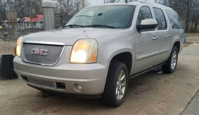

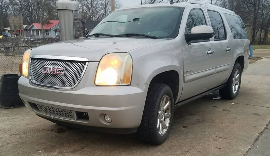

This one is mine, I couldn't find a good side profile but you can still see how it seems a little high...at least compared to other ones I've seen.

Yeah, I don't like the 80s-90s idea of lowering a truck by smaller wheels and/or tires. It looks stupid. The PPVs have a lowered suspension and the smaller tire diameter is for performance and handling and it's actually a special tire- definitely not for looks or intentional for the sake of lowering the overall height of the vehicle.
22s are about the biggest you can go while maintaining a reasonable ride quality for most any road condition, assuming the suspension doesn't ride like a wagon. 24s are fine if your roads are adequate. 26s or bigger and you're just asking for trouble.
The wheel size isn't such a concern if you size the tire accordingly. As long as you keep the overall diameter of the tire around 32", rubbing won't be much of an issue, if at all, with a reasonable drop.

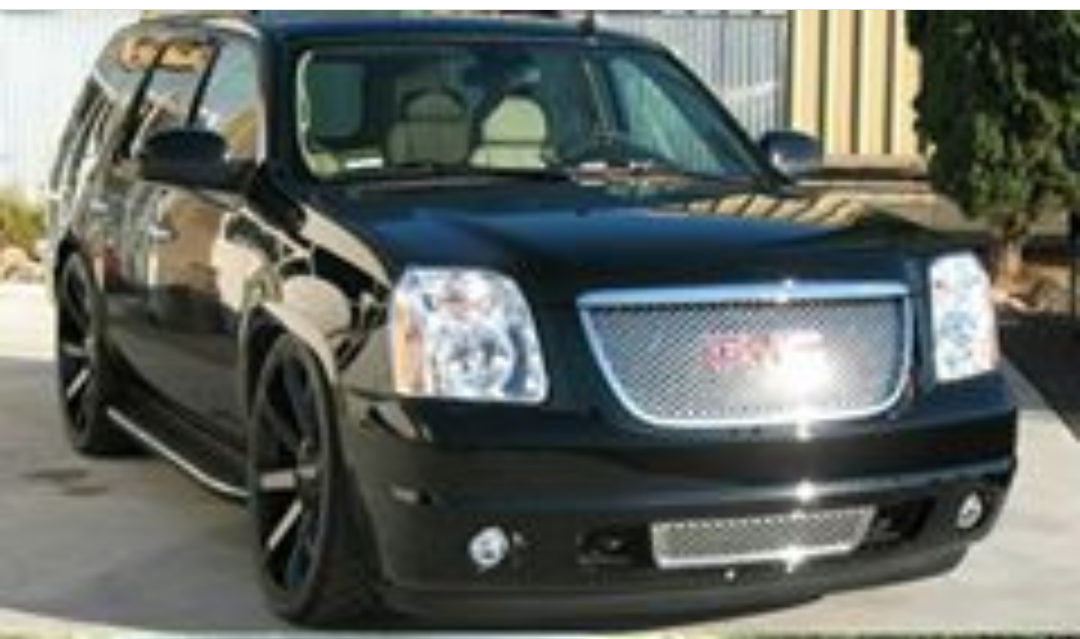

Yeah I feel the same way about that lol, 24's is probably as big as I'll go. Do you think the method you mentioned would bring it low enough to look like the one in the picture of the black truck or do I need to consider a whole different system? I've lowered cars before but these trucks and GM/Chevy is new to me. Especially lowering something this heavy lol I'm used to coilovers and bags I'm sure that those methods are unheard of with these and if they aren't I'm sure they ride like donkey on a dirt road lol. I just like the stance of the black one and that way I can get rid of the auto running boards....lol I don't like them much.

I'd venture to say that black Yukon has a 5/6. Assuming the wheels are 24", the overall diameter looks to be about the same as stock (32"). That one needs an alignment, though. Or it's a crappy Photoshop job.
The cool thing about these rigs is you can slam the front past the point of being drivable without even touching the stock springs. So, technically, they'd ride like stock and retain the stock load capacity. Again- assuming you get quality shocks. For the rear, you HAVE to change the springs to lower it, but the common ones for extreme drops are Trailblazer coils. So, you install coils designed for a lighter vehicle which means they'll compress a lot more to achieve the drop. You regain control of the extra softness of the (technically overloaded) springs with careful shock selection and/or the addition of helper bags. But, as far as the suspension articulation, you're limited by just a few interference points that are fairly easily remedied.
