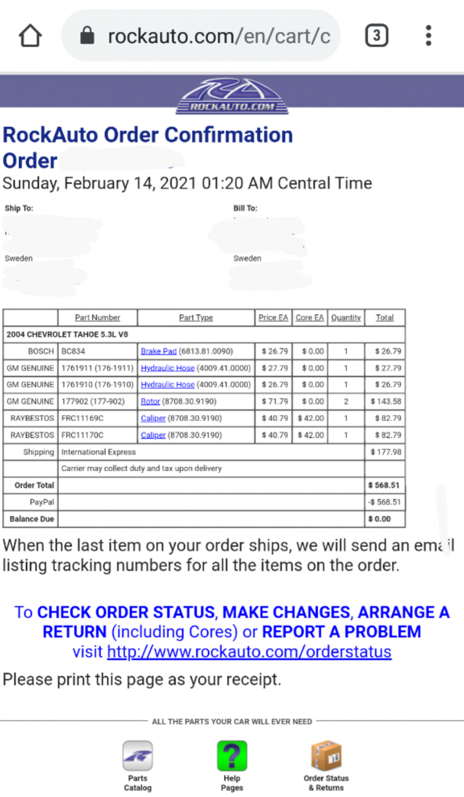

It's always something that's going wrong, did pick the wrong year when I did order, did see it after. Let's hope that I did grab the right stuff anyway.
Now the Customs will need there part 5% and the State 25% VAT even on the shipping within US, they lay 25% on the total. Yes stupid, but Socialism cost blood sweat and tears. ☺
