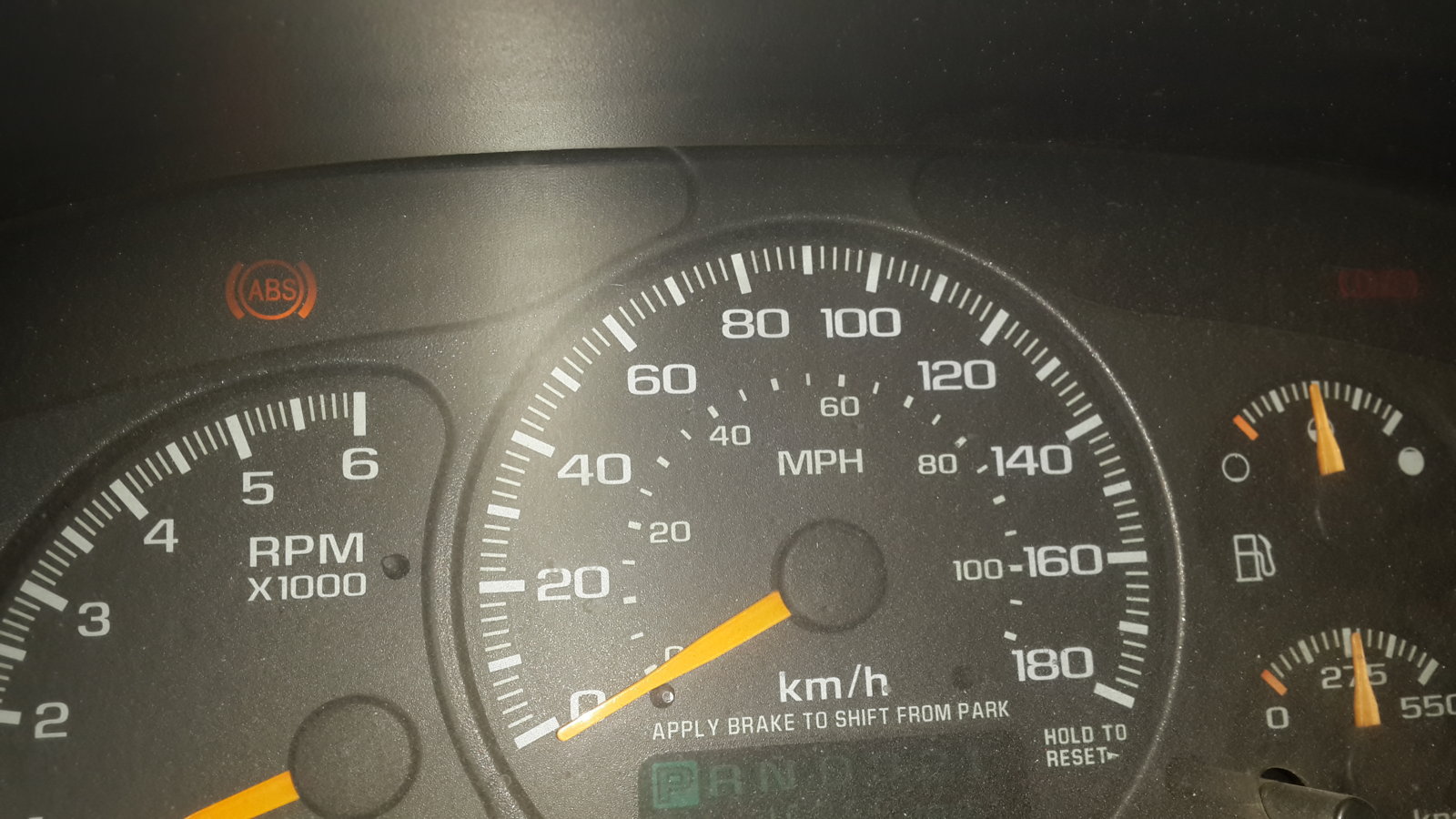

Hi, I am attaching an image of my tachometer, in the revolutions I do not have the redline limiter. How much could I limit it by configuring with the hypertech ???, and the variation of the points of changes of how much I am increasing or decreasing it?
example:
1-2 +/- 100 or +/- 200?
2-3 +/- 200 or +/- 300?
3-4 +/- 100 or +/- 200?
Regards!

I honestly would leave those settings stock on a stock engine
