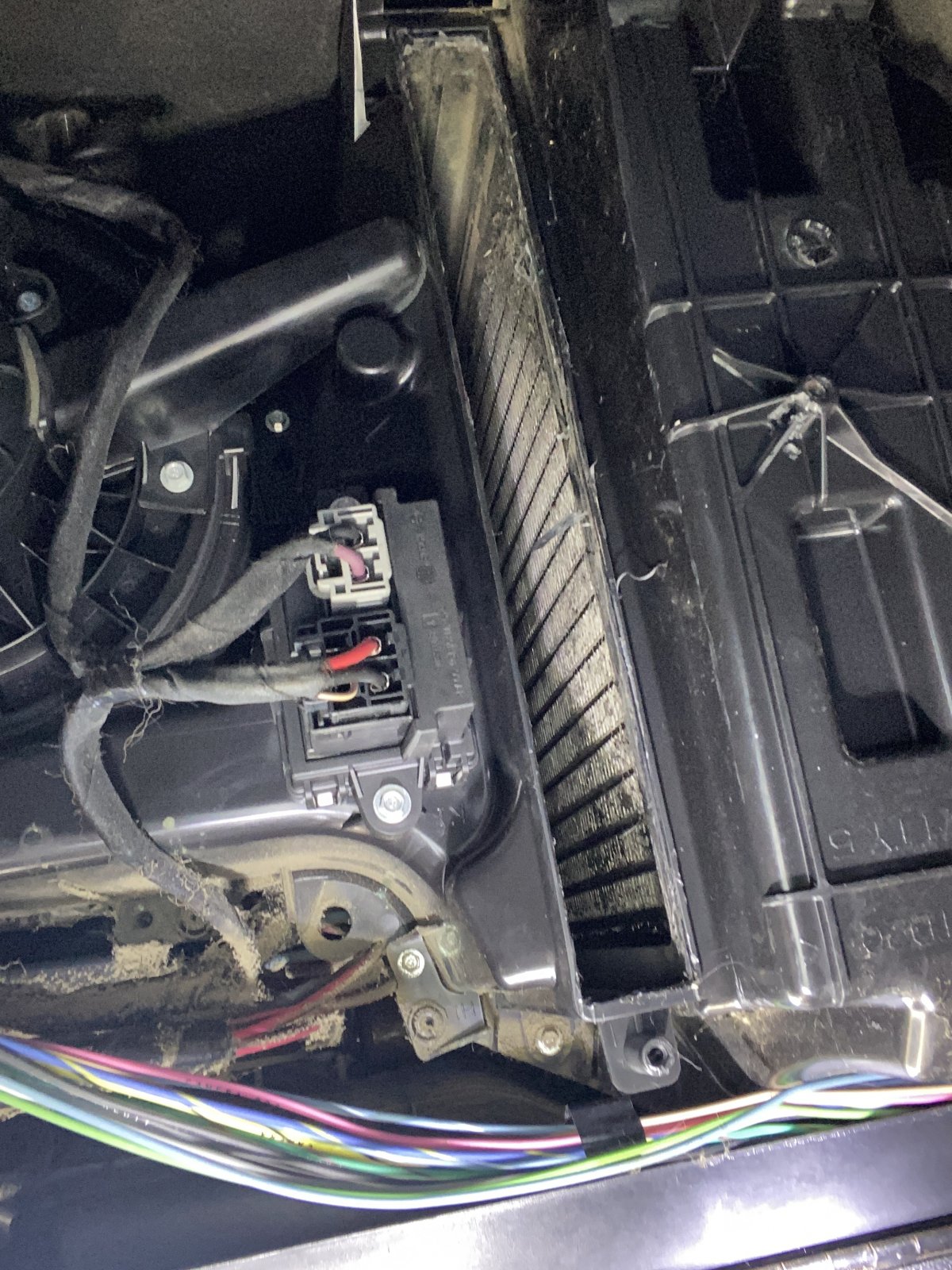

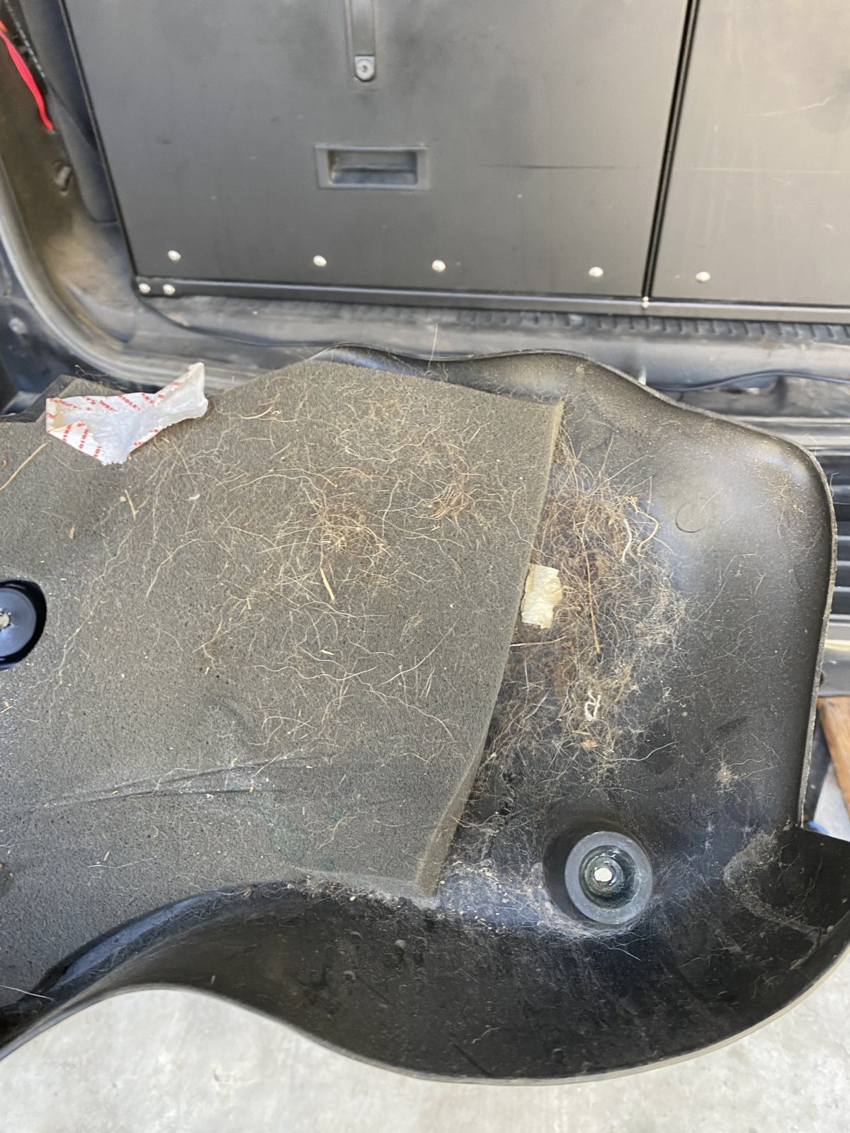

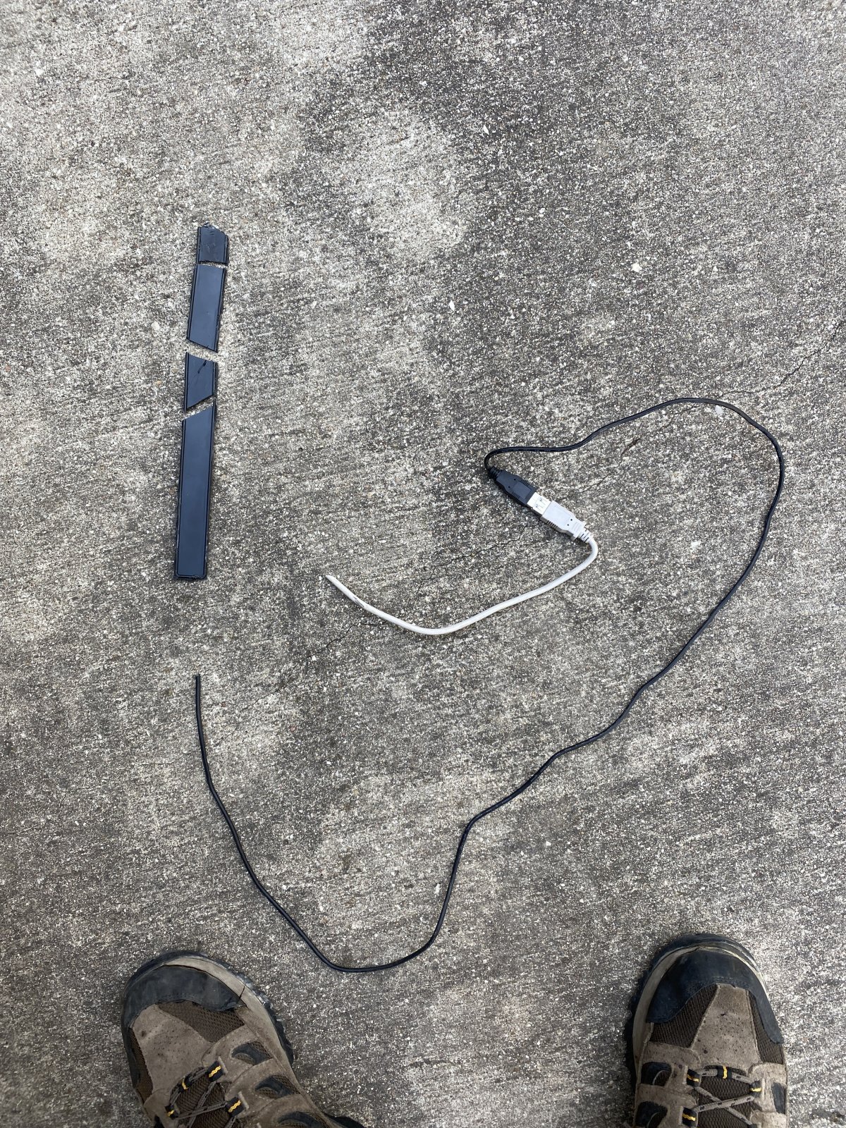

Just finished theothertwin. Just the hair inside the kick panel, and elsewhere since I bought it, I was expecting way more at the coil.
I also found a bonus piece of cable.
702C5DF5-86A8-443A-B962-4803A9F51BBF.jpeg 2E0C50EC-EB6C-44A0-B6A5-DF12E38D0320.jpeg 15B4D6D2-B2C4-4457-833C-08E5BF6DC340.jpeg 1A4DC877-1A9D-43CD-B1ED-9894AA1FE3A0.jpeg 9055C3B8-798F-437F-988E-AC002A1DC913.jpeg

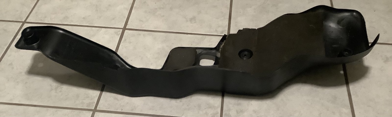

Are those of you that have the cabin filter removing and reinstalling this kick panel / cover every filter change? Or does it go to the extraneous parts bin?

It’s cosmetic mostly but will protect the assembly from passengers with size 12 and up.
I kept mine.
It is not only cosmetic and protective but also helps reduce noise from the blower motor.
You can take the 2 screws out that are easily accessible and drop it down and out of the way to change the filter without having to mess with the third screw behind the console... just FYI.
