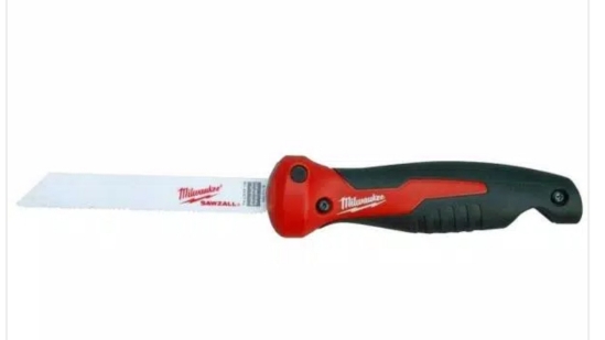

I drilled a hole, then used a mini hand saw to make the cuts. Kinda like this one
