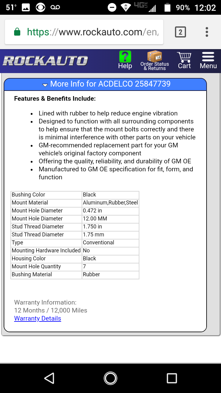

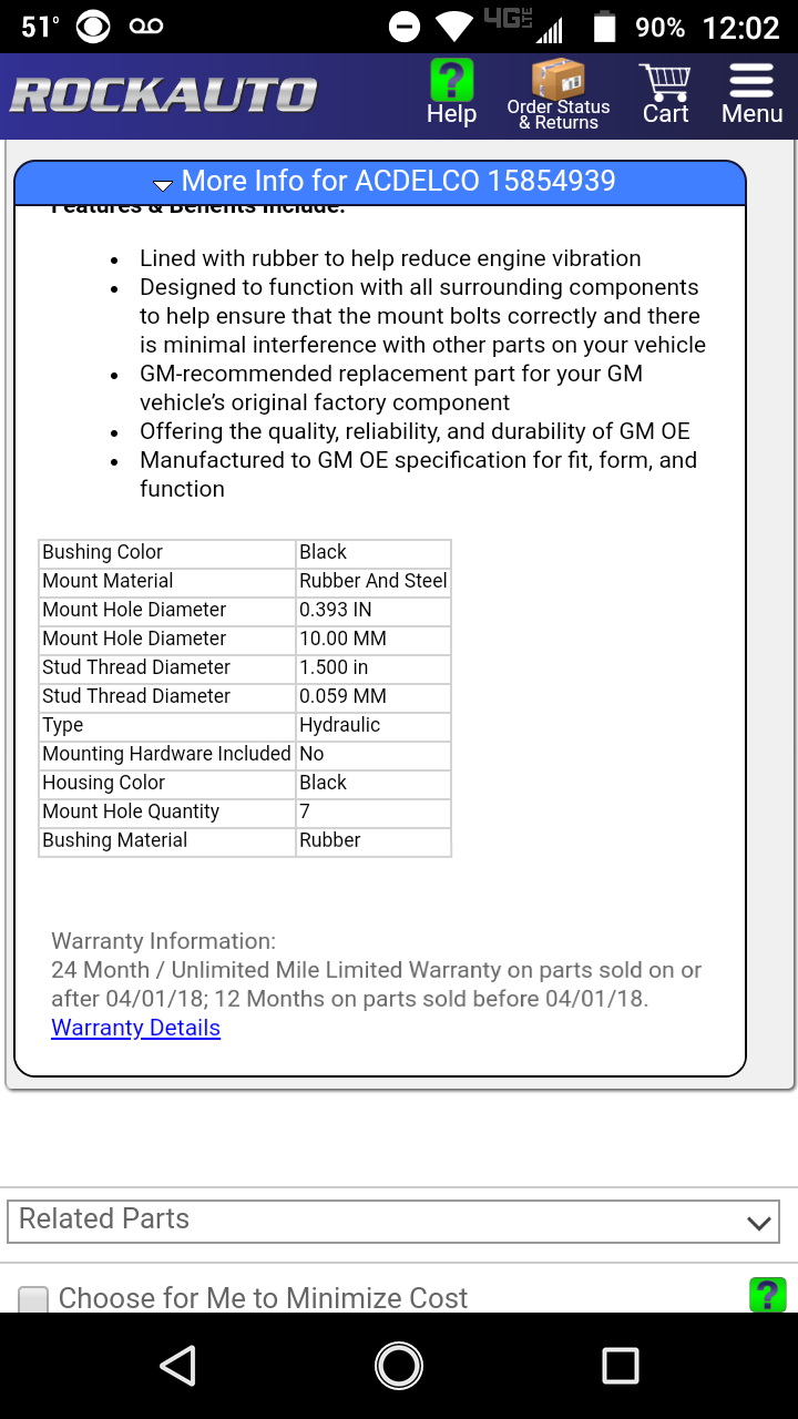

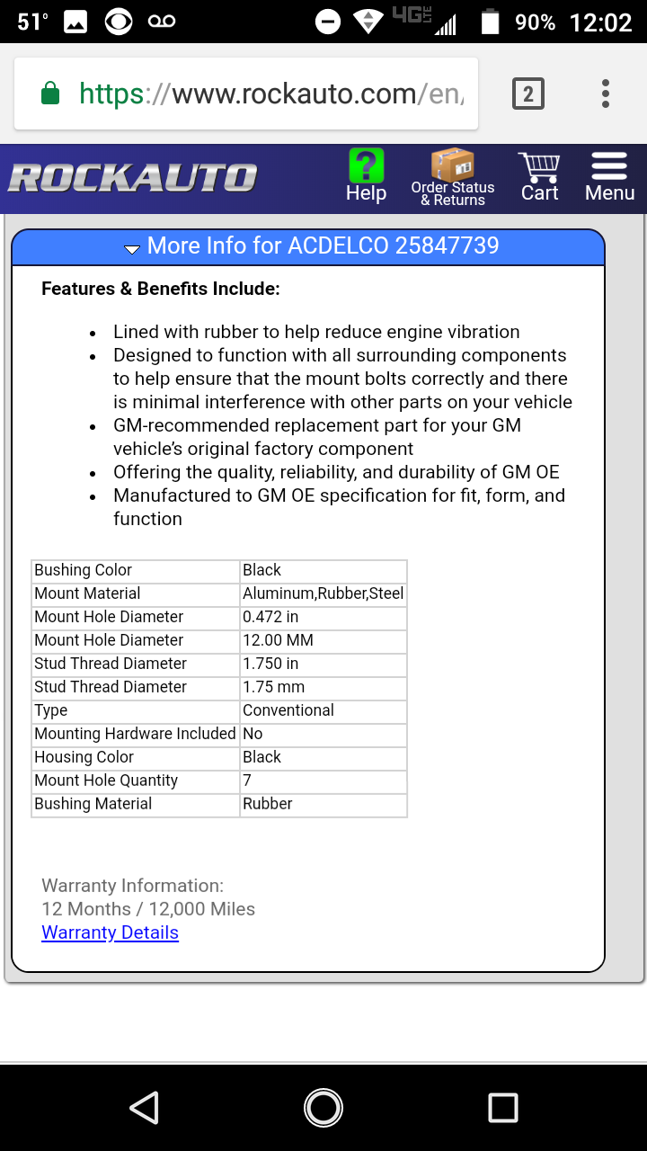

Here are the specs from both part #'s first one is what we all have been dealing with second one is the H3 specs.
NGAneer
Jan 21, 2014
1,785
1,023
NWGA
Those specs don't make sense. The top one says stud thread diameter is 1.5"/ .059 mm and the bottom one says 1.75"/ 1.75 mm. Something doesn't add up.
Agreed, but I don't recall a "stud" on the mount other than the frame locator. Someone's done this any said it worked, right? I remember seeing that it was good to go.
52,954
Yes it's been verified to work on both sides, SUV's and pickups. Quite a few guys have installed it.

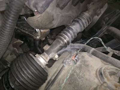

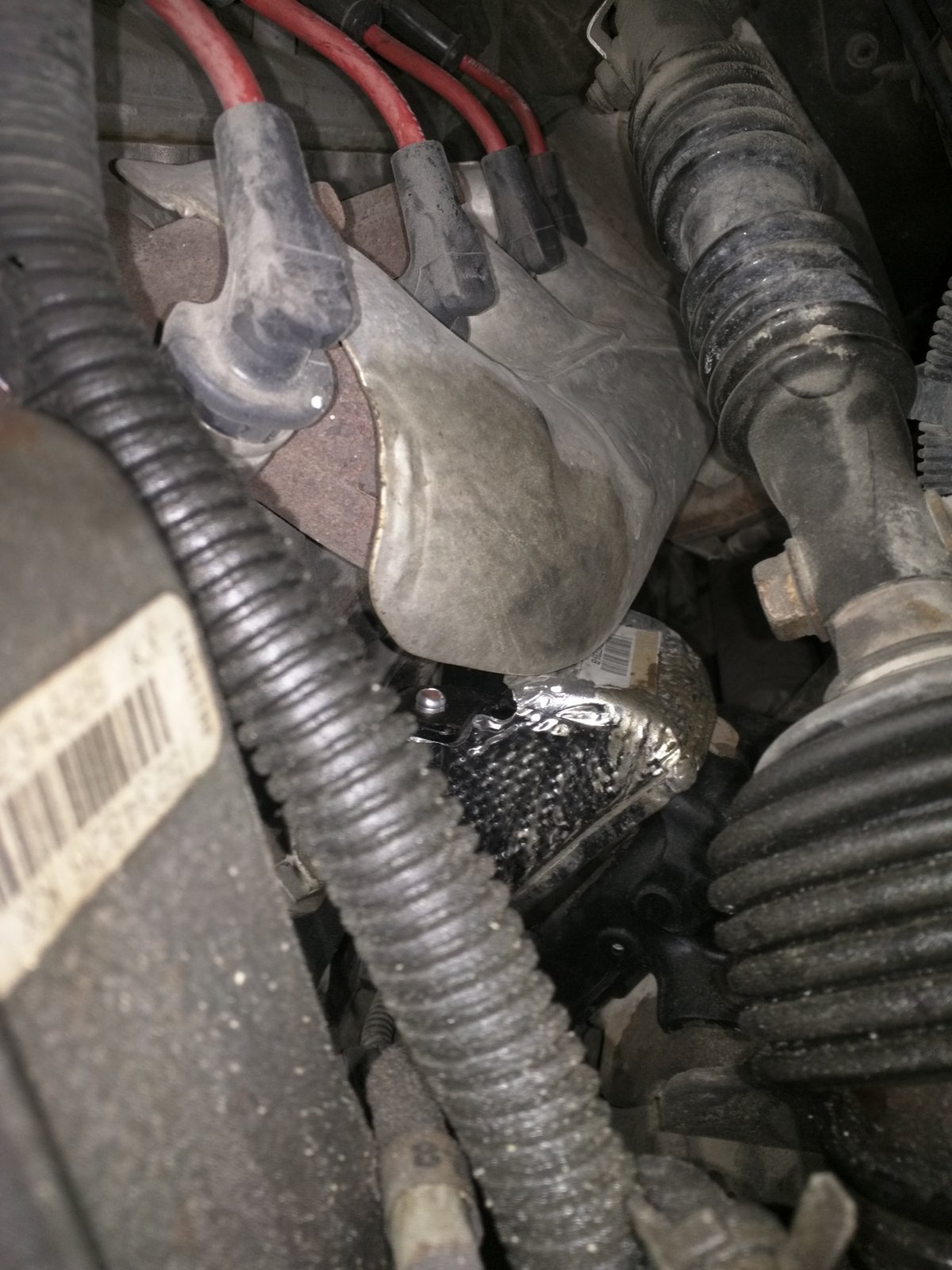

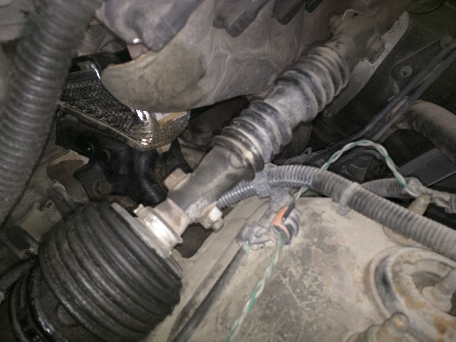

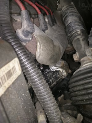

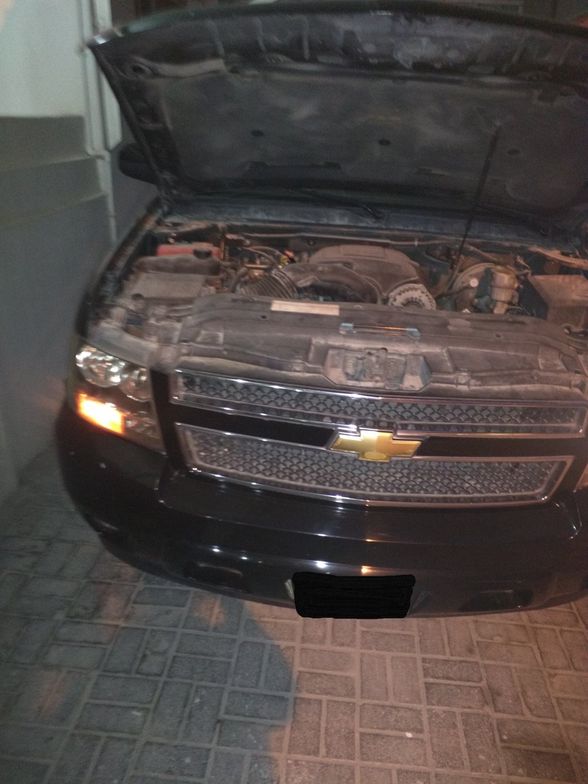

Long time lurker, well not too long but ....
Anyway, in case anyone is still wondering if the hummer's fit on NNBS tahoe, 2007 4wd, they do and ill upload the pics in a day or two
Posted this to be another one who verifies and will confirm with engine bay pics
Not sure how the truck ride's now as its still with the mechanic for tune-ups and stuff, but im excited that I've got those new mounts
Thanks everybody who shared their knowledge and also @windog for shedding light on the part number
My sincere apologies for taking a long time to update, i hope those may clarify any doubts, engine is a 5.3, nnbs, 2007 tahoe (2007+) replaced both sides with same part number but unable to get a clear picture for passenger side
