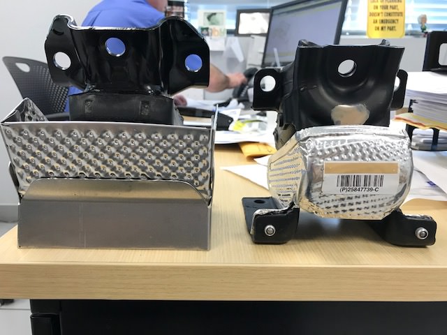

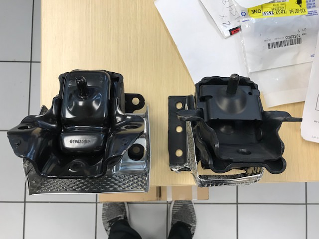

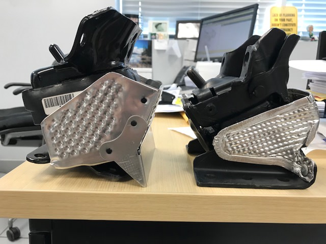

Actually I don't doubt it since the application guide says it's just for the Hummer. It might fit but I don't think GM has updated the application.
So he kinda found today where it's used to fit the PPV's so we ordered one to compare it to our OEM mount. So I'll know tomorrow for sure

Another thread on here talks about a TSB to use the same part number from the passenger side of the H3. Part number 25847739. A review on Amazon states it worked well on an 07 Tahoe. The description on rockauto describes it as a conventional mount where as the yukon mount for mine is described as hydraulic (obviously). Just another reason to believe this would work.
Spot on. 100% will work. You will feel the engine more because it's just a rubber mount, but is a LOT less likely to go out.
Left side our OEM, ride side H3 (25847739)
45,011
I'd rather feel the engine running than feel it jump and knock when torqued! You'd only feel it at idle, anyway. Thanks for posting the confirmation pics.
