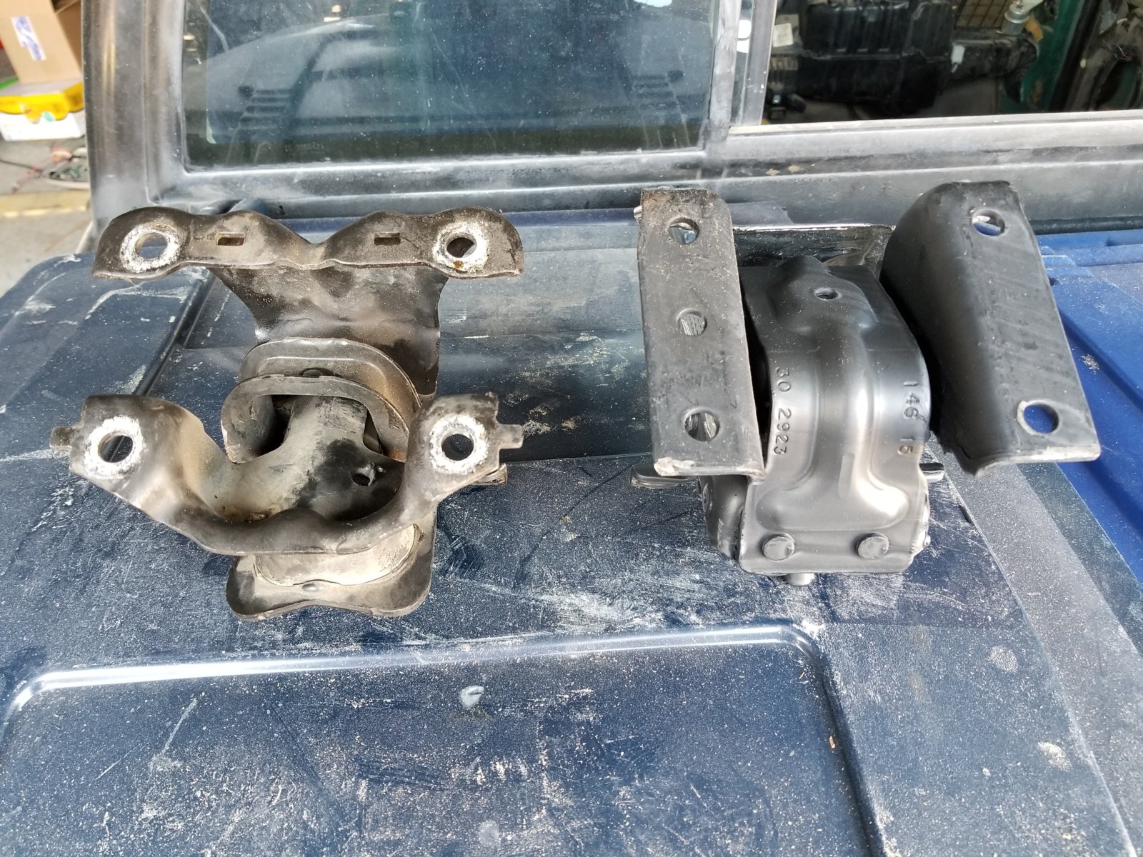

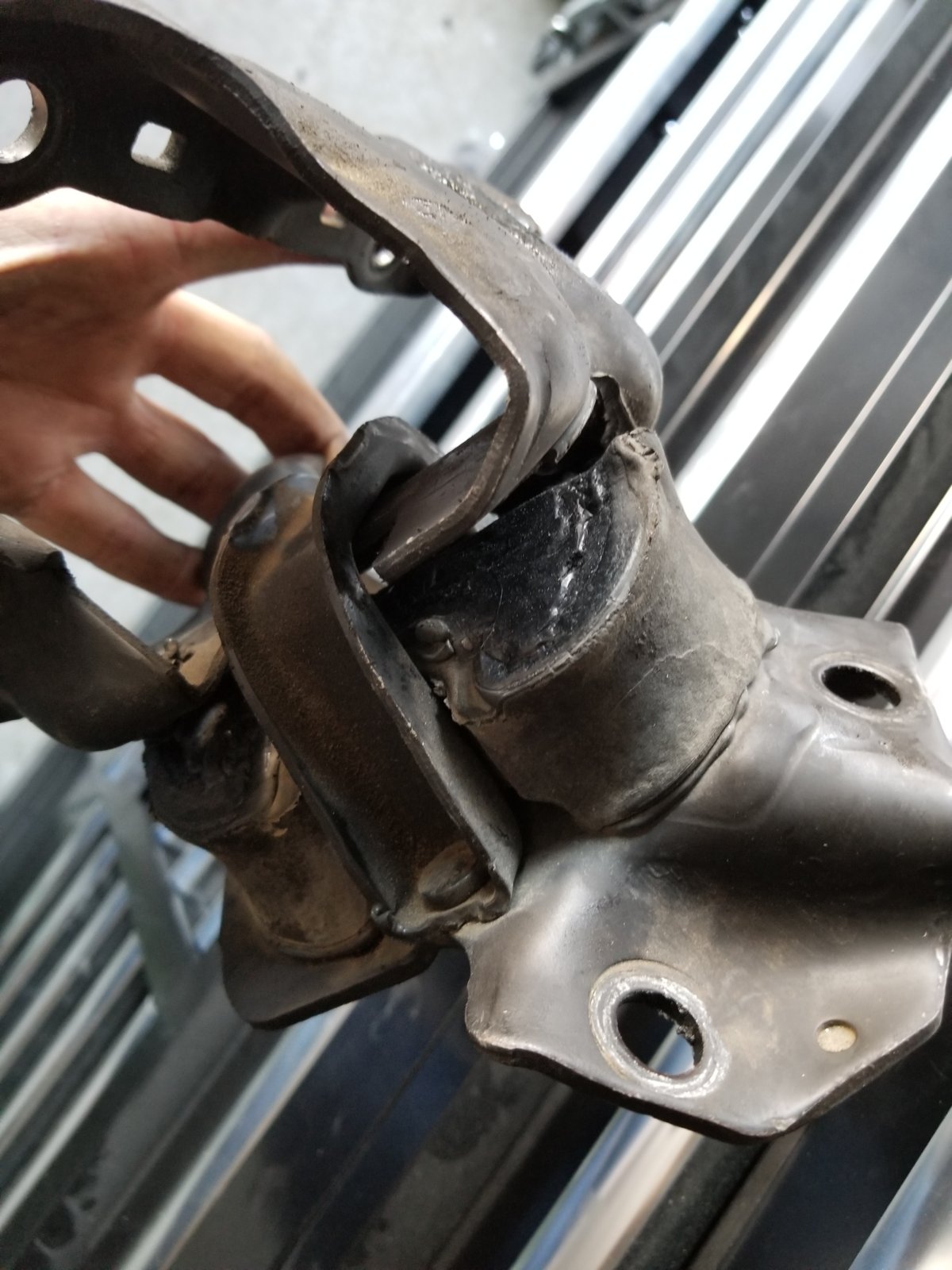

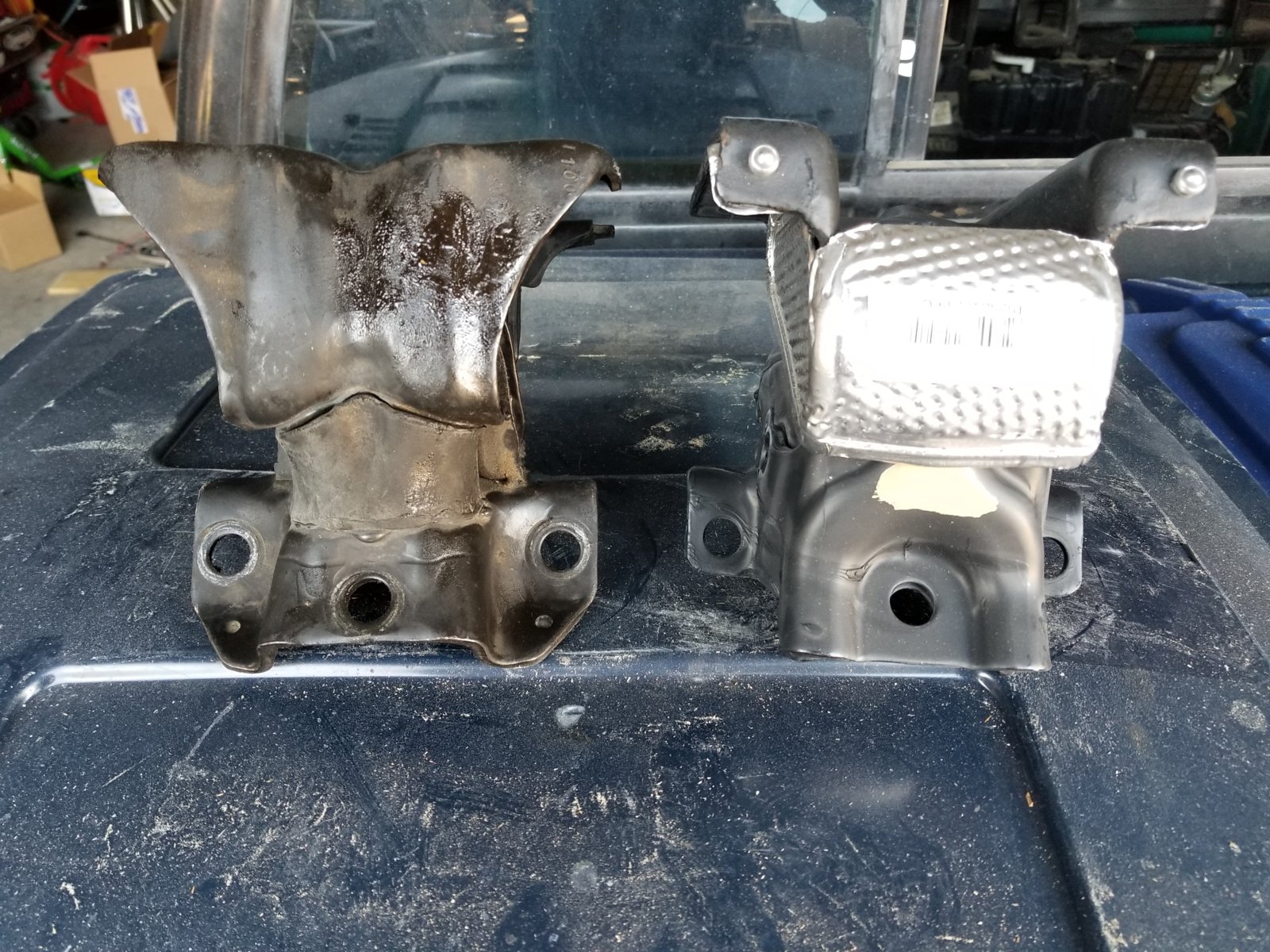

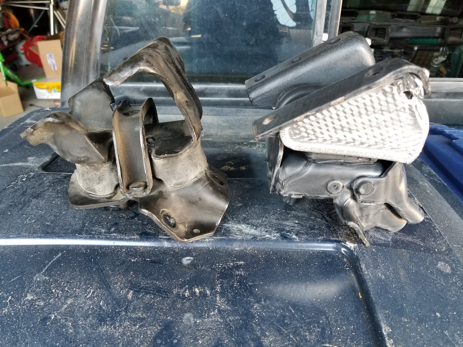

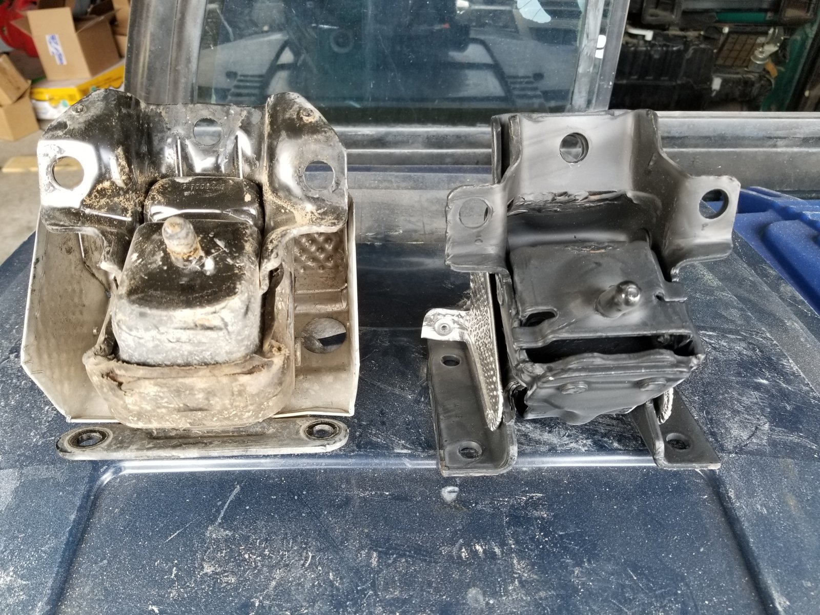

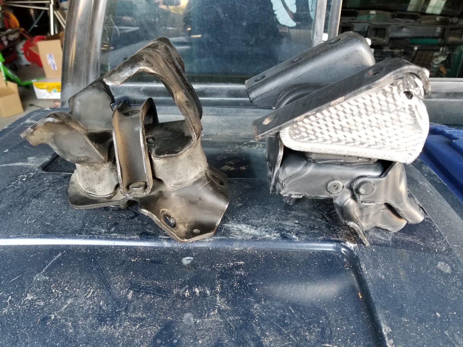

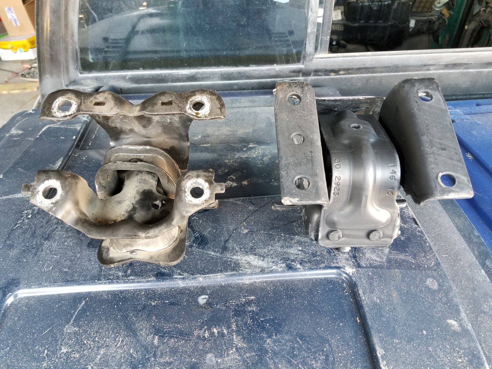

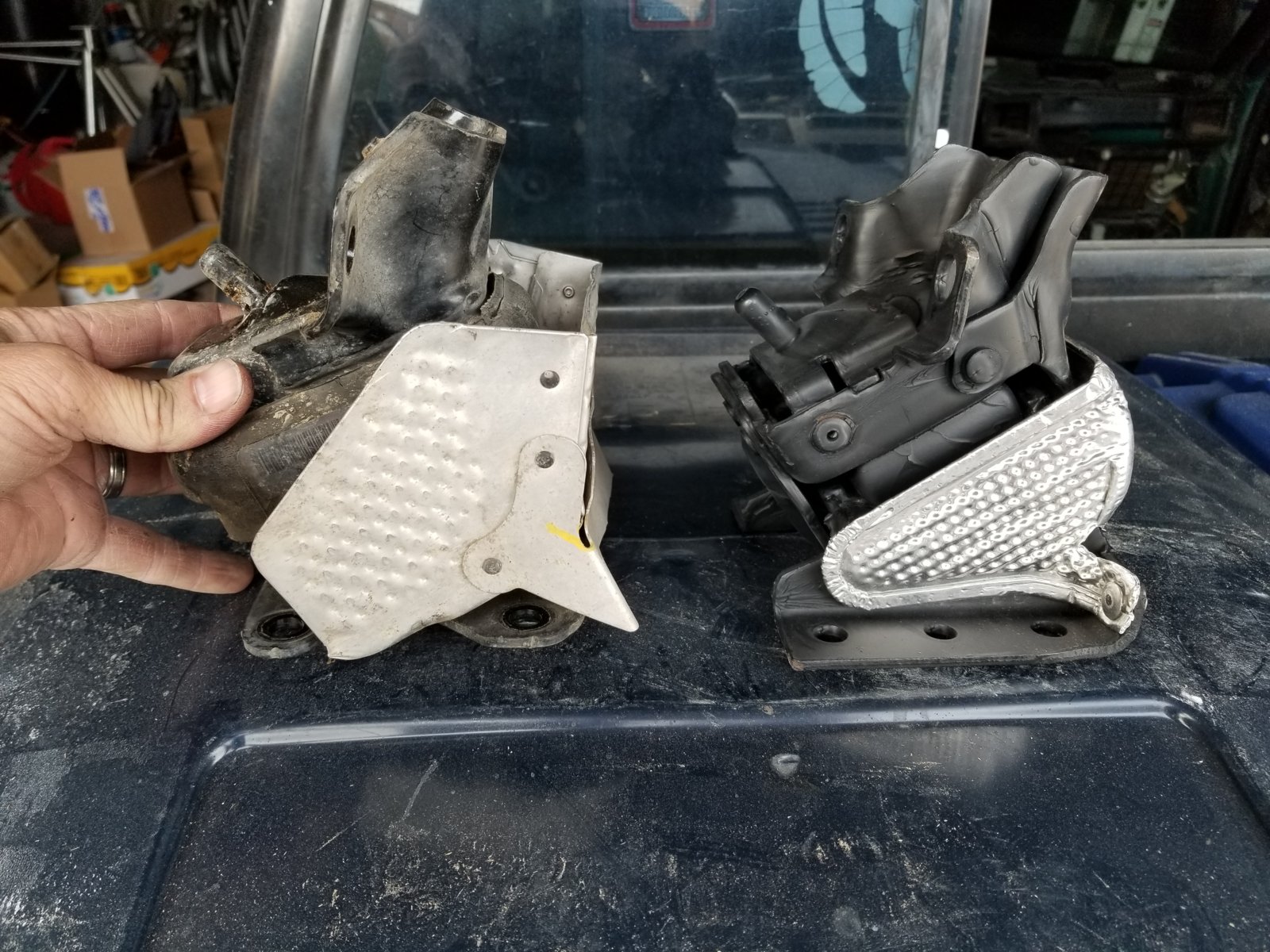

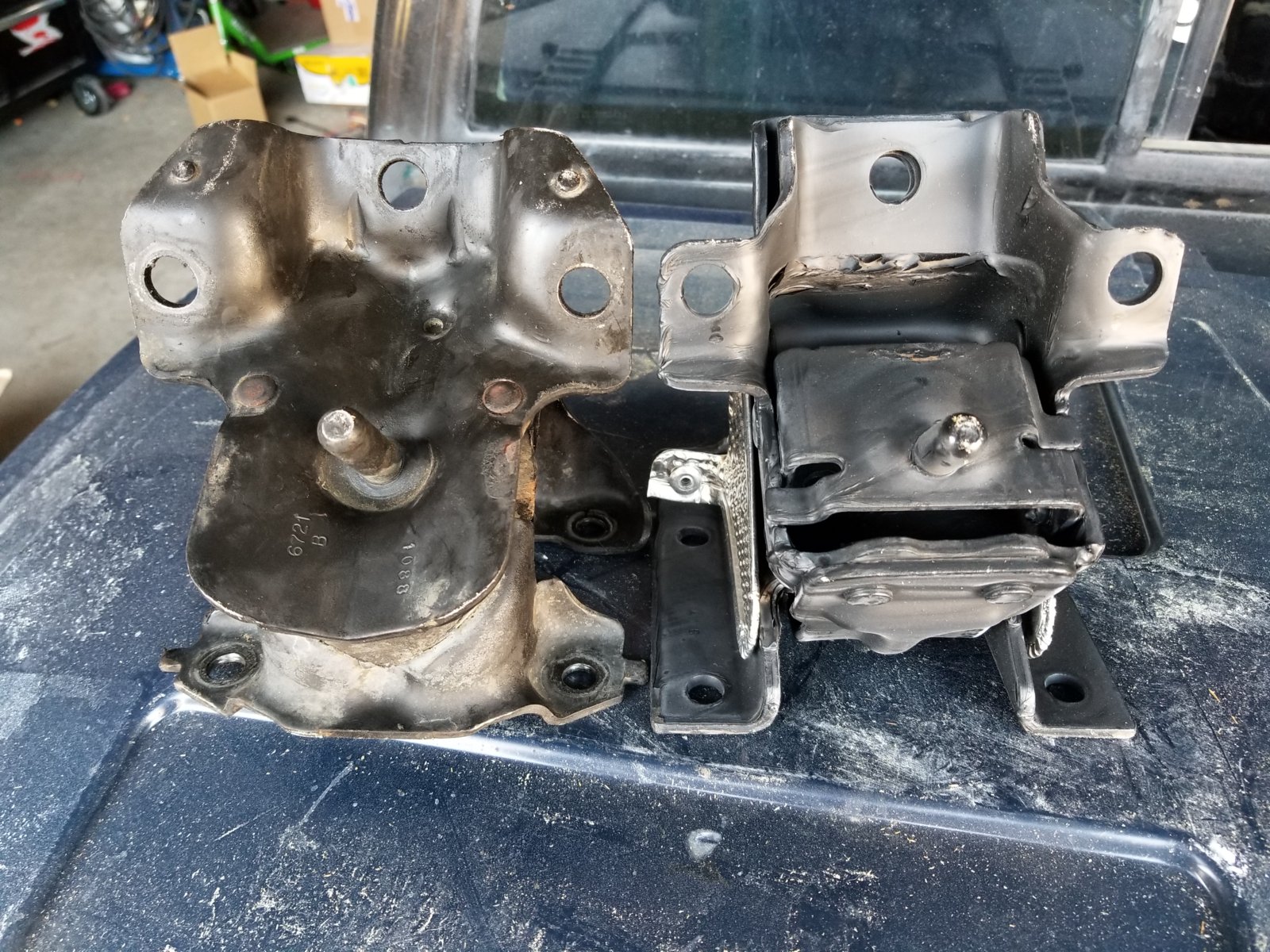

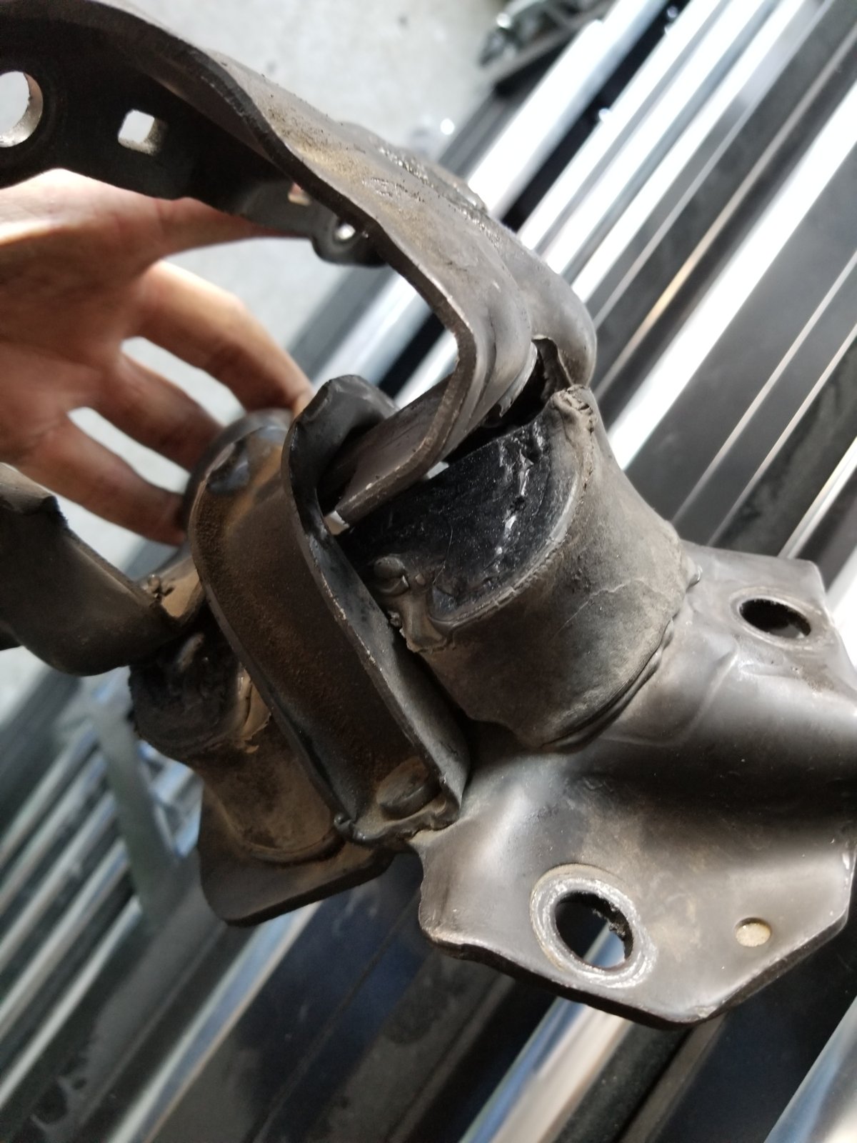

I just replaced a mount in an 07 escalade 6.2. It fits great. Here are side by side pics of old and new. New mount is the 25847739 part number.

Just to add another confirmation... Replaced the (severely broken) driver side mount on my '08 Yukon Denali yesterday with the H3 mount (PN 25847739). Fit great and the vehicle feels so much better now. Didn't really notice much (if any) change in any engine vibration feel.

It wasn't too bad. I had watched a ton of the Youtube vids out there on it beforehand, so I had a good idea of my plan of attack. Went in from the top, removed the steering shaft (after securing the steering wheel), and just took my time.

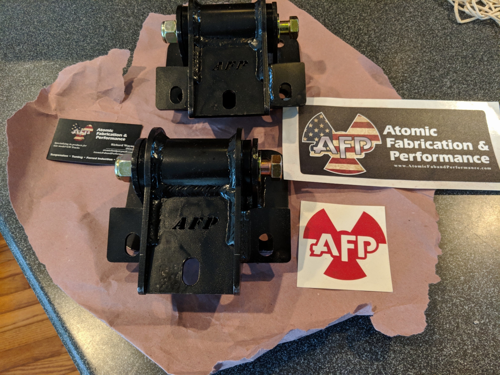

I went with Atomic Racing poly engine mounts made for the gmt900. I've been living with toasted mounts so long I doubt I'll notice much increase in NVH. Good price and fast shipping. More $$ than Hummer mounts but surely stronger!
After I install in the next week or so, I'll report back with my impressions.

These have poly, so not as bad as solid mounts. Eventually I'll be cammed and supercharged so I'll skip the Hummer mounts.
Yes, atomic from pt.net. Great guy who really helped me tune my engine and transmission. Well, I paid for his help but $$ was cheap and he knew his stuff! Lol, and I'm not getting anything out of pushing his services and products.
