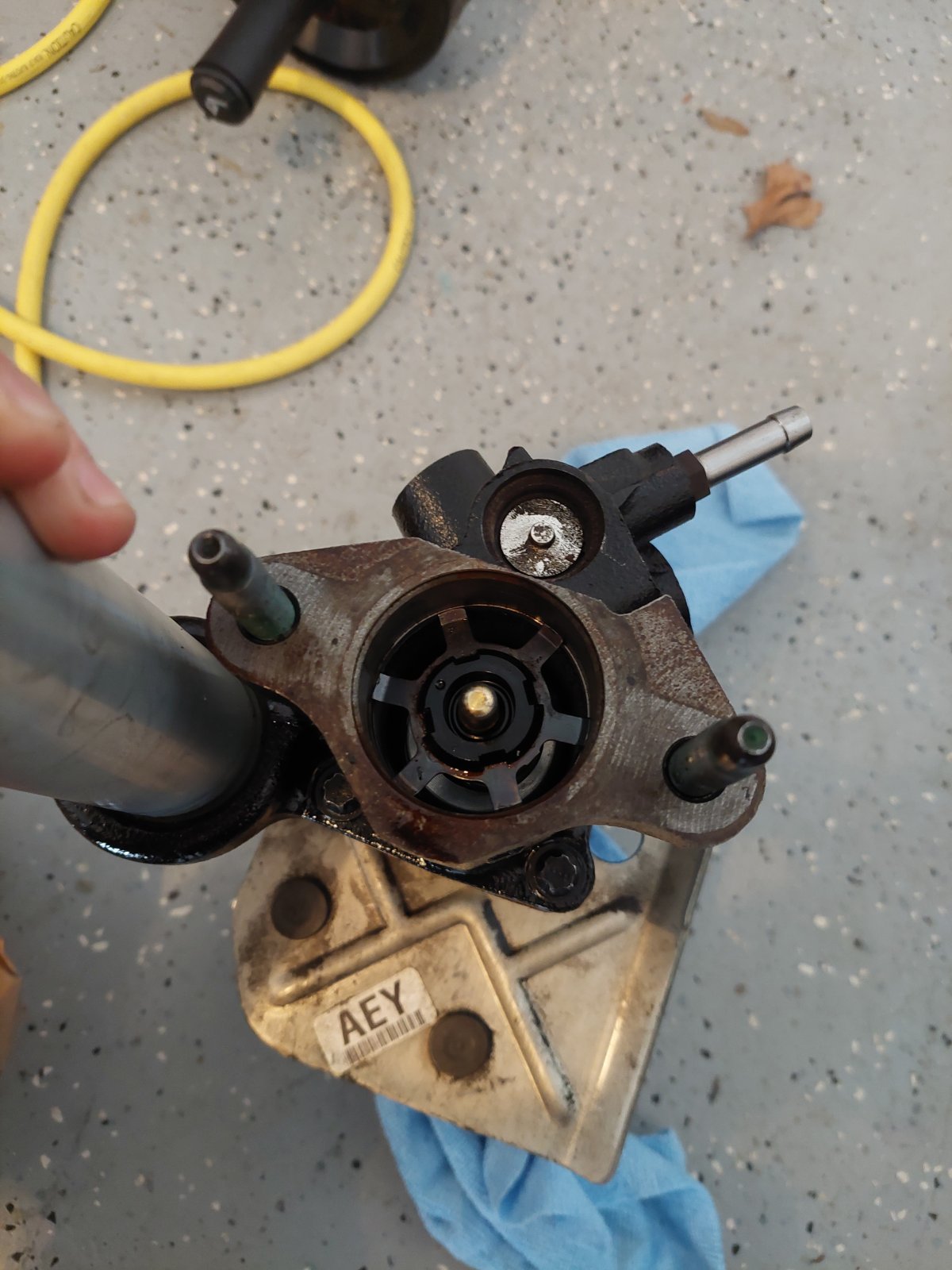

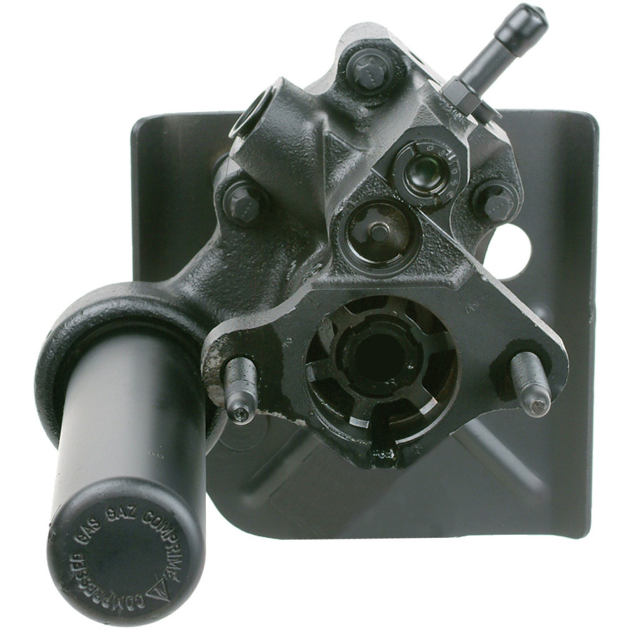

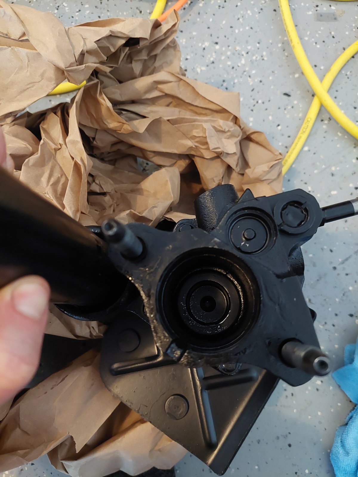

Am I missing something? The Cardone part is completely missing the spring + pin, not sure what it's called. Take a look at the pics

There is something wrong. You have the wrong brake booster, or the brake booster is missing these parts.
Are you sure that is the right part?

Just gave Cardone a call, they said I need to use the parts from my original unit. I did this and everything is working fine now. Guess i should of looked at the new unit harder before hand, comparing it to the original, or at least an instruction informing of this
