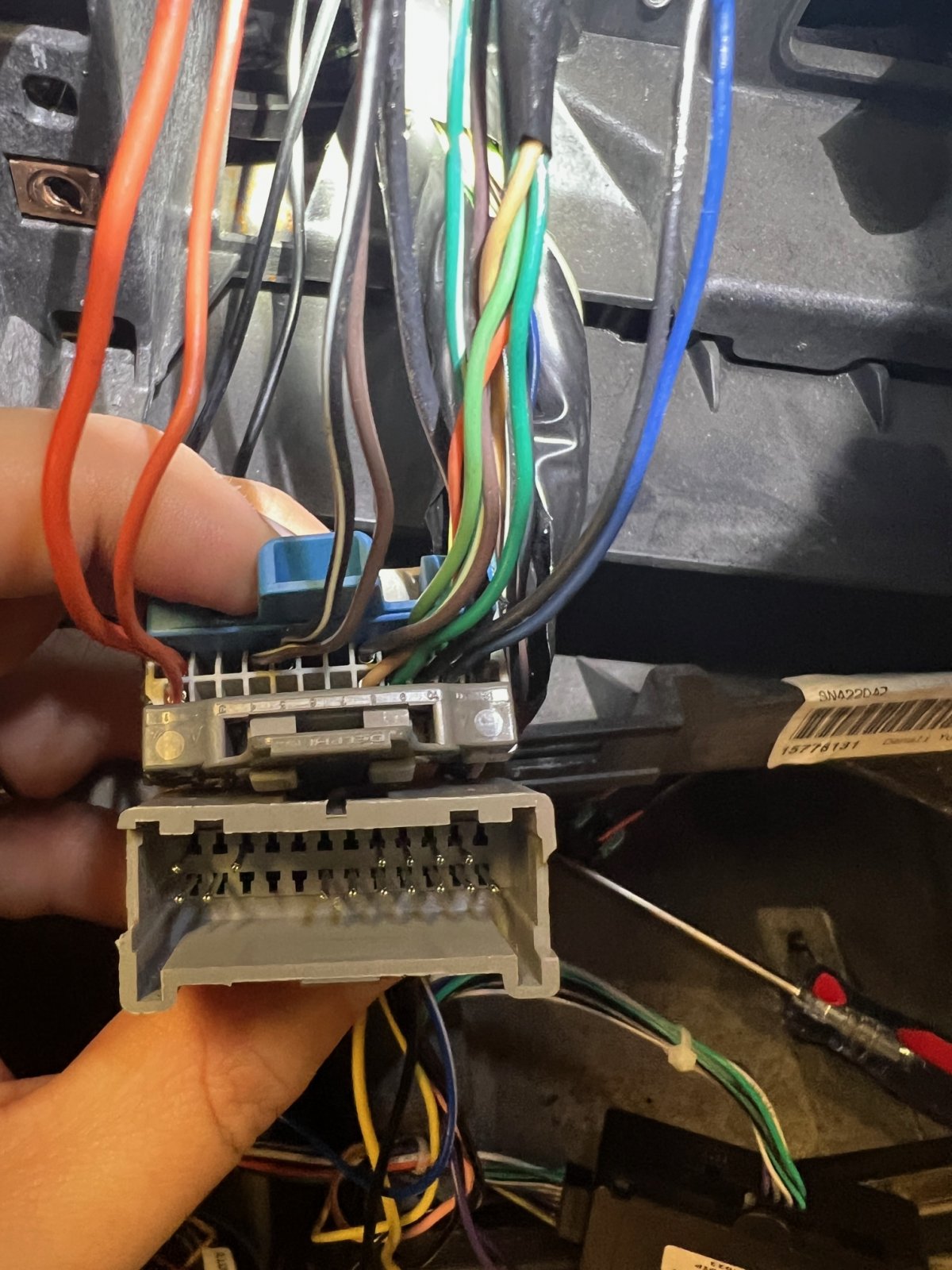

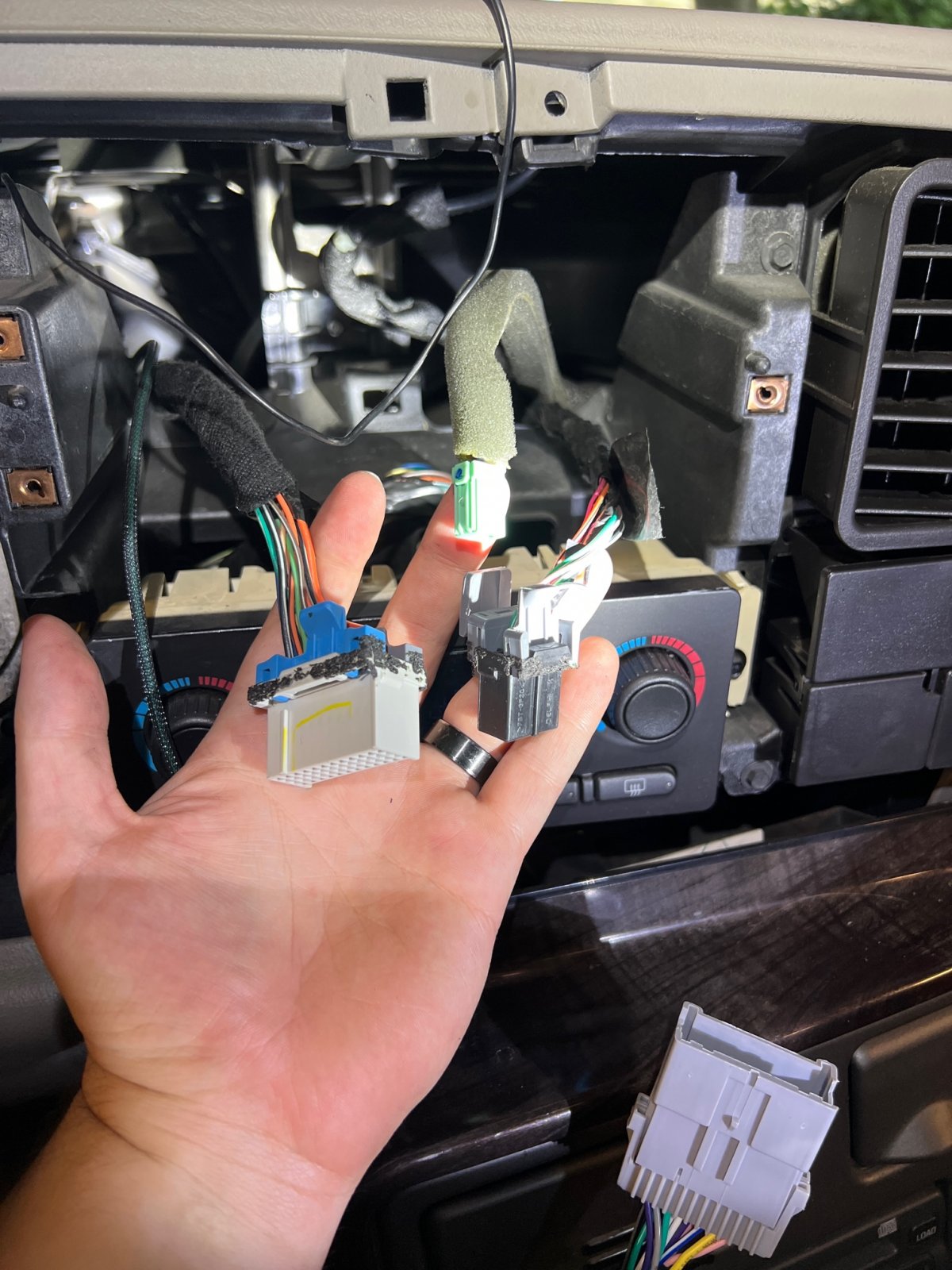

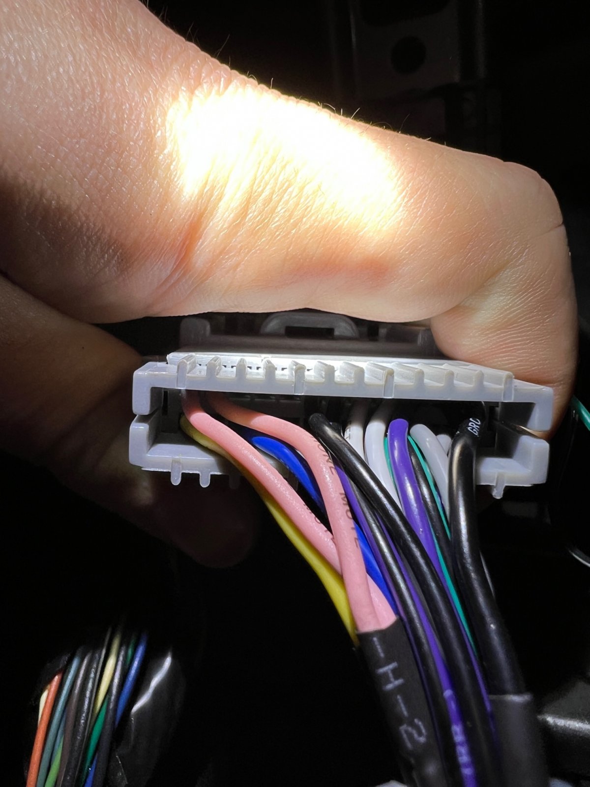

Hello everyone,
I just finished installing my new double din in my 06 Yukon Denali with premium Bose. Only my door speakers were working and sounds like crap. Tweeters and stock sub have no sound. After going through the wire harness and double checking all my solders, I noticed the the interface controller "Crux CS-GMC2" didn't line up with the pins on my factory harness. Most notable is that the remote amp turn on plug is empty on the factory harness. Does the factory harness look like the plugs are in the correct spots? I've seen people tap the remote amp wire to a "pink" wire that is on the second smaller harness, but not sure if that is correct. I called crutchfield and they are sending out a replacement controller, but I don't think that is the issue. I want to use the factory amp still. Below is a picture of the factory harness on top and the controllers harness on the bottom. You can see pins are empty or not in the right spots. Any help would be awesome. Wife already said I should pay someone to do it and I said I could! Help me save face! lol

For anyone wondering, I am an idiot. I had white/black to white and visa versa for the harness. So anyone with an issue like this, double check your connections lol.

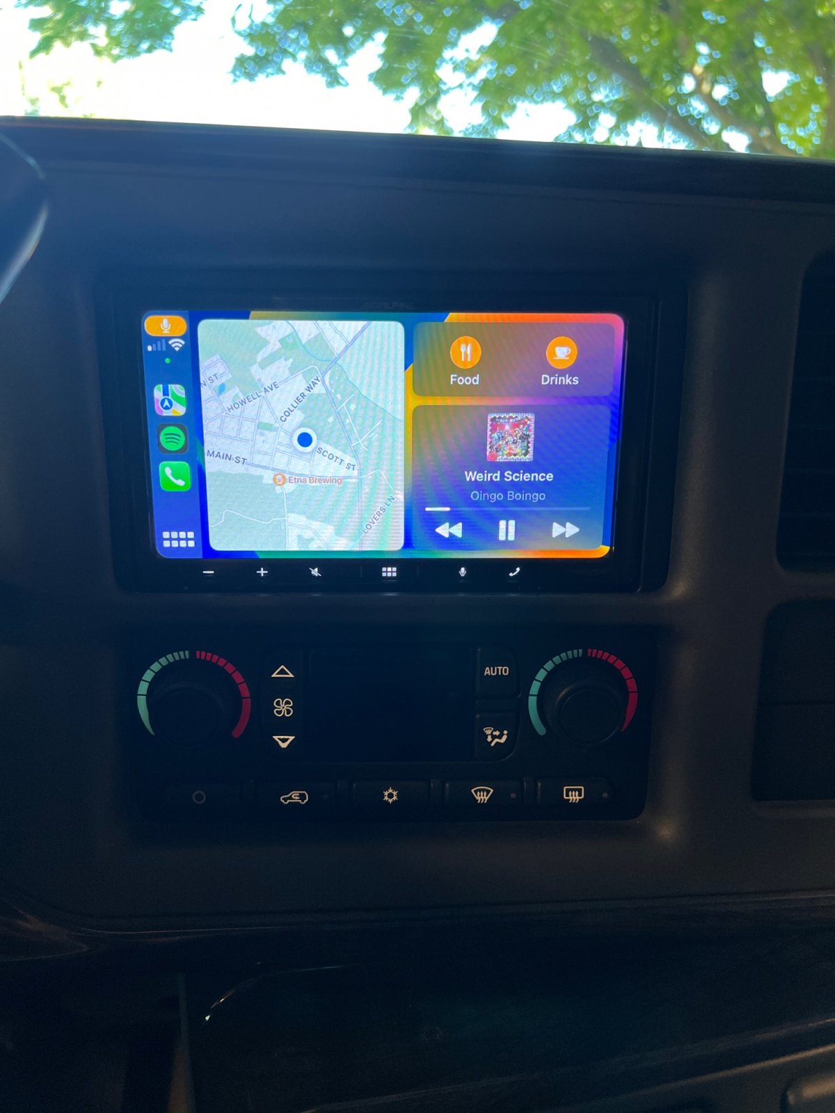

Pictures of the new radio please? I am considering the same. My '05 Yukon radio is still fine, but I get confused with crutchfield choices.
