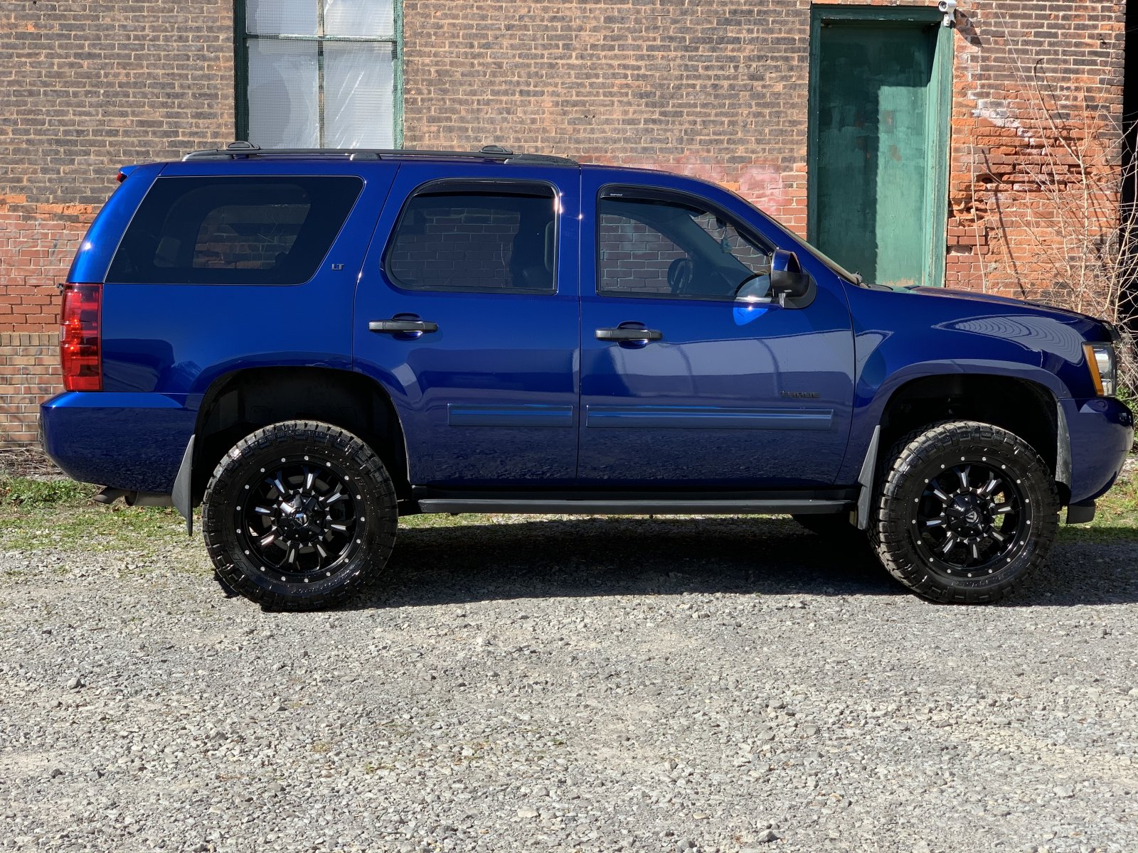

We match! I have the RC 3.5" lift on there too and need new struts and shocks but don't know which to go with. Currently, both are OEM with spacers.

As for the bilsteins get the 5100 series stock style ones and keep the spacers I had gotten the 5150 adjustable height ones a couple years back and they rode like shit they were way too stiff I went back to stock Monroe’s and they were too soft eventually I ended up doing coil overs and was finally happy with the ride quality
