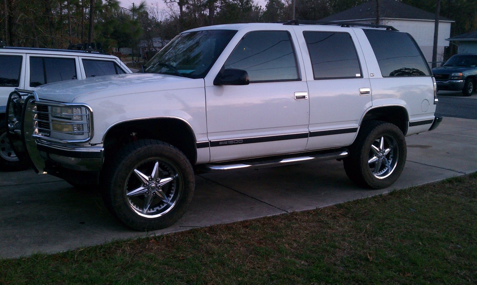

It was a 1998 Yukon SLE 4wd with between 4 and 6 inches of lift and 33" tires on 20" Helos... and what a pile of junk it was! First of all, we went and looked at it when it was dark, and the interior lights didn't work so we couldn't see just how bad the interior was. In the low light outside, we couldn't see how bad the exterior was. The truck ran and shifted fine, but it had a miss and if you were at cruising speed and put the pedal down to pass someone or whatever, the rear of the truck would sway sharply from side to side as if it had death wobble of the rear. We really took a bath on it.

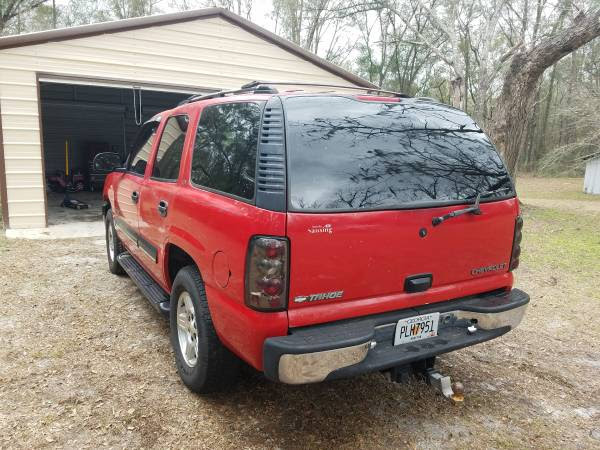

This past weekend, we just picked up a 2000 Chevy Tahoe LS
2wd, LM7, tow package (HD trans cooler, factory hitch, factory 7 pin connector) 3.73 rear w/ posi and electronic traction control, tow hooks, and skid plate.
The truck has 203,000 miles on it and still starts, runs, and drives like new. The motor is all original on the original build, the transmission was rebuilt 3 years ago. This is a classic example of "rough around the edges, but she's got it where it counts." The rough part is, it needs a paint job pretty badly, has a few small dents in the front passenger fender and 1 in the front passenger door, and a dent in the bumper. The interior isn't in terrible shape, just stained carpets, a rip in the driver's seat, and some cracking in the passenger front seat. The tabs that hold most of the switches in are breaking, so they're just kind of resting in place - but they all work. The dash has a crack in it and the dash bezel is a couple cracks and the previous owner cut the radio slot for a double DIN receiver and did a pretty piss poor job at it. The headliner is sagging too and for whatever reason, the speakers have ZERO bass haha.
Either way, we're pretty pleased with the purchase. It has new shocks, new battery, new water pump and it starts, runs, shifts, and drives as if it were new.

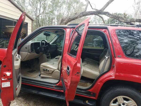

We're planning on fixing it up like new and adding a few custom touches to it. Not planning on going crazy with it, just want to make it look as good as it drives.

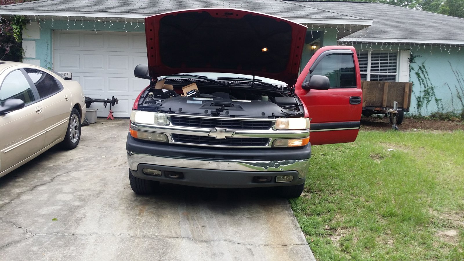

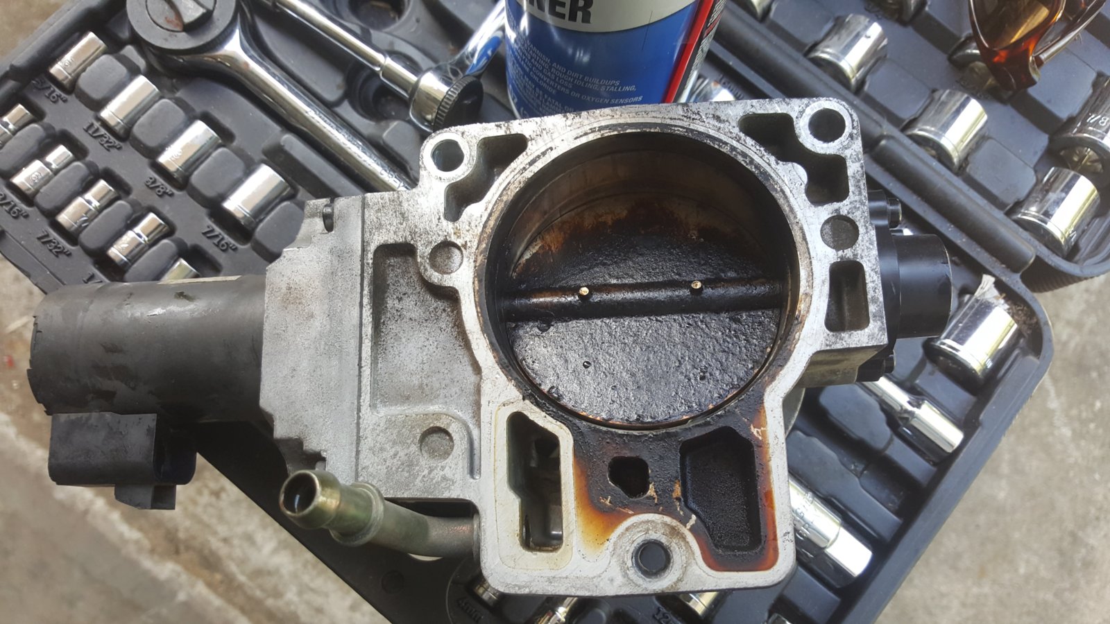

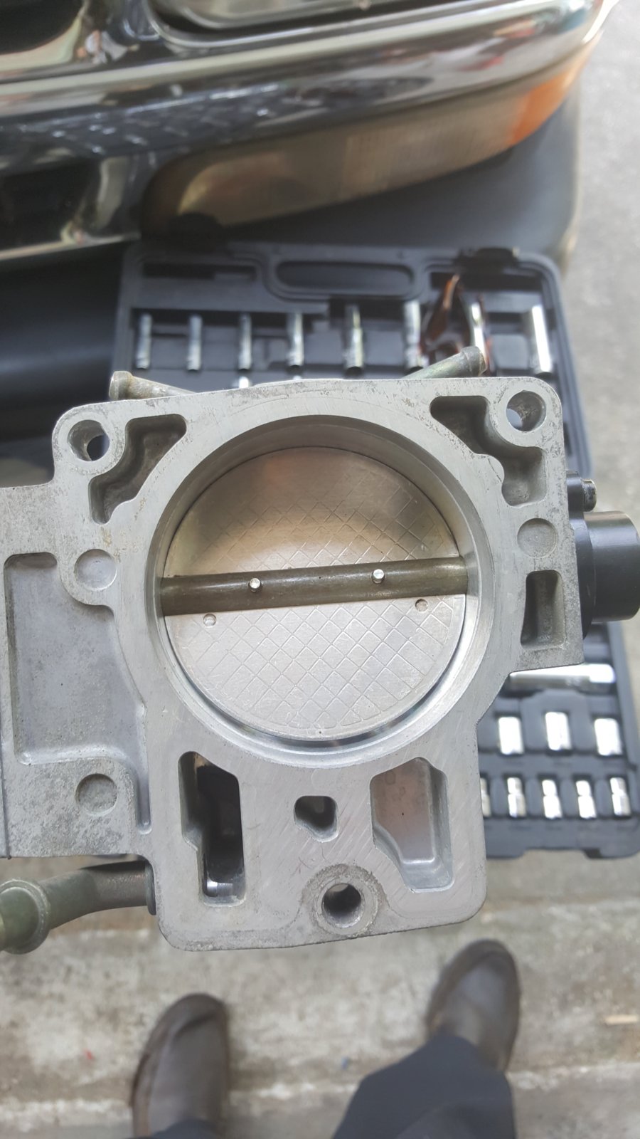

Haven't been posting it in this thread, but I've been dealing with the dreaded REP mode issue. Numerous codes, most of which have been dealt with. Waiting on money for the rest. Of course, the way it's been working, once the weather warms up, it will be a non-point as it's only doing it when it sits overnight and the ambient temp is below 70*.
SO.... I replaced the APP sensor, cleaned the TB, cleared the codes, then it drove fine for 2 evenings without any CEL or other troubles until the next cold morning. Started up fine, no CEL, wife made it 5 minutes down the road and it popped the CEL and went into REP mode. Sat on the side of the road for 10 minutes until it warmed up past 185, then shut if off, turned it back on and it drove fine. Took it to autozone for them to read the stored code ('cause the CEL shut off when I cranked it that afternoon), and it showed a p1515. Guess I'll have to replace that TB sensor after all...
Before and after shots of the throttle body....
Drove it all last week and at the end of the week, I came back from the store with my daughter hearing hissing.... pinhole on the driver's side plastic side tank on the radiator. Well great! :banghead:

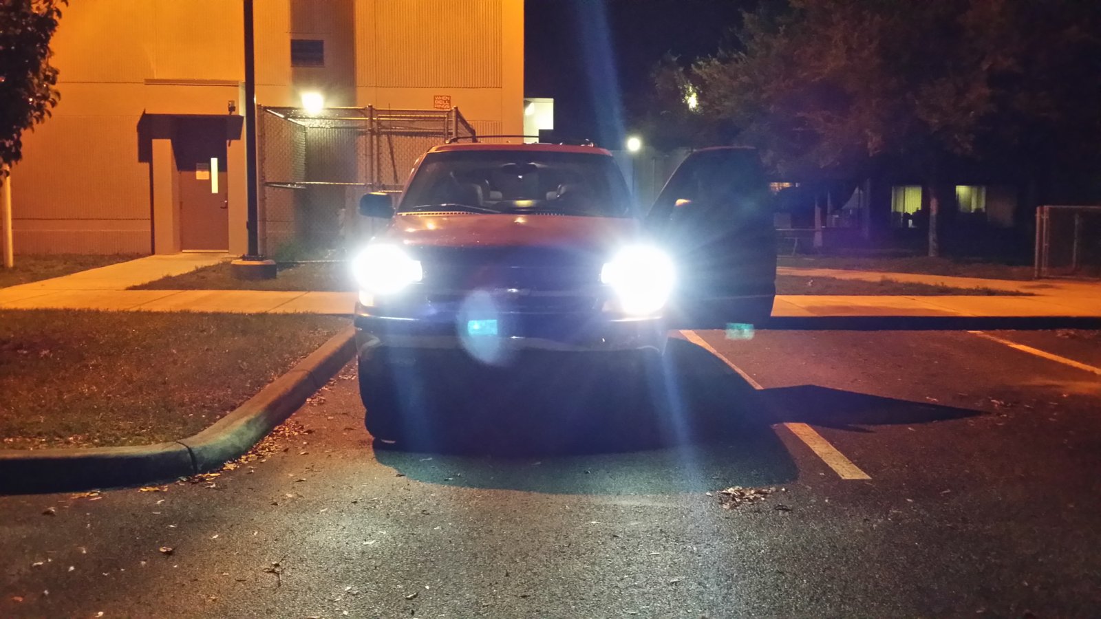

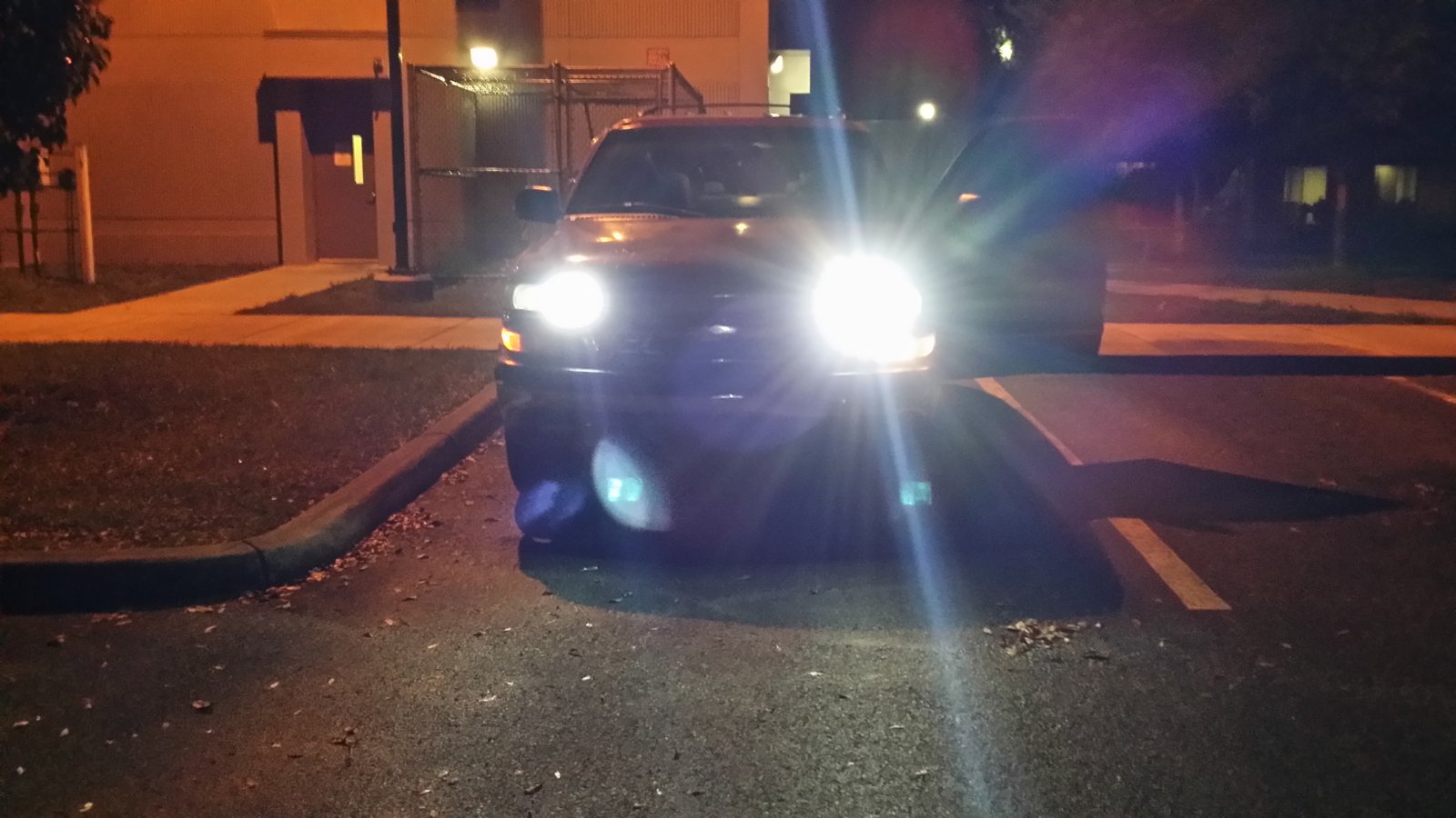

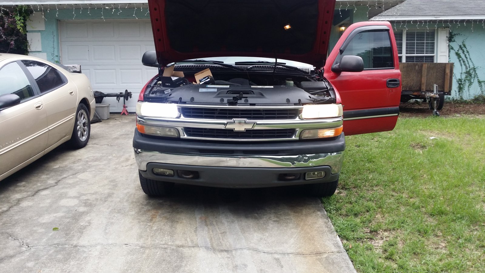

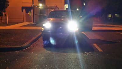

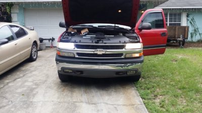

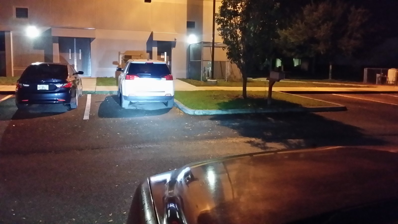

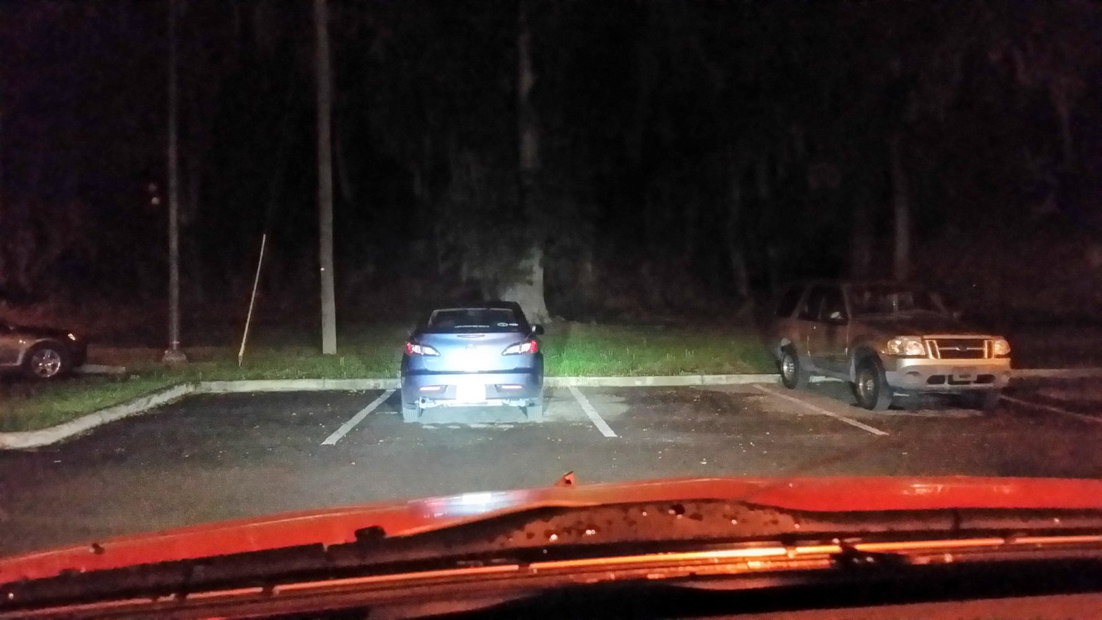

Bought some Beamtech LED bulbs for it off of Amazon on Saturday night. They came in this afternoon about a half hour before I left for work. Threw 'em in real quick and drove to work with it.... suckers are BRIGHT!!!
Pretty impressed so far. I'll be able to tell more once darkness falls.

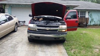

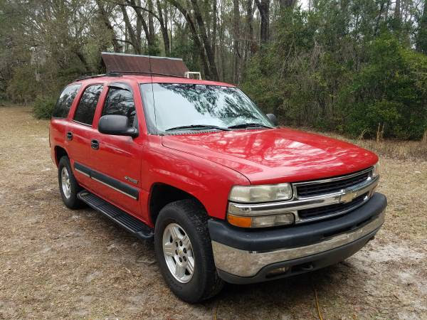

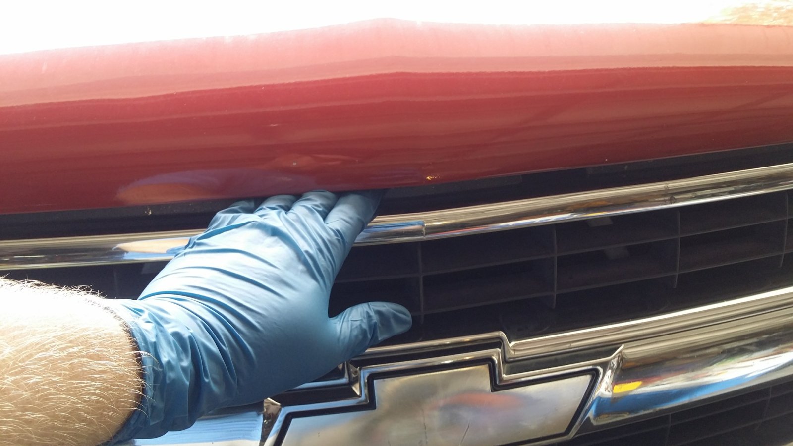

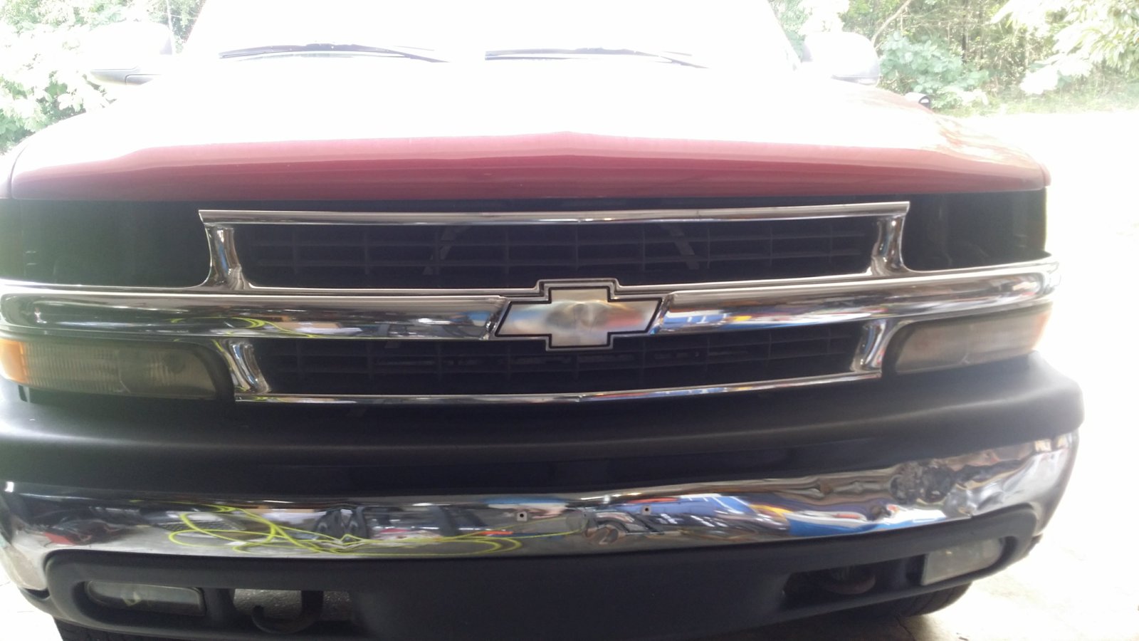

Hey, can anyone tell me how to remove this gap? I looked at the grille connections with the upper shroud off, but it's not making sense to me how to move it up.
Shouldn't be that much gap, right? Maybe it's my OCD, but that just seems a bit excessive.

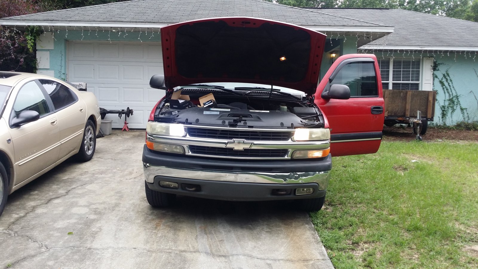

Figured this was more appropriate as a build thread since that's what the goal is. It'll be a slow build, but it's not staying stock, that's for sure.
Plans (not necessarily in order):
-Re-upholster the headliner
-Clean up the interior to see how badly stained it is. Re-finish, paint, dye, or whatever from there
-Flowmaster single in / dual out muffler (already have)
-Replace front bumper

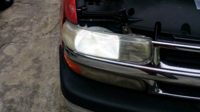

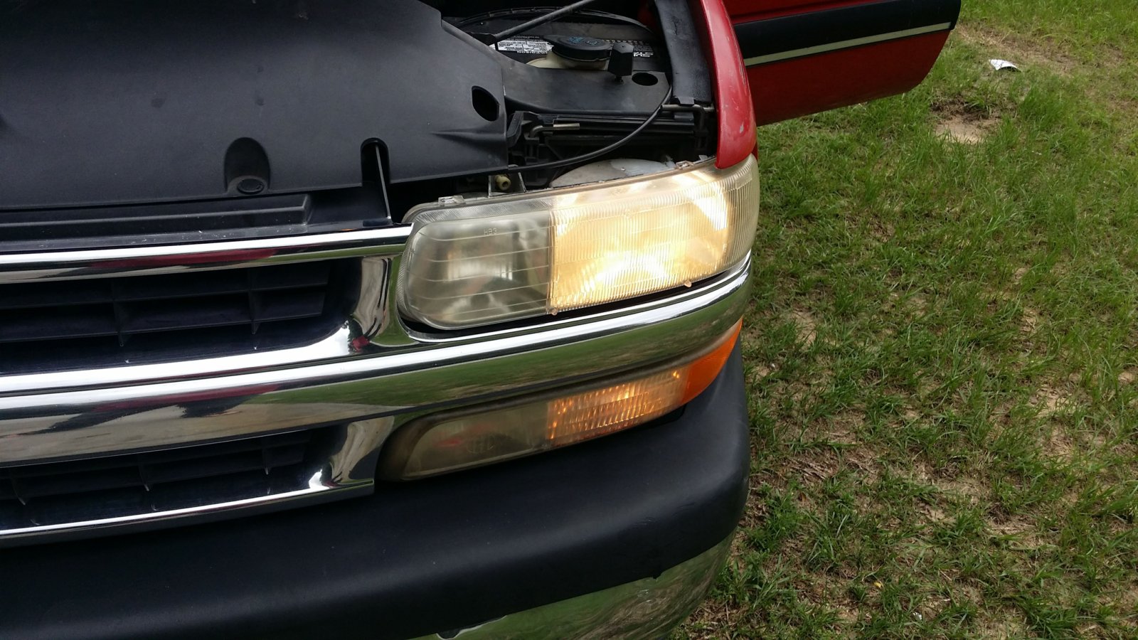

-Replace headlight & turn signal housings
-Replace tail light housings
-Esky vent caps
-Denali center console swap
-HD hood/grille swap
-Dent repair
-Paint (oh god does it need the paint)
-2" lift/leveling kit
-18" wheels
-33" tires (Just so we're clear - the wife wants the lift and tires. I'd rather do a 2" drop and 20s or 22s, but this is her DD, so well... happy wife, happy life.)
Maybes:
-Denali cluster swap
-FIPK - hoping to find a good deal on a used Volant, AirRaid, or AEM
-Power programmer
-I'd like to do a cam, but I don't know if I want that much power under my wife's foot - especially with the kids in tow.
Overall goal is just a decent-looking family vehicle. Not a show-stopper, but not run down and neglected looking like it is now. I love custom rides and I really love this Chevy. Definitely my favorite that I've owned so far.
Any tips or advice is welcome. Not the first vehicle I've owned and modified, but it's my first LS-based.
