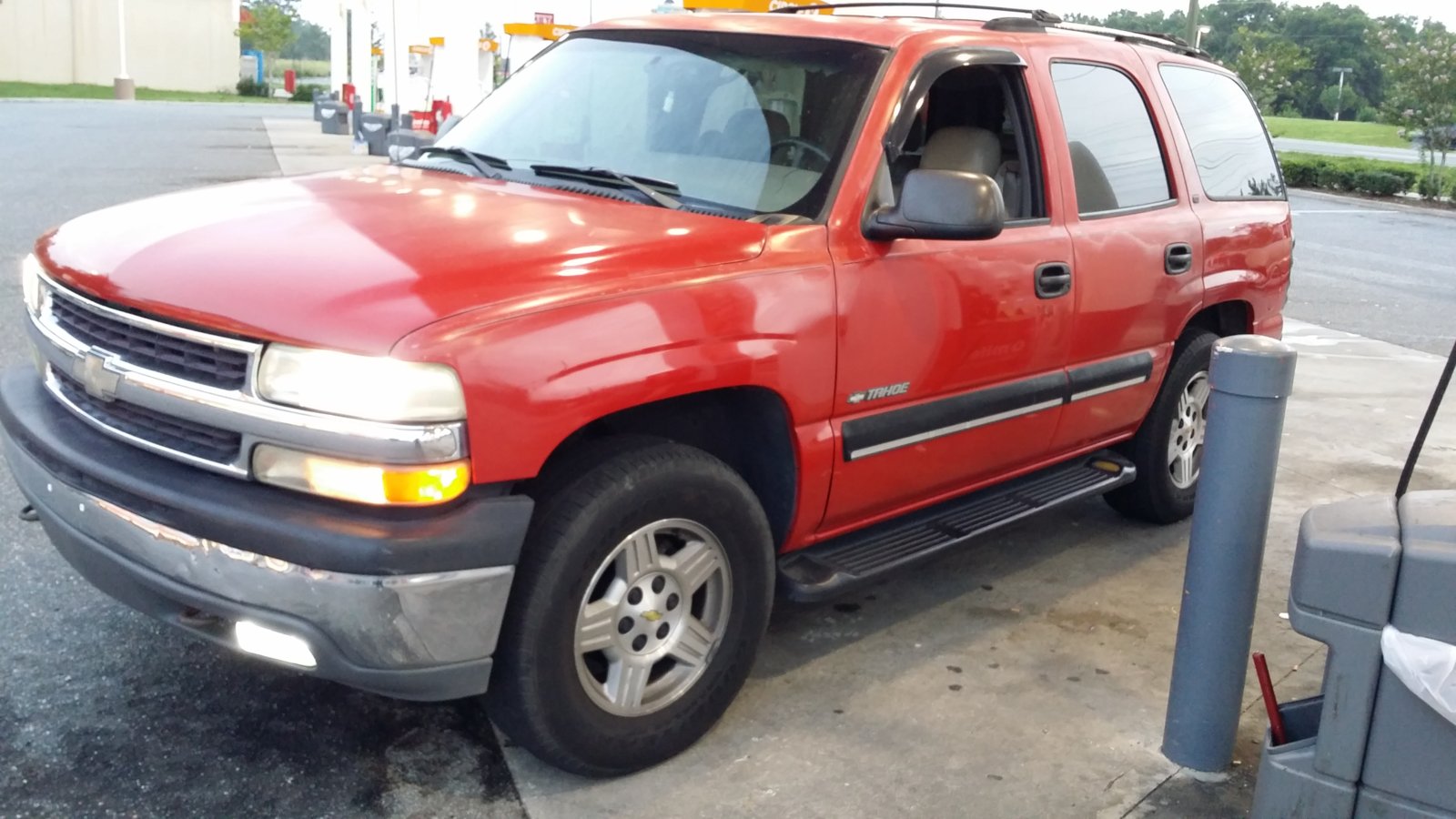

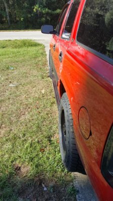

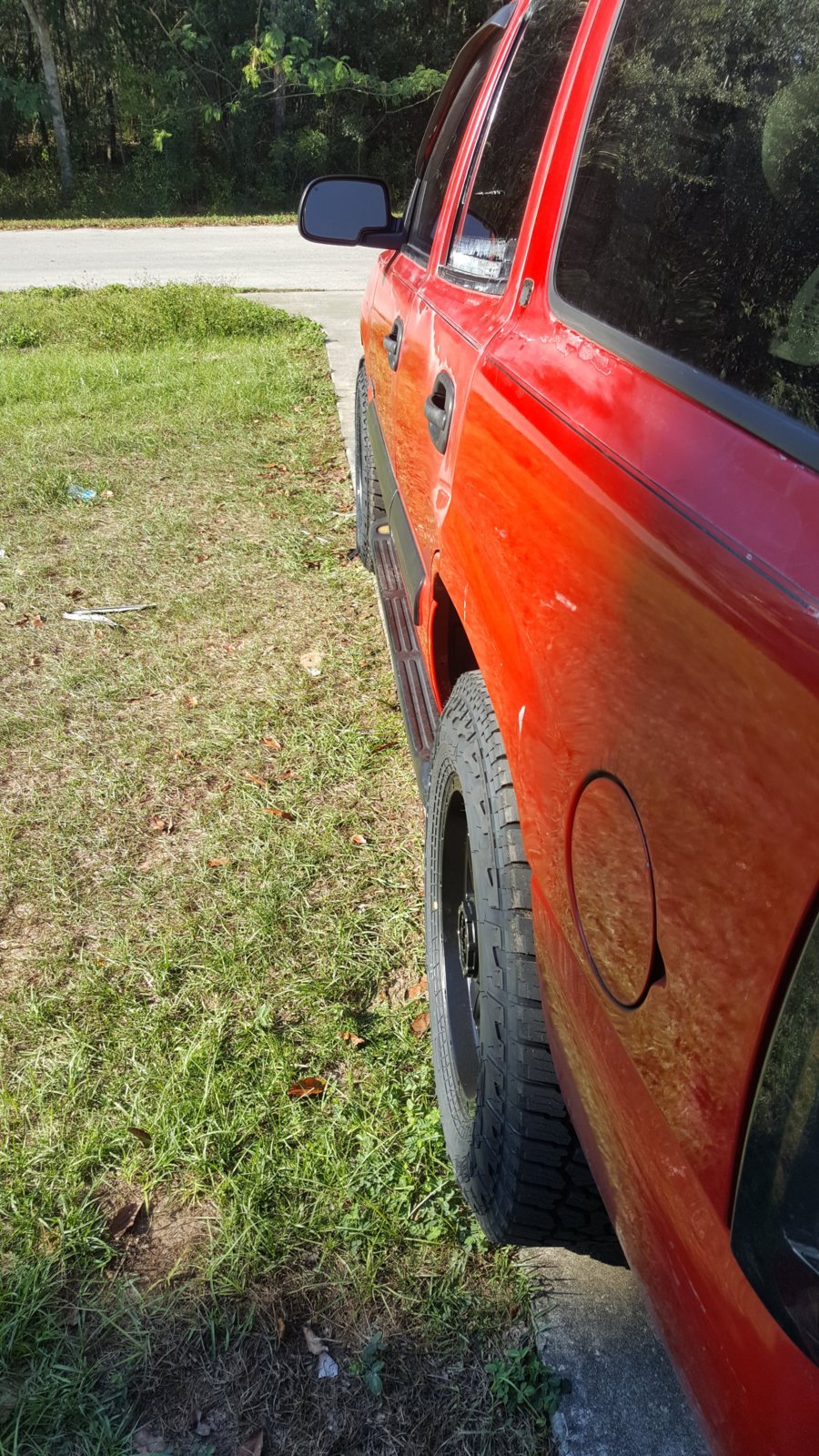

I wish that's all it needed. The clear coat is coming off and, in some spots, the paint has worn down to primer - bare metal in a couple spots. This paint was seriously neglected and I'm surprised the interior isn't in worse shape just based on that.
If just the clearcoat had come off, I could just have it re-cleared.... but nope - gonna have to repaint the whole damn thing.

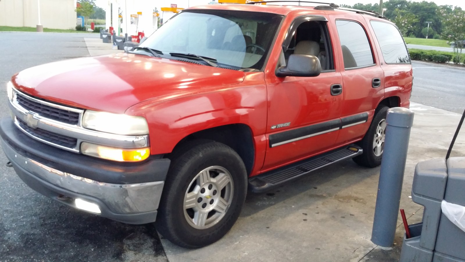

Gassed her up this past friday and I used my gas buddy card for the first time. Took a pic to set up the "my vehicles" feature in the app, so I figured I'd upload it for all to see!

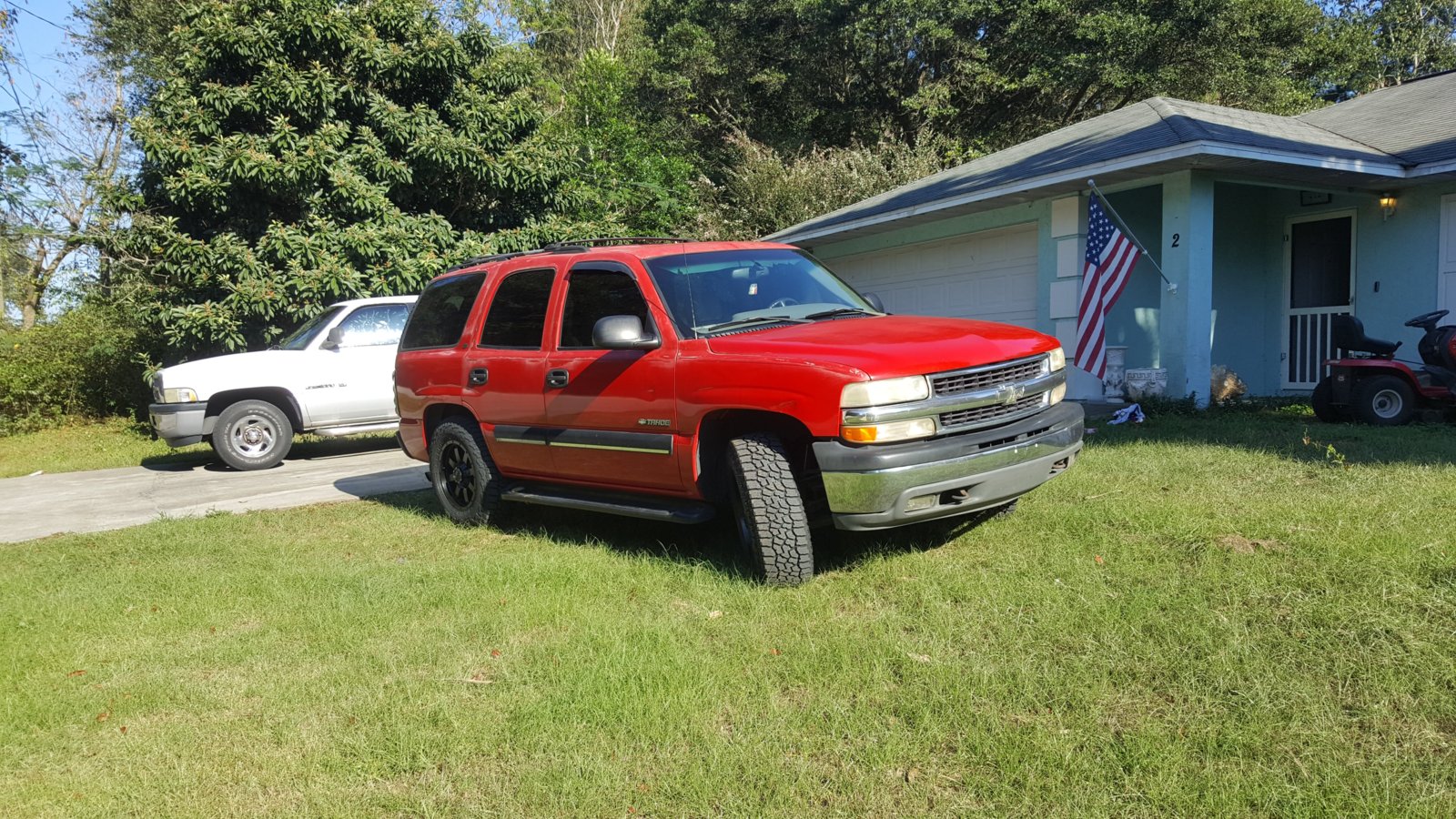

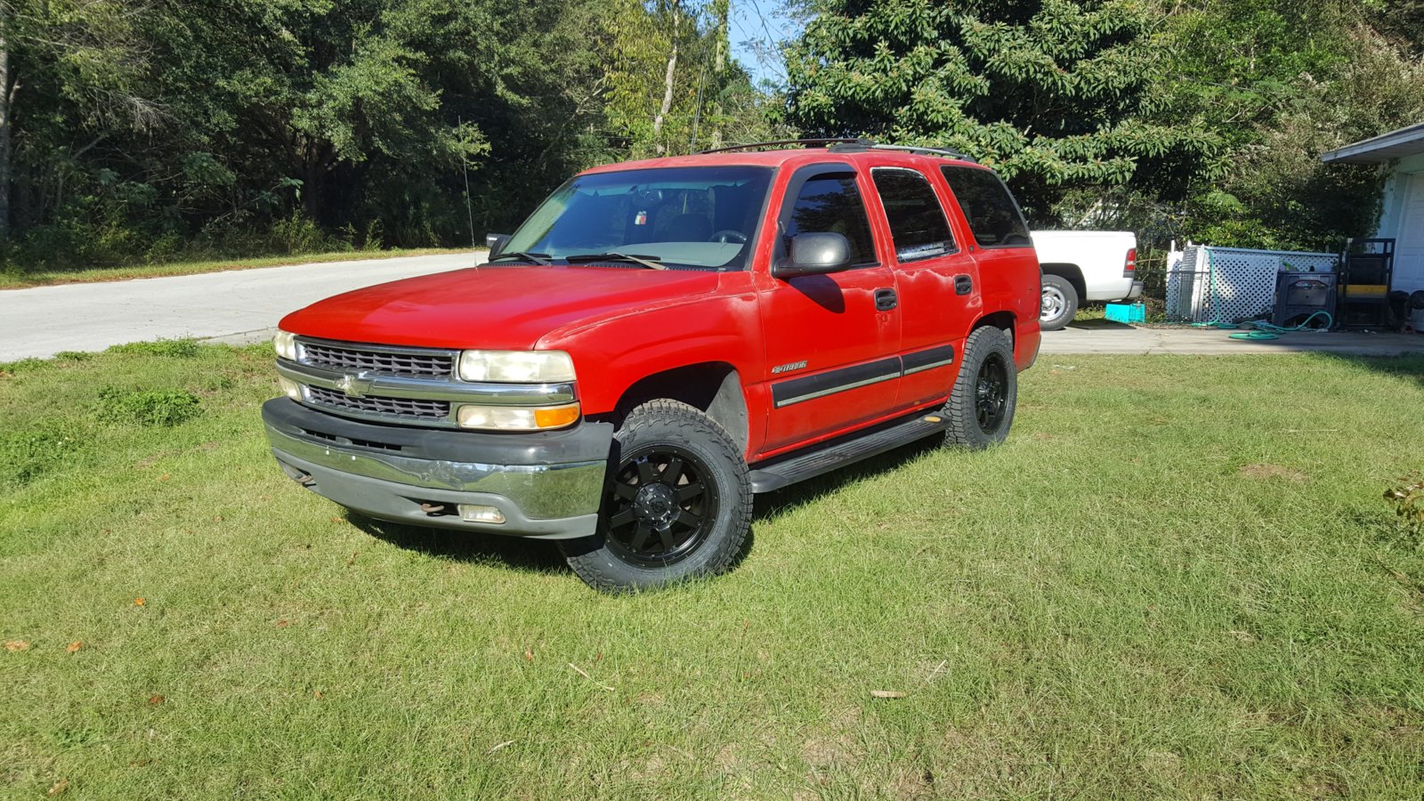

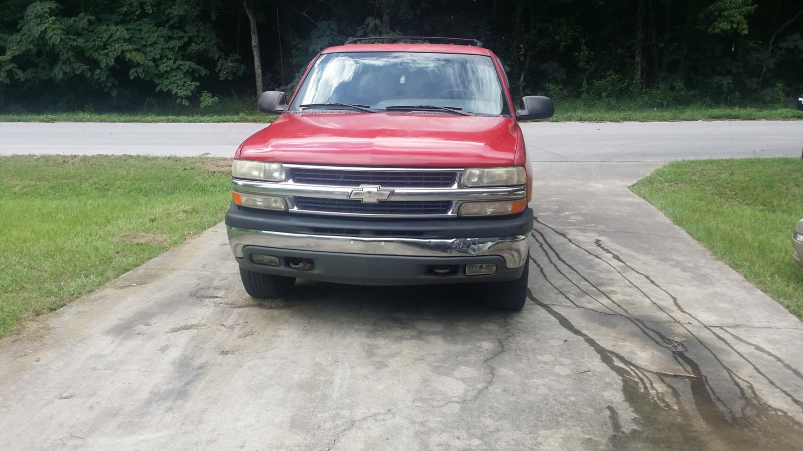

Well, I tried the hood latch. Moved it down maybe a millimeter or two, but not enough to make it noticeable.
What I did notice in the process, though, was that the headlights were pointed at the sky and cross-eyed. I adjusted the aim so that the housings were flush with the grille on both axis and brought the truck and tool with me tonight so I could aim them when it's dark out.
The aim is MUCH better and now the gap is more even. I think the reason it looked so bad was because the headlight housings were practically touching the hood because of how far up they were pointing. There's still a gap big enough to fit my fingers in, but it's more consistent all the way across now.

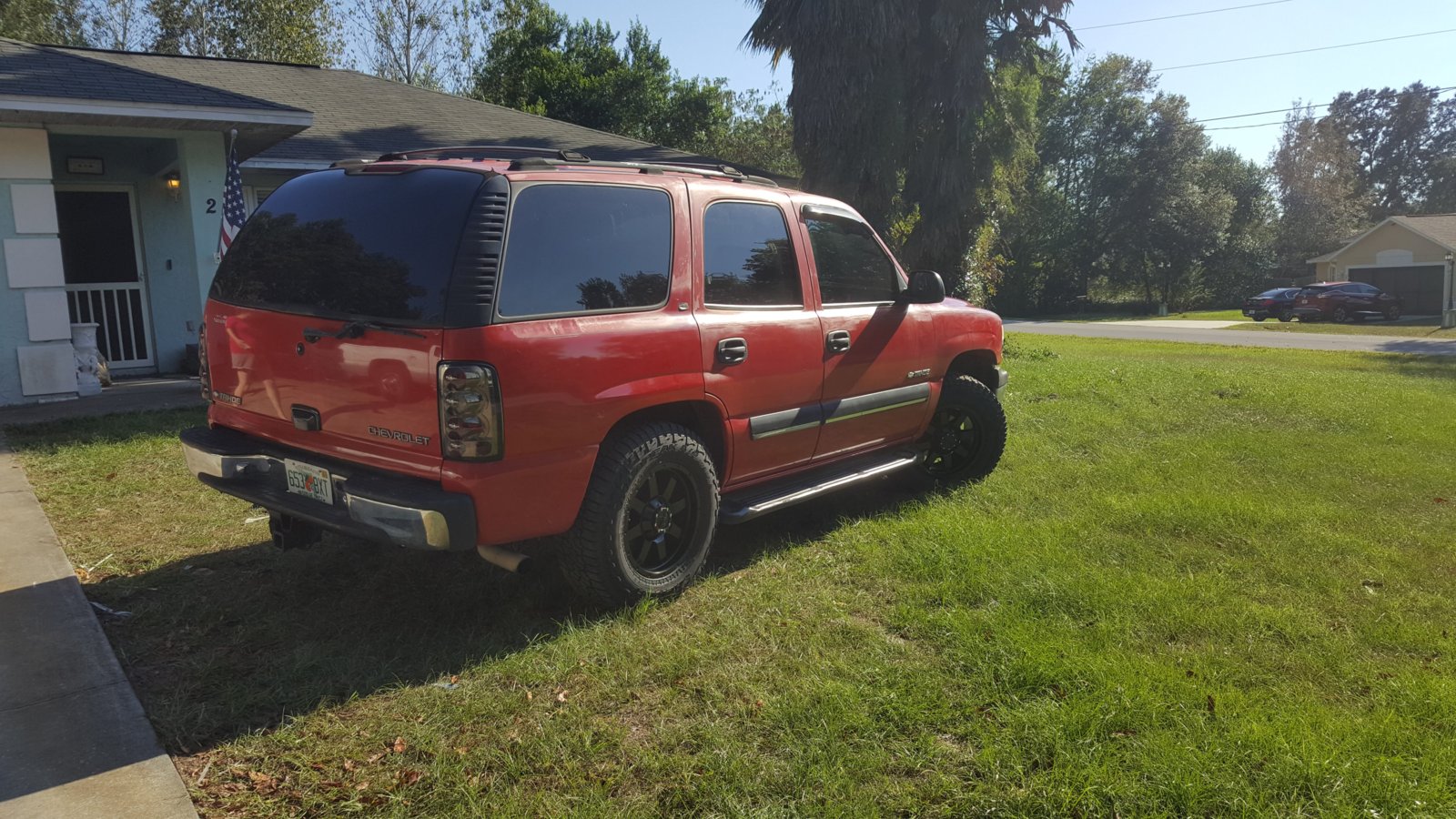

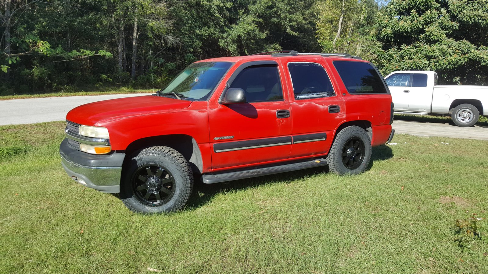

Well, the gap is definitely better than it was. I'd ALMOST say perfect. I also removed the vent covers on the bumper cap. Small detail, but looks so much better....

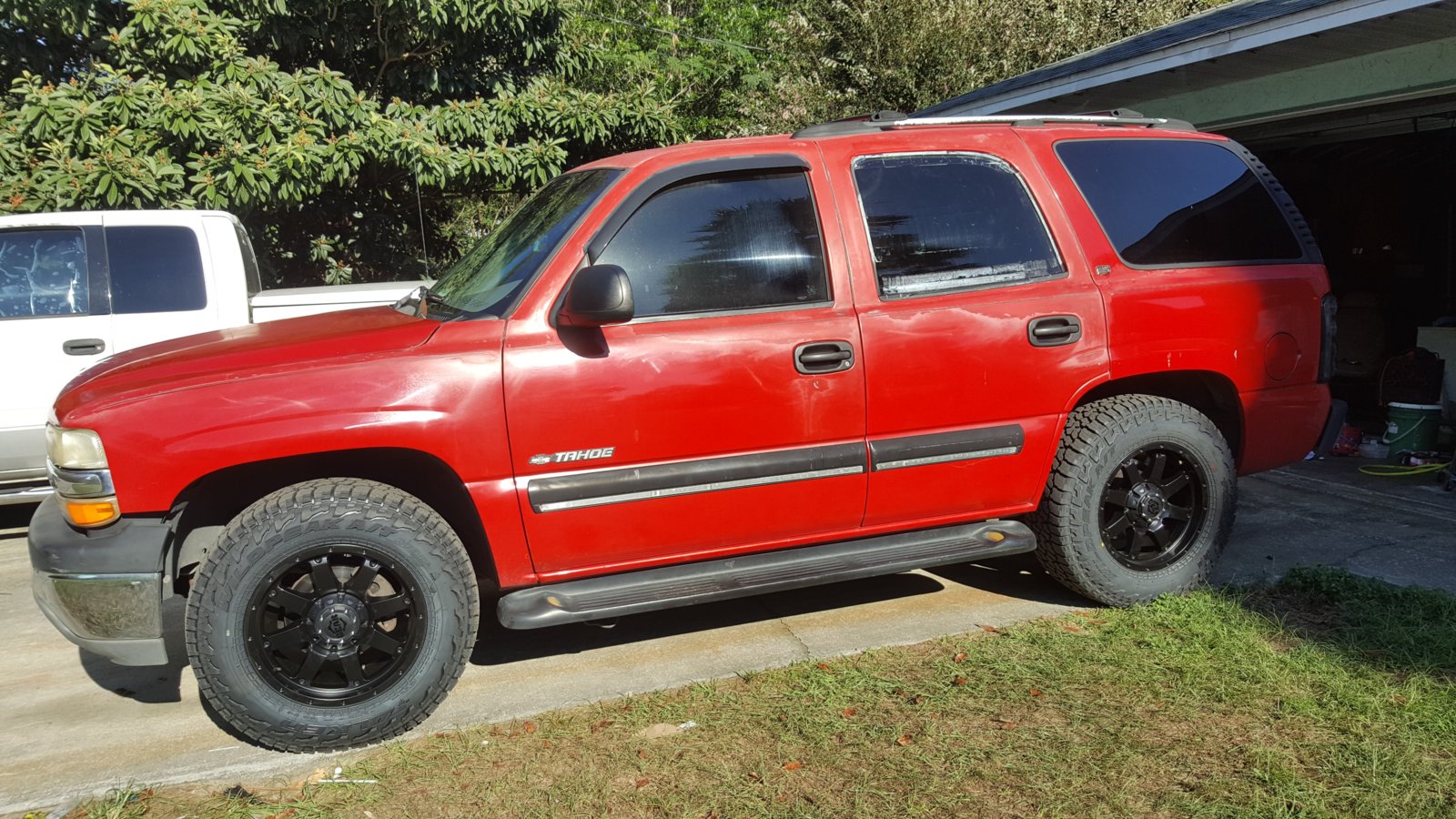

What running boards sre those? Do they have lights at the ends?

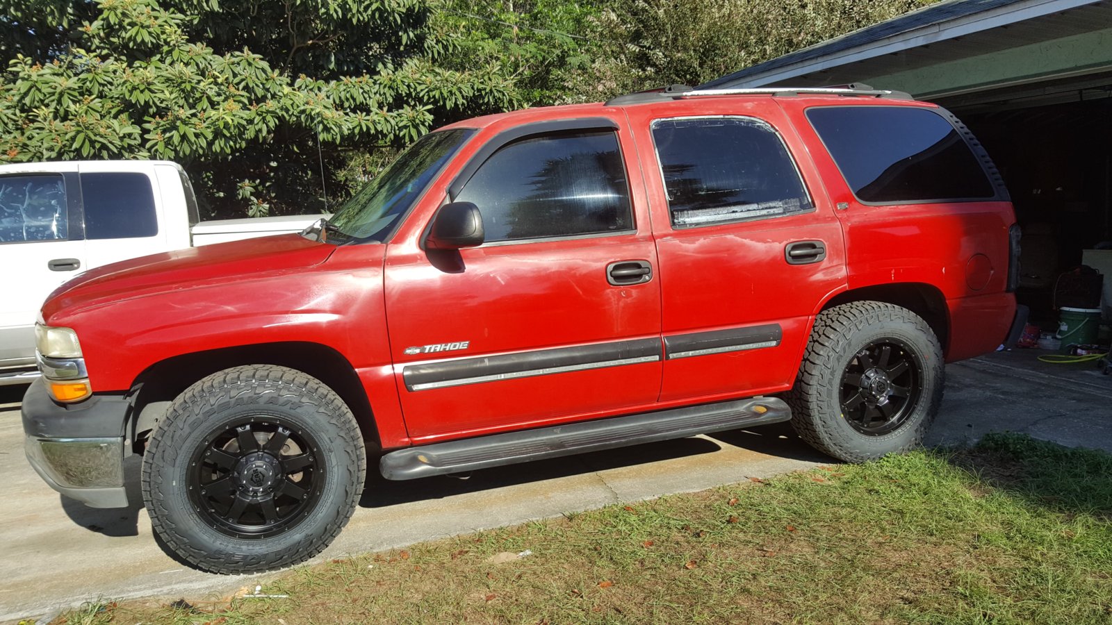

I'm not real sure what brand they are, man. They were on it when we got it. I'll look around on 'em to see if I can see any branding if you're really interested. Yes they do have lights on them. They're actually pretty convenient when they're functioning properly. We have entry lights on the mirrors too, so the steps are lit up pretty nicely. Sadly, the lenses are yellowing really badly and the steps are so sun damaged, they've glossed over and almost become a slip hazard. We're going to swap them out for a set of Nerf Bars eventually... Jess wants the more "offroad" look.
I like it. Did you have to crank at all to fit them?
The front appears to have already been cranked to "level" when we got it. Nothing more than that, though.

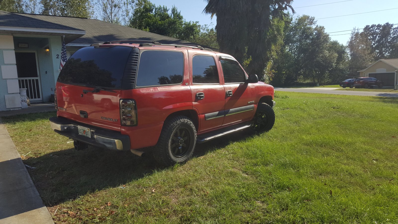

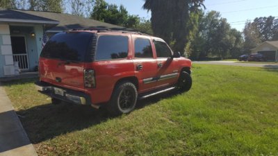

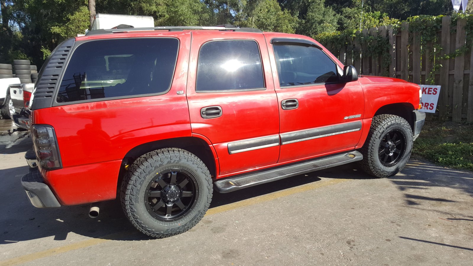

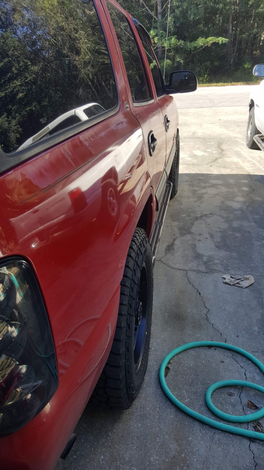

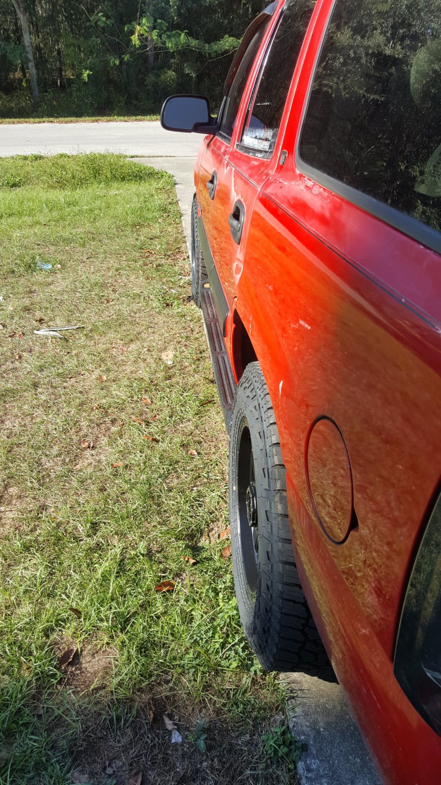

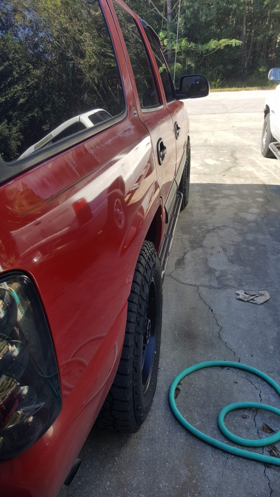

So I did experience my first bit of rubbing. Not where you would think though, and nothing too concerning.
Was on the way to Sanford Airport from my house and, there's a section that's under construction so they have you s-curving across multiple lanes for a lanes shift. I was doing about 55 through that area and because of the uneven lanes and the speed, the suspension kinda bottomed out and I heard a slight scuff of the BACK tire on the fender... no damage done, not even a mark left, so nothing serious and we'll probably rarely experience conditions like that again.

Replaced the TPS with a brand new AC Delco unit. No more "reduced engine power" at startup anymore!
The rubbing on the tires is a little worse than I thought. When backing out of the driveway with the wheels turned, they rub too. Never could figure out why, on any given vehicle, the wheels won't rub when turned while you're moving forward, but will rub when moving in reverse.... but anyway, still not a huge deal, but it does happen.
