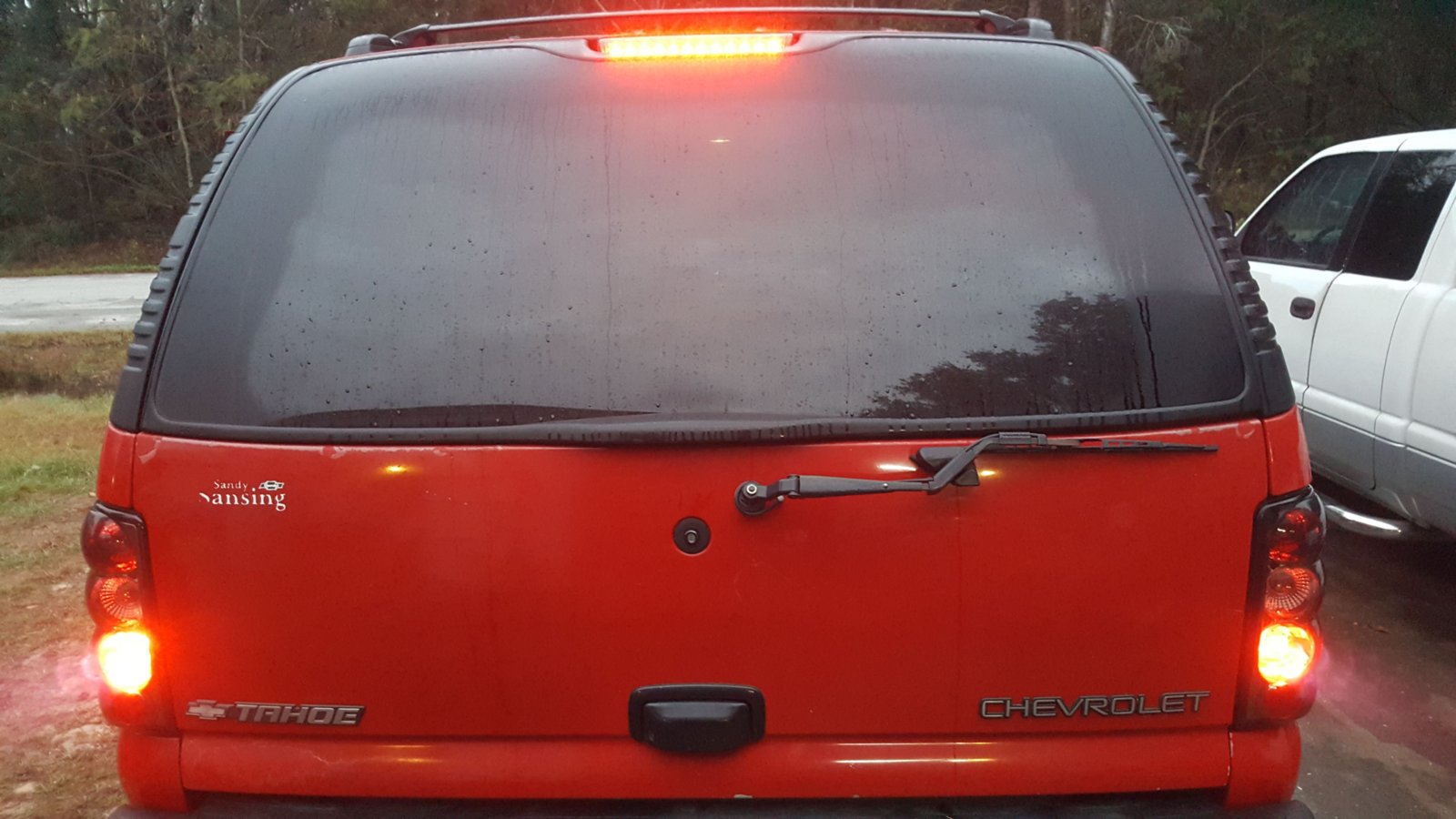

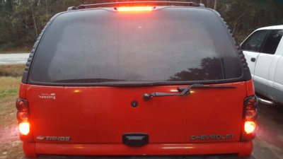

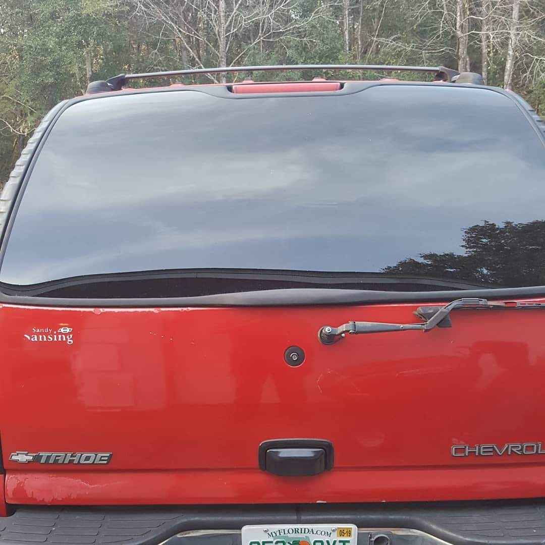

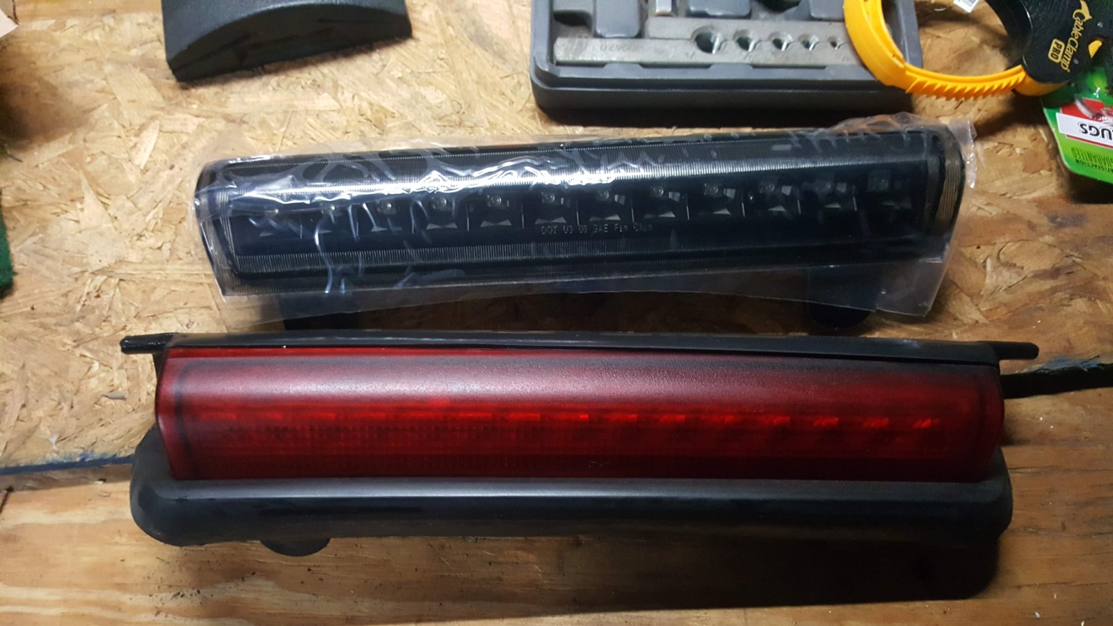

I noticed a while back when I was following behind my wife when she was driving Big Red, that the high mount brake light wasn't working.... that, coupled with the puny little aftermarket tail lights didn't give for much attention-getting brake lights. Just a rear-end collision waiting to happen, in my opinion. I didn't like that at all.

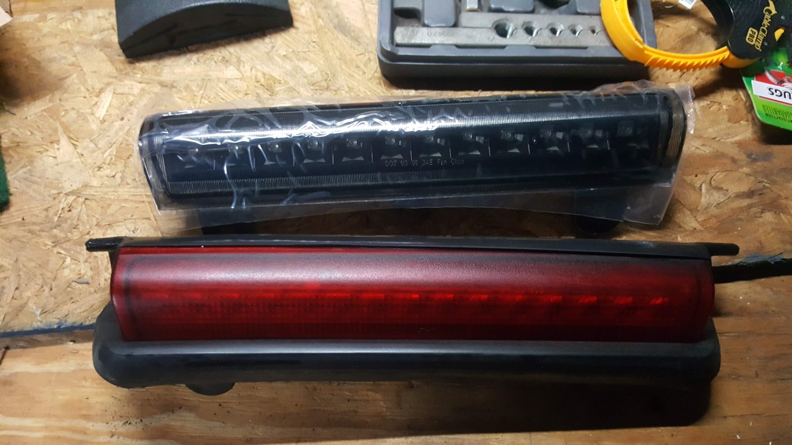

So I finally got around to replacing the OEM light. OE style one wasn't working at all anymore. I'm assuming either all the diodes burnt out or the board itself did. I found a couple different replacements on amazon, but I really like the blacked out look because it blends in with the back glass better.
Found one on amazon for about 25 bucks shipped.
https://smile.amazon.com/gp/product/B073K3S4B3/ref=oh_aui_detailpage_o00_s00?ie=UTF8&psc=1
Before:
Comparison:
The new one doesn't not include the rubber gasket, so you'll have to re-use your original one or get a new one. My truck has over 200k miles on it and spent most of its life in the Georgia and Florida sun and the gasket was still in good shape, so I would think deterioration isn't much of an issue.

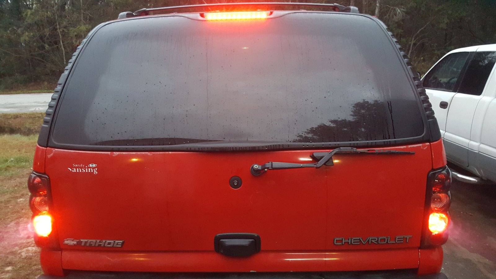

Install is pretty straight-forward. Open up your hatch, loosen the 2 phillips screws, wiggle the old one loose - it's a little difficult getting it out past the hatch, but worth the struggle - then unplug the harness, swap over the rubber gasket and reverse the process...

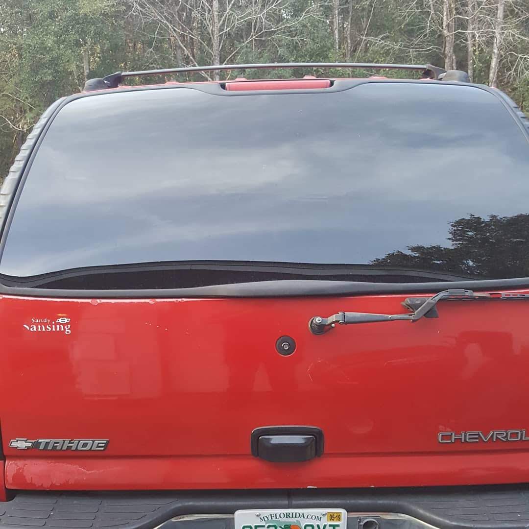

Voila!
After:

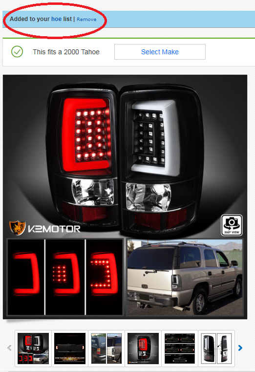

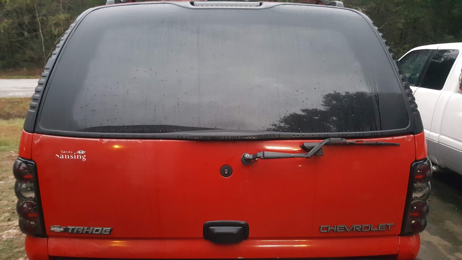

Next is those stupid tail lights... hopefully in favor of these....
https://smile.amazon.com/dp/B07CMKYYCS/?coliid=I2FEQSBMWAR0AX&colid=2BGXZ3KQSDFYI&psc=0
Or similar, anyway.
I'll pull 'em apart when I get 'em and seal 'em with some marine-grade silicone to keep out the moisture. Seems like that's the biggest complaint with aftermarket setups.

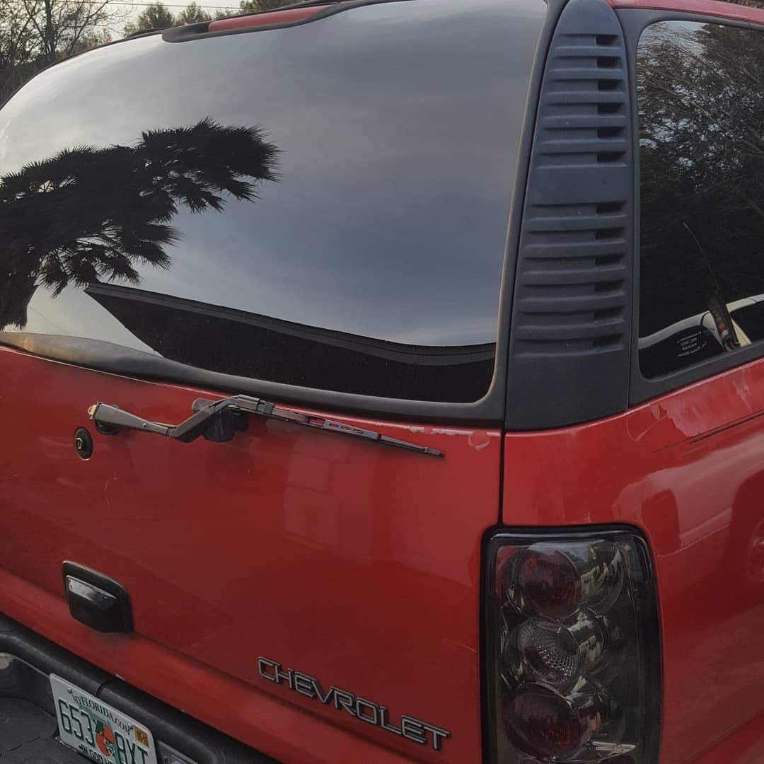

Gotta be careful with the aftermarket led tail lights. A lot of times they'll burn out within 1 yr. I know @Bigbeardenali1992 had an issue with his setup.
adventurenali92
Feb 16, 2015
7,737
9,212
Big Bear Lake, ca
I had issues with a different brand tail that was supposed to have resistors built in and didn’t have them so they didn’t work correctly. Currently I have those exact tails he pictured. Had them on for about a year and so far no issues with them. The seal is a little bit forther in from the border of the lense. It looks like water is going into the lense but it actually isn’t. No leaks.
33,344
51,833
They are a nice looking light. Those leds scare me tho. I'd hate to buy them, just to have them burn out or go dim a few months later.
ArcticYukon
ArcticYukon
The White Yuke has been superseded by a Red Hoe
Feb 5, 2012
377
495
Dry Ridge, KY
Great to hear! Thanks!
Yeah I've seen that on a lot of vehicles w/ aftermarket LEDs as well. Figured I'd give 'em a chance though and see what happens. Worse case scenario, I save these tails and throw 'em back on if the new ones quit.
I had a set of aftermarket LED tails on the Yukon and had no issues with them. They had clearly been on the truck for a while when we bought it too... so I figure yeah it may be a crap shoot, but sometimes you luck out.

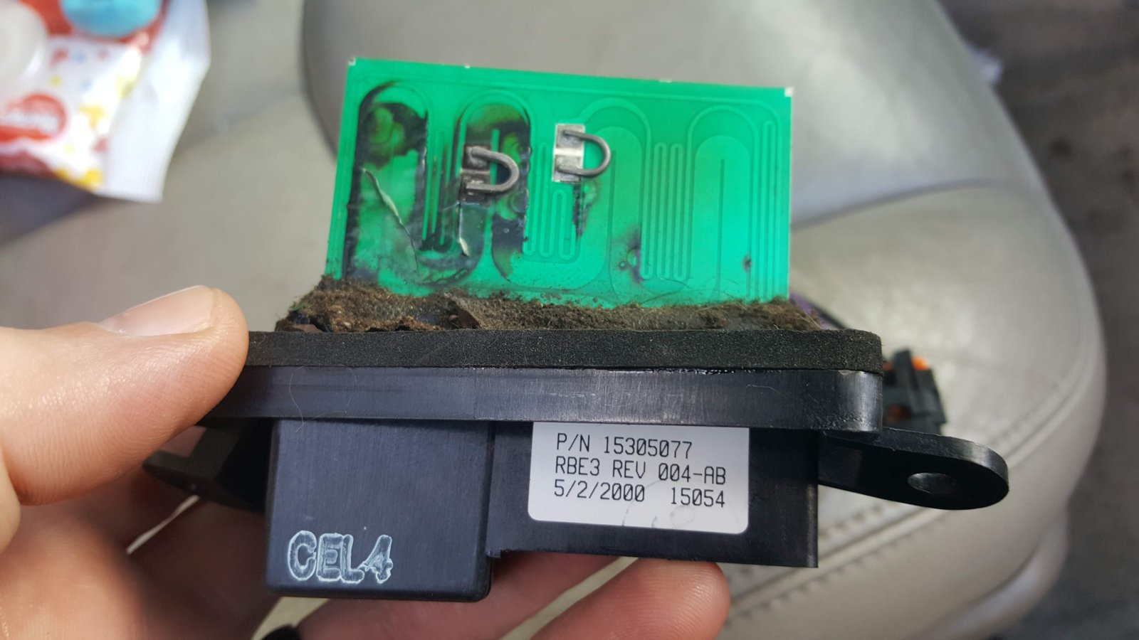

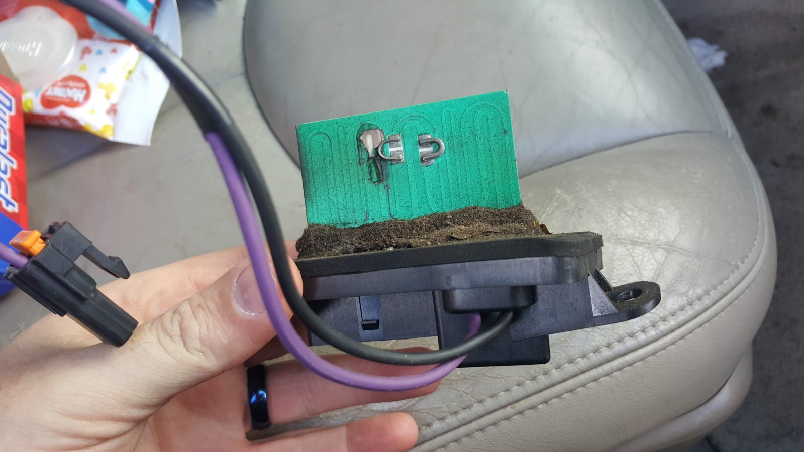

Well, I can knock "blower motor resistor" off the list. Finally got around to replacing it today. The part I pulled out was the original part. 19 years... not a bad lifespan. I doubt I'll get that many years out of the DuraTrash part that I swapped in, but it's good for now.

lol... I don't have any shame in calling it "Hoe"... just caught me off guard with "added to your hoe list" :lol:

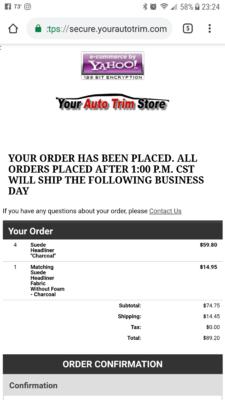

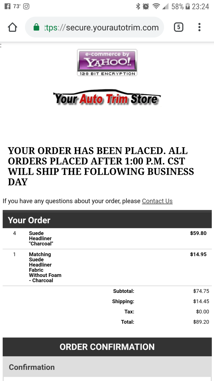

Big news today though, is that I finally got around to ordering headliner material for this beast. No more "curtain valance" dangling in my face when I'm driving down the road, nor headliner drooping on top of my head when I get in.
I'll keep y'all posted on the install. Also ordered a yard of the non foam-backed to cover the dash and a few other trim pieces.
