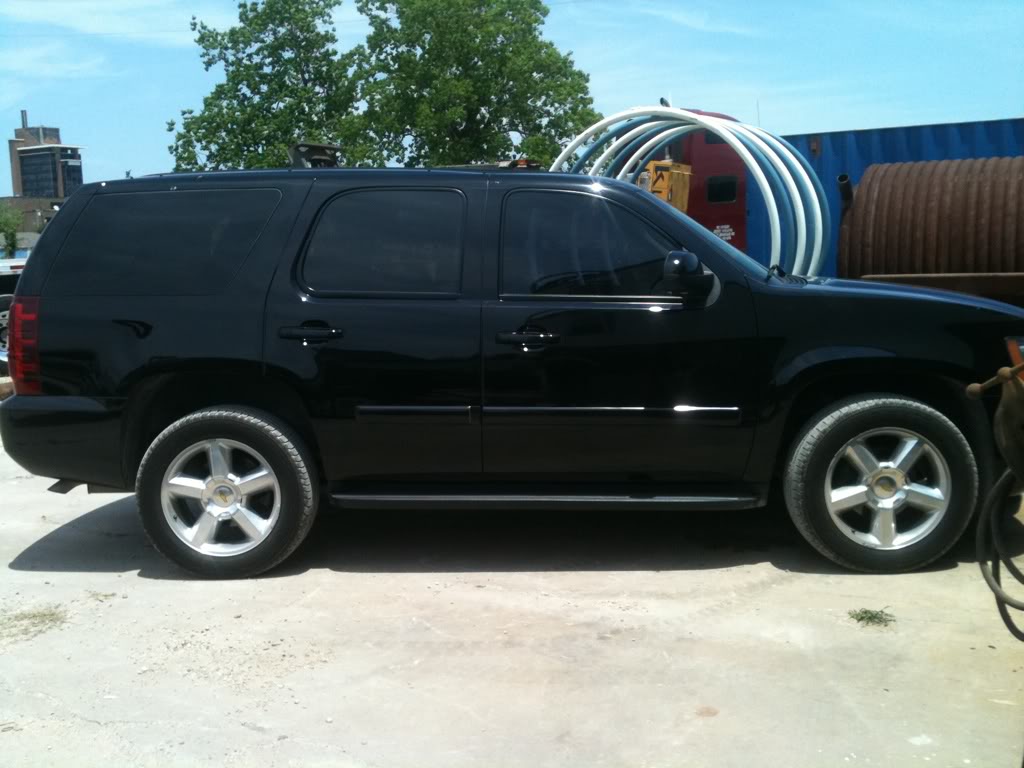

ok before i get a full drop kit is there a way to drop just the rear to level it with the front?? its a LT3 no auto ride with stock 20s

Belltech 23301 is a 2-3" for 00-11 w/o autoride. Comes with 1" spacer and bumpstop, don't need a shock ext for 2". I have a brand new set I can dump for $225 shipped

I don't think you need shock extenders. When I did a buddy's truck we just used these:
http://cgi.ebay.com/ebaymotors/DJM-...r_Truck_Parts_Accessories&hash=item1c164d5d62
$180 is pretty reasonable.
I used the Belltech rear 3"-4" springs, which are said to really be 2.5"-3.5" on autoride trucks. I used the 1" spacer, and I also used the shock extenders. There's little doubt in my mind that the shock extenders DO help, at least by putting the shock in a better position. I think the travel extension is beneficial, too.
You can always try it out without them and then add them later. But I think they're a good addition.
NORCAL SS
SUV SUSPENSION GURU
Jun 9, 2009
8,744
610
autoride shock extenders are needed. if you call belltech up you will be told the same.
if you do not do the 34324 I would do the 5301 springs and buy shock extenders. I really dont like doing the autoride trucks without the shock extenders. Shock angle is much better also with the exenters and without the extenders the truck will keep on trying to lift itself up which in turn will not get the drop you need out of it and the autoride shocks will get killed. I've had a few trucks I've had to fix other shops screw ups when they did the same drop without extenders.
