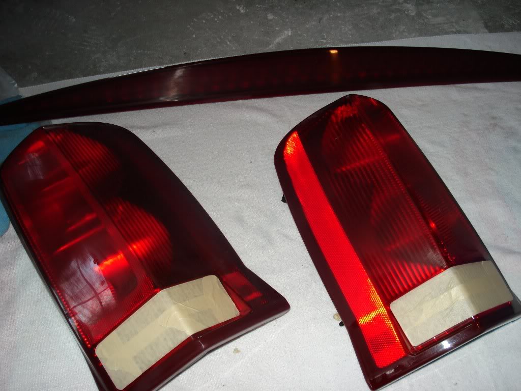

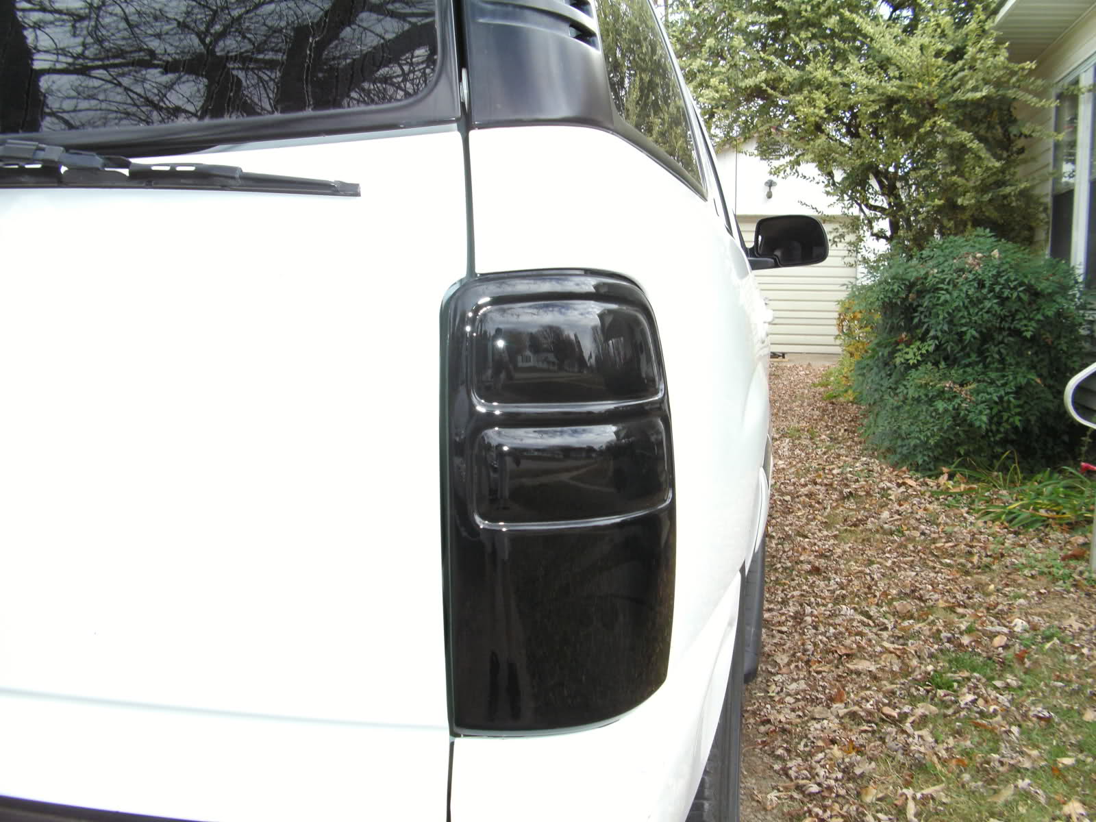

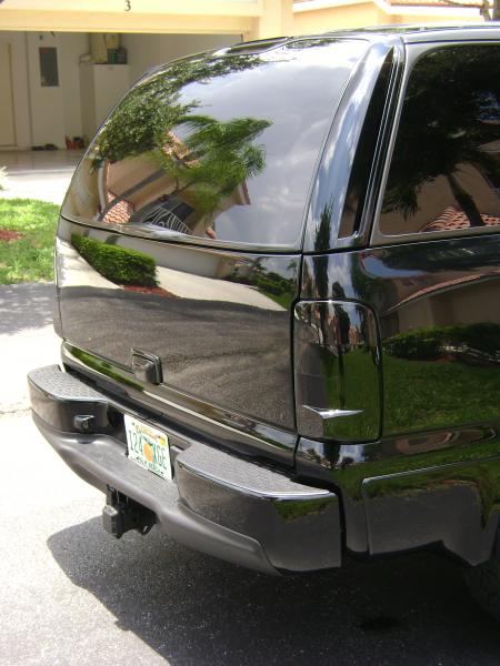

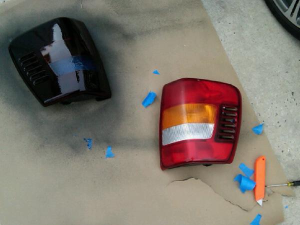

black like this??
Guess what that was done with!
Thats what they originaly looked like. There was way too much on there. Take it easy it's easy to get carried away.

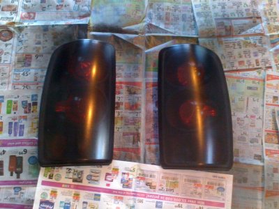

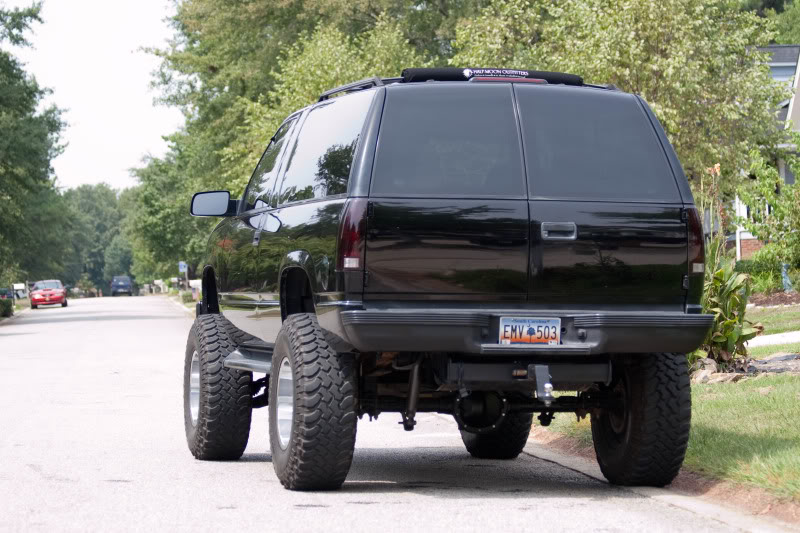

Mine have 5 coats of VHT and 4 coats of clear. We did my buddies today, 3 coats a little thicker and 3 coats of clear.

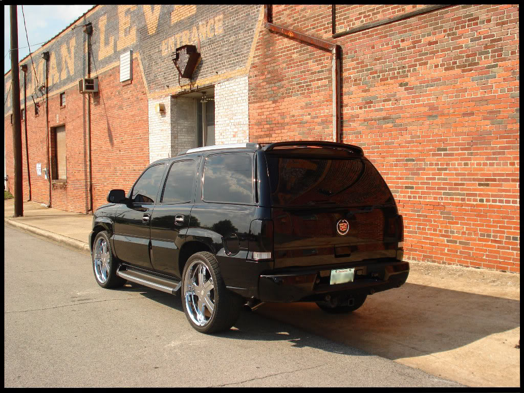

killer...did you clear these out when you lightened them? if so how many coats?

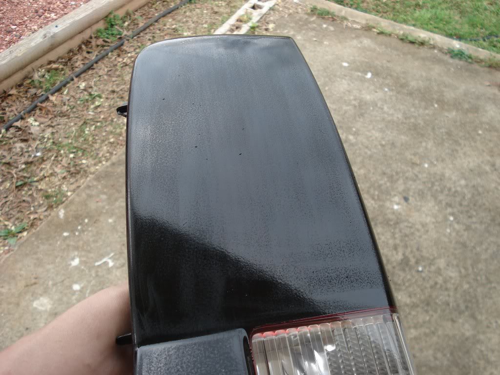

Ya on those they were so black I sanded all of it off. The clear to black ratio was really thin because I was trying to get them like you wanted. The coats were probably around 7-8. So there is alot of clear on those puppys.
When i did mine the first time like in the pic above. That was only 3 coats.

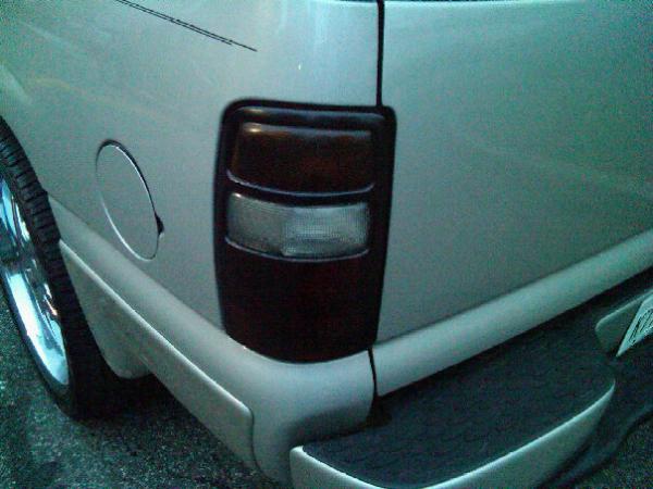

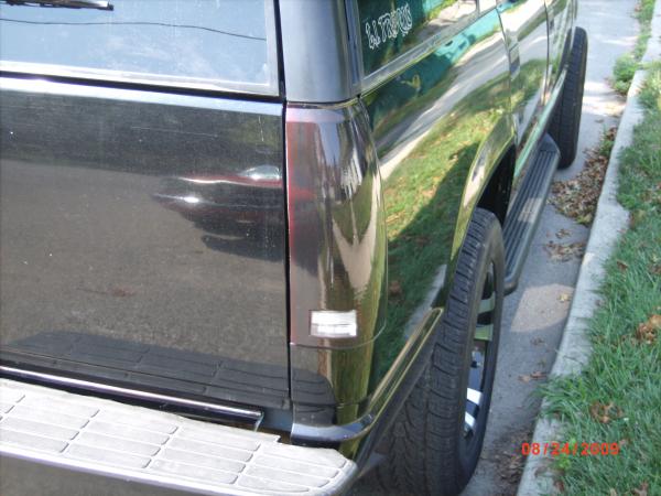

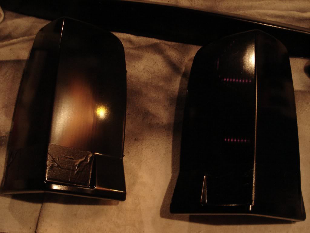

i had a guy do mine at a body shop for $50...
Not sure what kind of paint he used, but did 3 coats of paint and a coat of clear. Nice and black n shiny, but the cops definately arent fans of it...

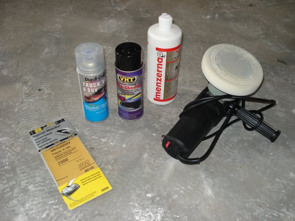

Crazy enough, I've been stopped a few times, but never for the lights...I even got stopped for my tinted license plate cover...but they never said a word about the lights..Anyway...heres the write up I did for the caddy forum almost 2 years ago...
Been wanting to do mine for awhile, but just didnt have the time. I finally ordered the stuff earlier in the week and did it yesterday. The process is very simple and the supplies will cost about 20 dollars total. The total time to complete this is about a day. The total working time is no more than 1 hour. The longest process is letting the paint dry.
This is what you will need.
VHT Nite Shades Spray Tint. (I ordered mine from Summit Racing)
Clear Coat. (I used duplicolor)
Masking Tape. (Assuming you want to keep your reverse lense clear)
2000 grit Wet sand paper.
Small razor blade.
Rubbing alcohol
Microfiber towels
Some of the supplies
You will also need some sort of rubbing compound to remove swirls and lights scratches. A buffer would also make this job much easier than by hand. I already have this because I like to detail my truck alot.

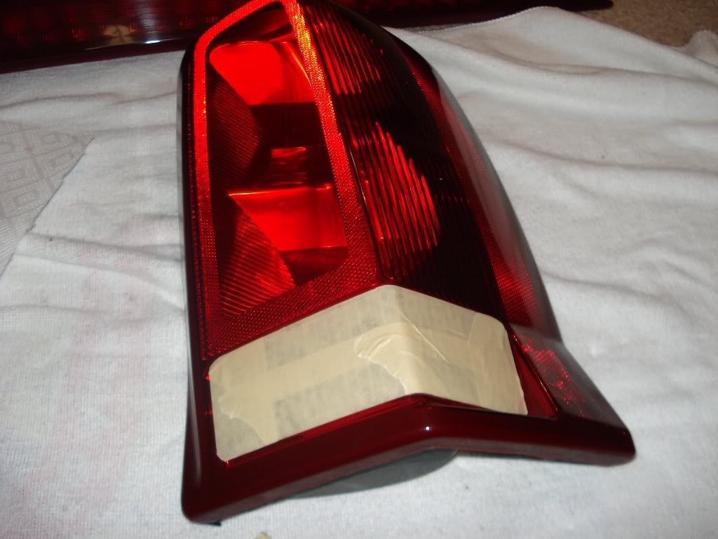

Anyway on to the process. Start by remove the tail lights. To do this you have to open the rear door and there is 2 screws that hold the lights in. Undo these 2 screws for each light and the lights come right now.. Take out the bulbs and your done.
The first thing I did was tape up the lights with the masking tape. After you tape it up, carefully cut the excess out where the tape fits the perfect shape of the reverse light.
After that take your wet sandpaper and sand over the entire light. Make sure to keep the paper wet by dipping it back in a water bucket often. Once you're done, your lights should appear slightly hazy...this process should takeno more than 5 minutes to do both lights. I know its kinda hard to tell in the pic since it was dark when I took this pic.
Once you have wet sanded both lights make sure they are completely dry, and take your rubbing alcohol and give them a good wipe down. This ensures that they are free of dust, grime and fingerprints.
The Next process is taking the Spray on tint, and painting them. I went fairly light just enough to coat them for each coat. Depending on how dark you want to go should tell you how many coats to put on. I did my taillights, and top brake light and did a total of 3 coats and used 1 full can and mine are very dark. I waited about 45 minutes in between each coat of tint. Use your own judgment. Heres a picture after the paint.
After the last coat of tint, I let them dry for about 5 hours. After that its time to wet sand again. Just the same as before keep the paper wet and sand it until the whole light is very hazy looking. Again this should take no more than 5 minutes.. After that I went ahead and peeled off the masking tape and dryed all the water off. This is what you should have now.
Now that we are done with the tint..its time to put the clear on them to protect them. I went fairly heavy on the clear. I wanted to make sure they were protected very well. Once again I waited about 30-45 minutes in between the clear coats. I did a total of 3 HEAVY coats, but not so heavy where it would not cause the paint to run. After That I let them dry over night.
This morning I went out to get them. The first thing you want to do now is lightly wet sand them again now that the clear coat is on. Once again they are going to appear slightly hazy. This is to smooth them out, and get any dust that may have settled into the paint. The process is the same as before.
After that you will want to take your rubbing compound or polish and buff them to a brilliant shine. Having a buffer will make this process take about 3-4 minutes per light. I would imagine the process will take A LOT longer doing it by hand. And here is the finished product.
After you have buffed them back to a shine, you will want to put a couple coats of your favorite wax on there to protect them, and then bolt them back up and heres teh finished product

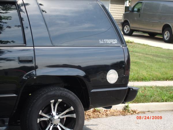

3 krylon gloss black ,wet sand,1 coat high gloss clear , wetsand lightly, last coat high gloss clear

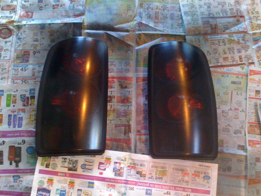

Doing mine today
In the kitchen as we speak I'm doing mine.
Already given them 3 coats and they are quite dark and I dont think I'm going completely black.
Just waiting for them to dry before I wet sand and apply the clear coat.
Will post pics when I'm done.
JD

How'd they turn out??? Any pics yet???

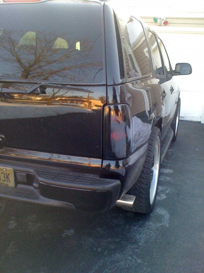

Gave them the last coat about 2 hours ago so waiting for them to dry. Then will wet sand and start clear coating them
This pic was after 3 coats. But added about 2 more coats since.

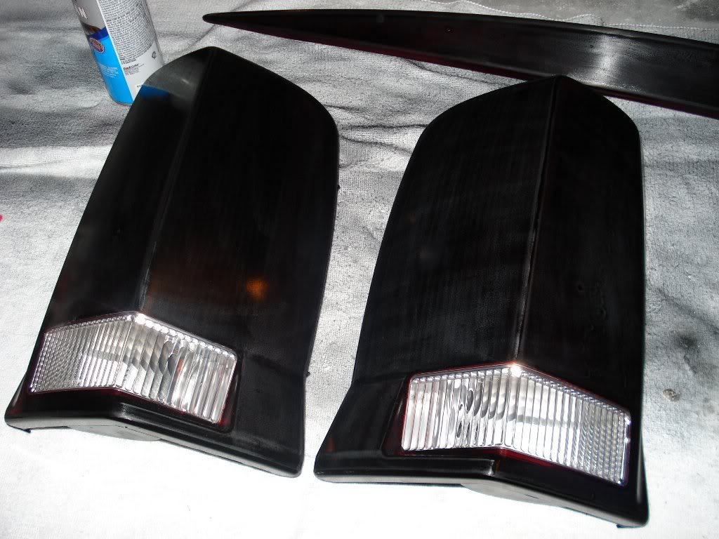

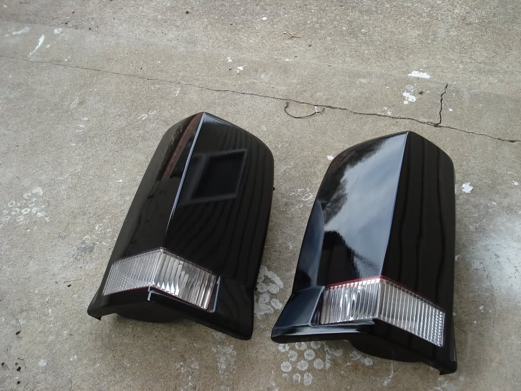

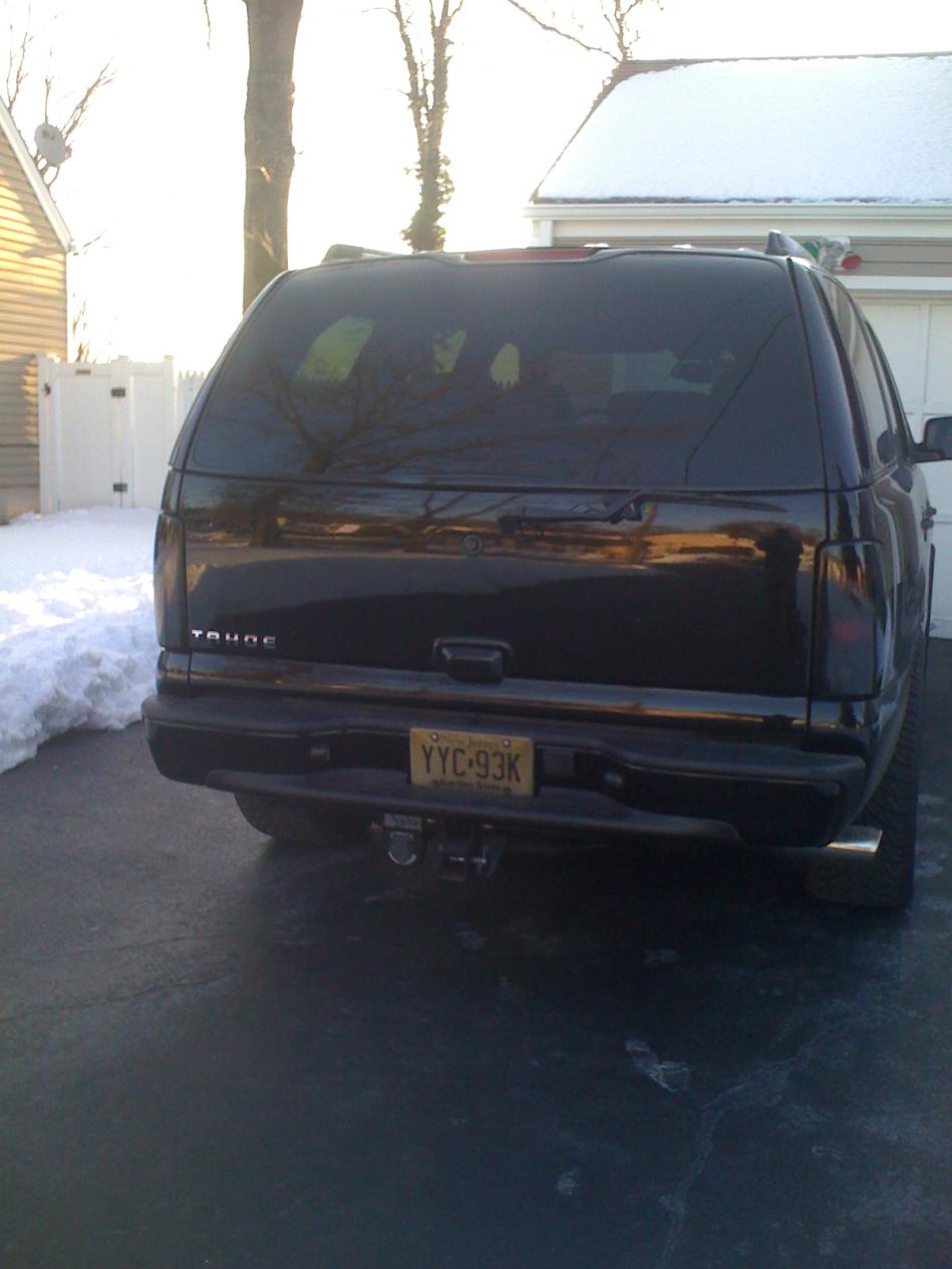

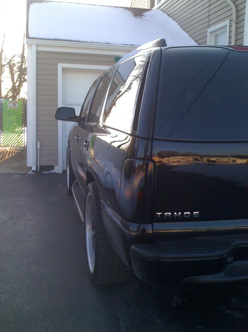

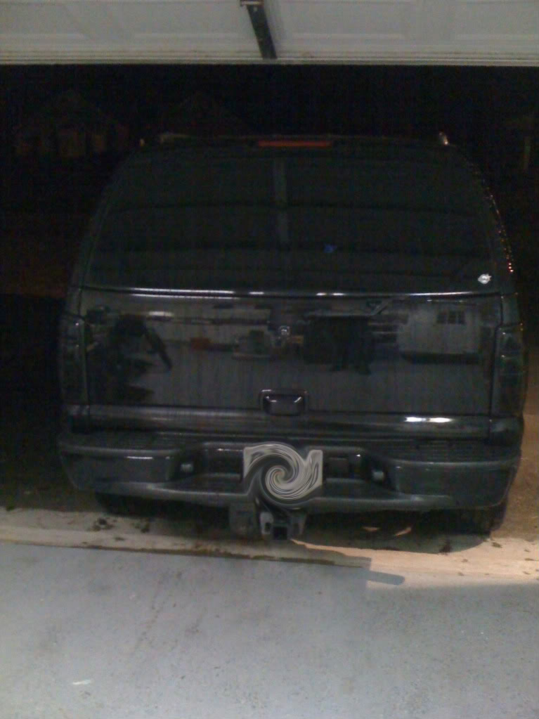

Ok here they are
I didnt go completely black but very close
